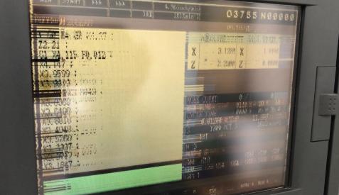

    CL-153 with screen issues
    The machine is a CL-153 with the MSG-803 MAPPS interface. The screen is starting to act up; intermittently changing colors, glitchy, etc.
    The problem has been getting worse with time, to the point now that I can barely make out the text/numbers.
    Is there a simple plug n play replacement? or possibly a driver issue??
    Any thoughts would be greatly appreciated, I have a stack of material to run! lol
    Thanks,
    Todd

    Here's a screen shot of what it's doing.
    Thanks,
    Todd

    Attached is the image from post #2 that earlier didn't upload properly to CNCZone:

    Update on the MAPPS issues:
    Had a Mori rebuilder test the MAPPS module (out of the machine), and it's looking more and more like a dying/dead mother board. Seems that the only hope would be to find a good working used module, or lay down the cash for a new one from DMG Mori.
    DMG Mori has been literally zero help for over a week now, so the options are running thin.
    What about a retrofit? Anyone have any experience with a Mori CL retrofit?
    Thoughts??

    there are 2 cases issuing,
    1. LCD screen is damaged or
    2. OS/2 graphic module has been faulty.
