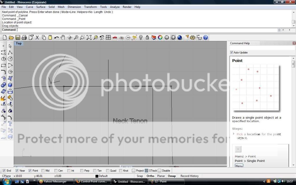

    I am just starting to learn CAD and I need to trace a guitar body perimeter with the best curve continuity possible.
    This is what I did and someone said that it doesn't look right
    I was tracing a body shape with the freeform> interpolated points curve option on Rhino. However this person suggested I should use control points to form the shape like this:
    and that the blue cutaway curve must have at least G1 curvature continuity, preferably G2, with the neck curve
    However I find that the control point curve option is too hard to use and I need some advice on this subject

    The 2nd picture is not my work. I've tried importing the image as a background image but the image became too blury for my liking. The guy who made the 2nd picture models guitars for a living so that is why it is 'excellent'.
    So could I achieve a nice smooth curve like this using the interpolated points curve option - particularly at the horn and at the cutaway? I would like to avoid the control point curve option as much as possible.
    Since posting this I've had an idea. The first picture is my attempt, and u can see that the continuity is probably G0 with the straight neck pocket bit.
    I'll show u exactly what I've decided to do to achive the basic guitar body model so u can help me
    First I import the body plan I wish to trace. Note the outline of this guitar cannot be used as it is discontinous and thus it must be traced.
    For reference this plan is known as the John Catto plan ( I deleted of some of the headstock stuff and the inlay outlines)
    I then place two points at the ends of the straight part of the neck and join them with a line
    I then place a point nearby the line
    I then draw my curve using the interpolated curve option, and using the nearby option to help me trace. This curve joins the other side of the straight line where it make a 90 degrees angle to it. I also delete the original curve so I can see what I am doing

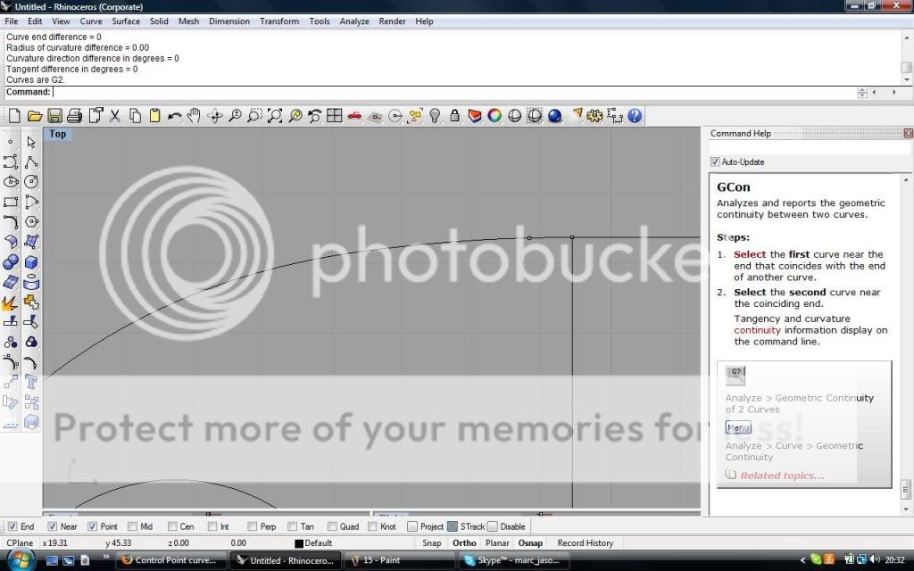

    I then use the blend function to blend this curve into the line
    I have G2 at this point

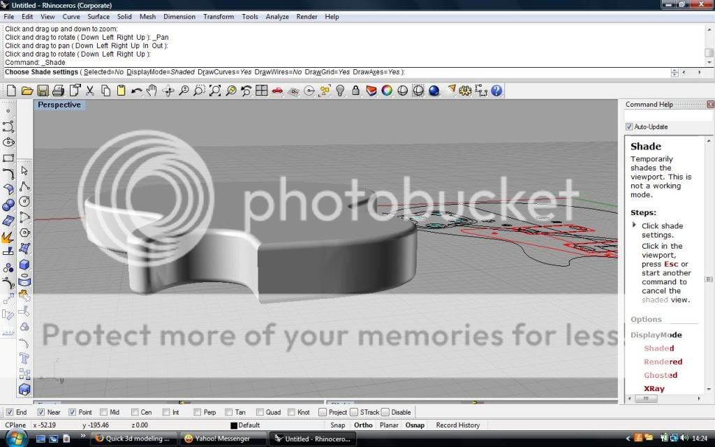

    Here is a zoomed out pic
    Will it be ok for the rest of the steps now?

    Start rough and refine. If you turn on edit points instead of control points you can drag the endpoint of a curve/line to a new location. Repositioning control points smoothly changes the section of curve under its influence. Repositioning an edit point changes the point the curve goes through which makes it more difficult to do smoothly. A blend makes a new curve. Use match when you want to adjust the continuity of one curve to another. Blendcrv lets you have different continuity on one end than the other which sometimes is needed.
    What you did is probably fine but not sure what you are trying to do. The rule is always inspect. Your first posted extrusion has what looks like ripples or distortion in the sides surfaces. Get to know the analysis commands. You can have a window set to render mode (right click the title like perspective and choose rendered). Different colors and lighting (layer manager materials and reflectivity) help to reveal surface quality too. If it looks funny change the geometry and try again.
