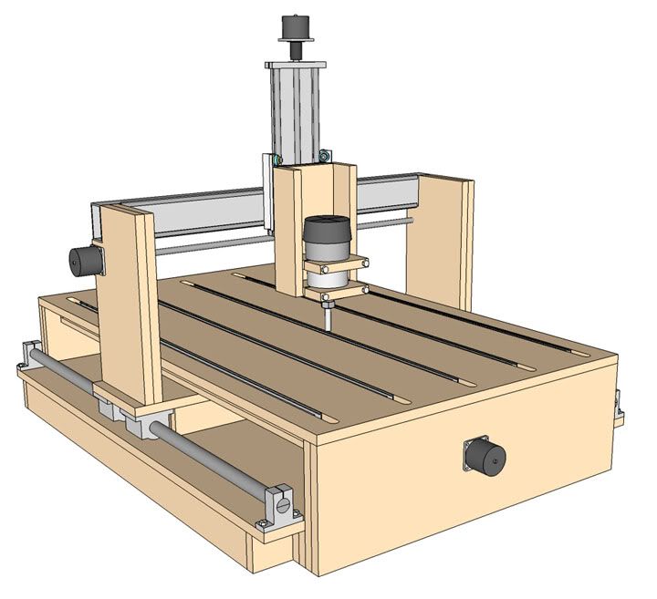

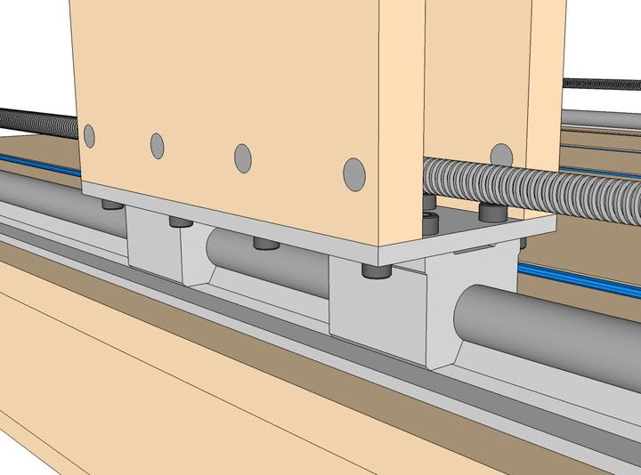

    Greetings all. This is my first post, though I have been lurking on this forum for awhile admiring all of the CNC builds. A truly impressive variety of creative solutions to CNC!
    I am undertaking the design of my first DIY CNC Router. Though this is my first router project, I do have a lot of machinist experience and I have built a fair number of motion control rigs over the years for film and TV work. My goal is to build a medium size, bench top machine that will fit within a 3 foot by 4 foot area (size restrictions in my shop). I already have some linear motion components lying around from old motion control projects so I will integrate those the best way possible.

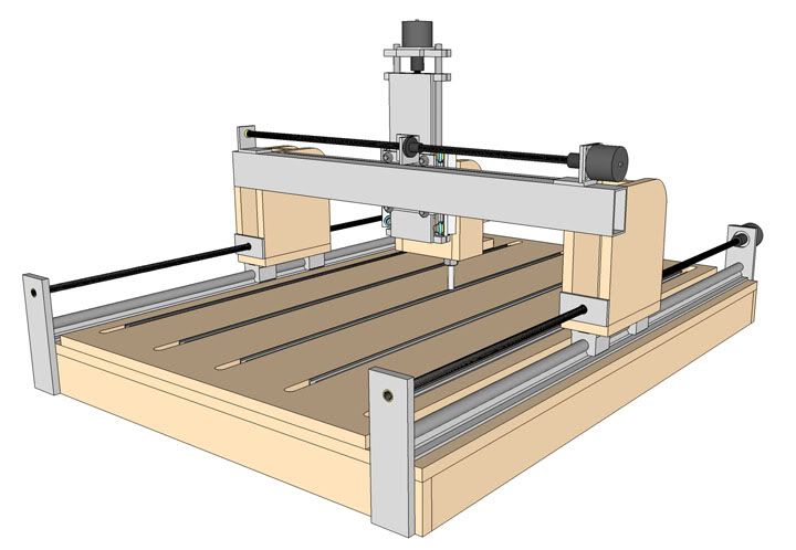

    My biggest indecision is whether to go with a spanning torsion table design, like the JGRO or a simpler design where there is no connection between the Y axis linear bearings. Attached are two designs I've worked out (they are still works in progress, there are a lot of missing details, like motor brackets). The first is based on the JGRO, modified to fit my space and using the linear components I have on hand. The second is the non-spanning table design.
    My biggest question is this, am I likely to run into problems trying to drive the Y axis on the second design from only one side? I'll be using 1 inch precision linear rails and bearings. Are gantries built with these as prone to wracking problems as V bearing designs? I suppose I could put drive screws on each side and connect them with a belt but that's a lot of work.
    Any advice on the pros and cons of each option would be much appreciated!

    You are buying yourself a lot of grief if you try to move the carriage from only one side. It will tend to bind when moving in both directions. If by some chance the carriage does not bind (say the bearings are spaced far enough apart), you will definately skew the carriage enough that you will always have the non-driven side lagging behind the driven side. Center driven is best though you could always drive both sides as in a master slave arrangement. Hope this helps.

    Some suggestions from me,
    X axis using unsupported ways, I highly suggest you use supported ways, I made that mistake on my machine and its greatly limited my speed and cutting capacity, I am constantly fighting the flexing shaft, it will flex! I am kicking myself for not using supported rod or rails.
    I like the design of the non spanning table design, the other one you will have problems with the table sagging.

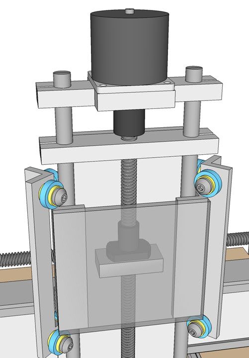

    Your Z axis is much too tall, its going to be a huge lever and will flex alot. I suggest you redesign your Z, make it as compact as possible, the majority of tooling only coming in a max 2" cutting depth, so really you only need 4-6" of travel depending on what you want to cut.
    I cant clearly see how your Y/Z carriage works, any better angles?
    Dont drive your X axis from only one side, it will rack, use a dual drive system or a center drive. Using two motors for an X would be ideal IMO.
    As for the Y, it may work from one side, but I would try to center it, I have my Y leadscrew closer to my bottom bearing but still in between the two.
    Try to widen the Y bearing spacing, the grey rectangle that spans the Y axis, make it wider.

    Thanks for the initial advice guys. The more I look around, the more I like the idea of the non-spanning table design, even if it means driving it from both sides, either by using dual motors, or a timing belt.

    Dual motors driving the x are better than a single center motor imo. The single center motor will be slewed by the router cutting anywhere but in the center. You will also get slewing when you rapid if the router is not centered. These forces are usually more manageable than if you drive the gantry from only one side, but they're still there. If you drive the gantry from both sides you have a much more rigid system. The only time you have a problem is if you stall one stepper motor but not the other, but due to having two motors pushing, this is probably less likely than stalling a single motor with the other designs which would also cause problems. It's also really helpful to set up dual home switches so you can square your gantry while homing.

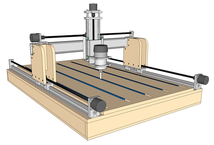

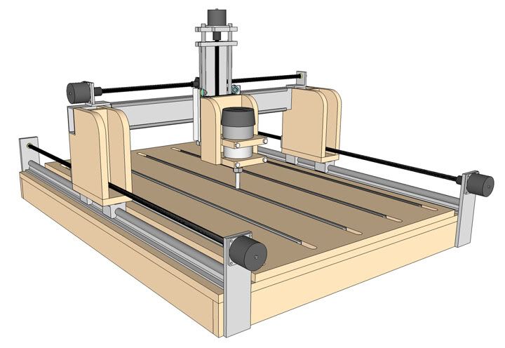

    Again thanks for all the input guys! I've decided to go with the a non-spanning table design and drive the gantry from both sides, either with dual slaved motors or a timing belt/chain connecting the lead screws. Here are a couple of views of the revised design. Based on the input here, I've shelved the idea of using the un-supported linear rail I had lying around for the X axis and instead have bought some fully supported rail and pillow blocks on EBay.

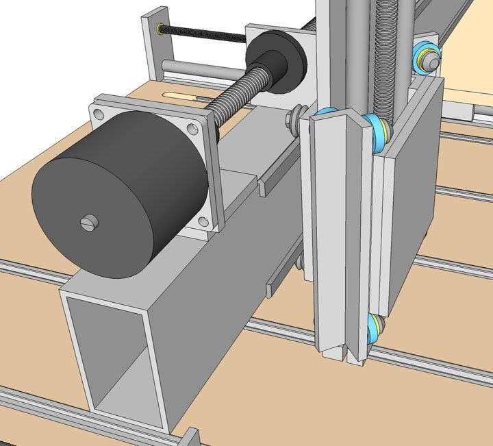

    Based on the advice here I've also shortened the Z axis and lowered the Y axis. The stepper motor and lead screw for the Y axis have been moved to the top and now attach directly to the Y axis rather than the MDF gantry legs.
    The Y axis is made from Dual-Vee components on 2" x 4" rectangular aluminum tubing. I'd like more distance between the rails, but this unit is something I've already got lying around, and it's pretty solidly built so I'm hoping the Z axis won't wrack on it from the off balance of the router. If it's a problems, I can always try to counter balance the router with some weight off the backside. Here's a rendering with some of the components hidden that shows the Y axis a little better.
    The Z axis is another pre-existing mover from old projects. It uses skateboard bearings riding along the outside of 1/2" rails. It's also pretty solid and should work well. The 3D model doesn't show all of the nuts and bolts that hold it all together and hold the bearings in compression against the rails.
    I'm planning to uses 1/2" acme precision threaded rod with anit-backlash nuts to drive all three axises.

    Further design refinements.
    I changed the material for the plate to which the X axis bearing attach from MDF to aluminum. It will be easier to accurately drill the mounting holes in aluminum. The mounts for the X axis lead screw are now attached to the linear rails for alignment rather than the table. But I'm not sure if this is a good idea or not.
    The length of the X axis has increased from 48" to 55" since that's the length of the supported linear rails I just purchased on EBay and I just can't bring myself to cut them down. So now I have to find another spot for the machine in my shop!
    And the router mount has been changed to an aluminum one from K2. (Oh, and the T-Tracks in the table are now blue... 'cuz that's the color the Rockler ones are!)

    The lead screw can take some slight misalignment so having precise alignment there is really not needed, how do you plan to attach the motor/screw mount to the supported rod?
    Are you planning on a torsion box for the machine base and then attach the t-slot table to that?
    I'd try and see if you could make the entire upper section of the machine from Aluminum. You already have it mostly metal so why not see about getting the X axis uprights made from 1/2" or better 3/4" aluminum plate? It would make the whole thing a lot stronger and would be easier to attach things my drilling and tapping threads.

    The plan for mounting the X axis lead screw steppers was to machine it's mounting block with a 20mm bore to match the linear rail, slide it on the end and secure with a clamping screw. But this may change since I'm thinking of mounting the acme lead screw with bearings, rather than bushings.
    Yes, the machine base will be a torsion box and the T-Slot table (or other replaceable cutting surface) will screw down onto it.
    I though about going ahead and making the gantry uprights our of aluminum, but I think for now, I'll use MDF. Then later, once I know that all the dimensions are good, I can replace them with aluminum.

    Nice work, and the drawings are excellent. You have got a lot of great parts spec'ed out for this machine, the less MDF you use, the more resilient your end result.
