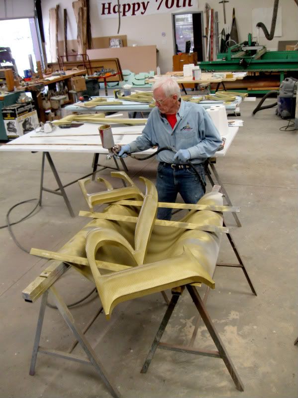

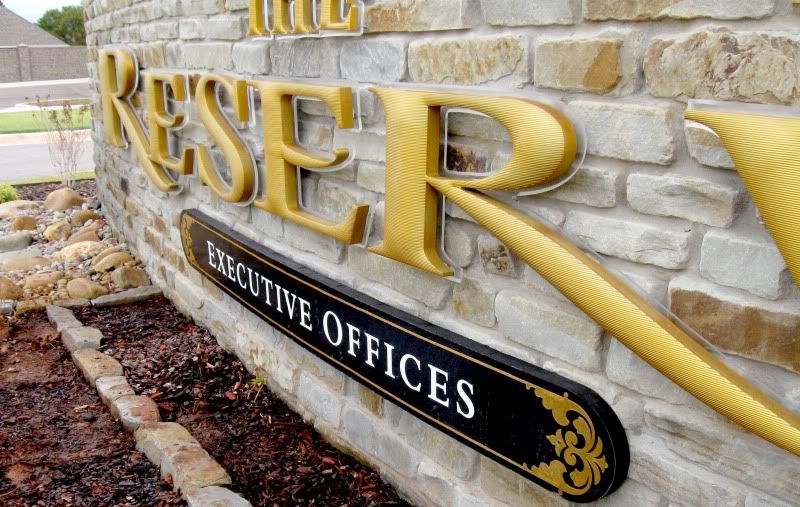

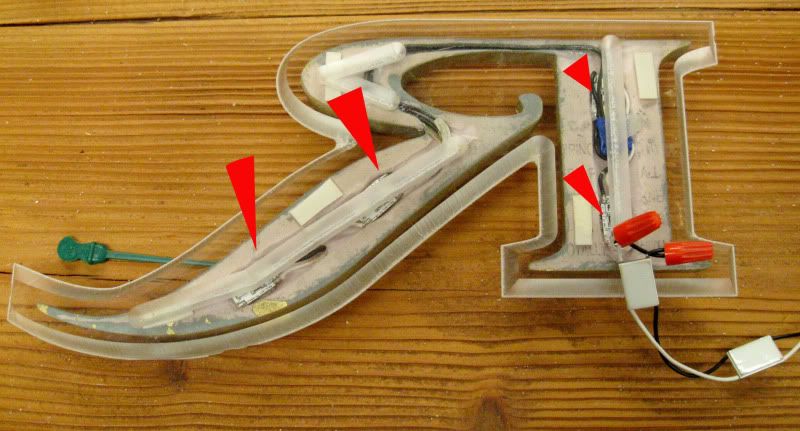

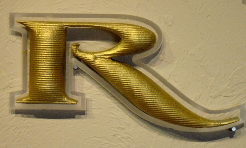

    One of our clients wanted letters with backlighting. The idea was to have the lights wash on the background. The problem was a background of medium dark rock. The solution was beveled 1/2” plex with LEDs placed in groves down in the plex
    This was a fun project with my assistant, Ron Mitchell.
    Joe Crumley
    www.normansignco.com

    One note about the ribbed texture. That was an easy technique. I used the max step-over using a 1/4" ball nose bit. There are lots of creative looks which can be made using other bits.
    Joe Crumley
