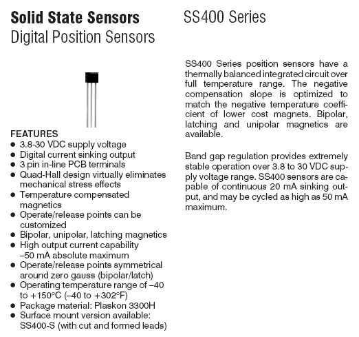

    Hall Effect Switches.
    I chose the Honeywell SS441 sensor as it seems common enough and has some decent features. There is also a SS541 sensor, that seems to be the same device but in a surface mount package that requires a special PCB.
    The SS441 is probably easier to use for most people as it has legs that are more easily soldered.
    There are a few sensors in the range. The SS441 is "unipolar" meaning it just needs the presense of a magnetic field to operate. The "bipolar" sensors can detect if a magnetic field is North or South, which is not needed for limit switches.
    The SS441 is suited for lower strength magnets, and is temperature compensated. It's temperature compensation matches that of lower strength (older style) magnets.
    My initial testing showed that the new super magnets give a greater sensing distance from magnet to sensor, but this seems to reduce sensitivity as we need to detect a close precise distance. So unless testing proves otherwise it seems that older style low-power magnets are the best for this application.

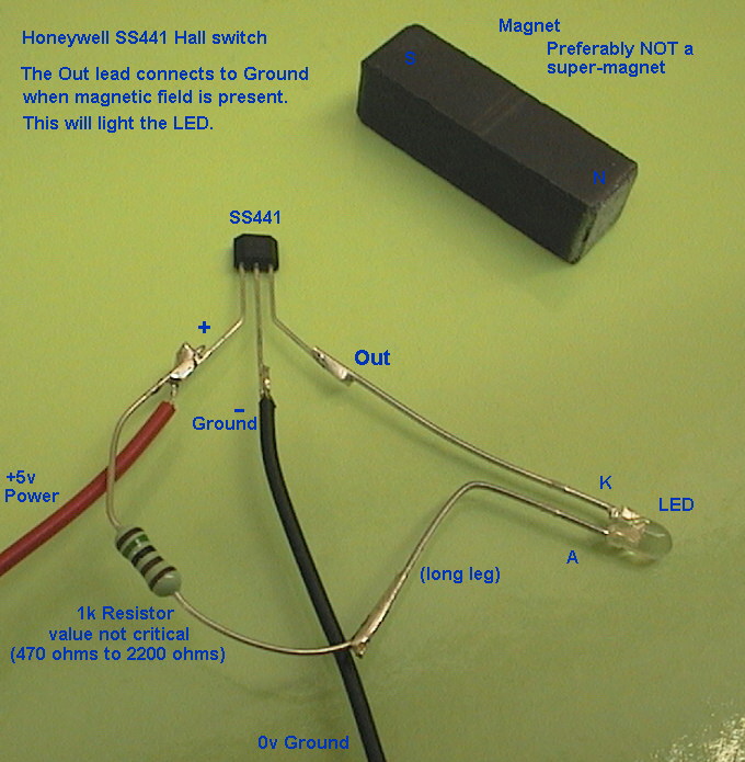

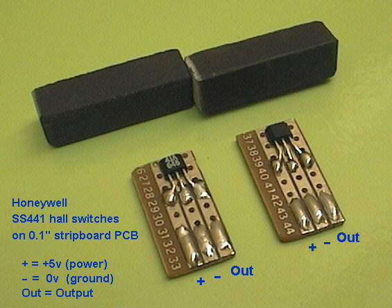

    How to test the sensor.
    The SS441 and SS541 have 3 legs;
    + (+5v power)
    - (0v ground)
    O (Output)
    The datasheet says 4v to 30v is ok for power, but I used +5v regulated as that is available on my CNC machine (and most machines) and using regulated voltage for the power eliminates one variable that might affect the sensing characteristics.
    The easiest way to understand these sensors is to see the output like a switch to ground, whenever the magnet is present.
    This is a very simple test rig that only needs a resistor and a LED. When the magnet is present the Output leg switches to ground and the LED lights up. The test rig took about 30 seconds to make, and was powered from +5v and ground via the Red and Black wires.
    Test rig results
    This worked well. I used a 1.5k (1500 ohm) resistor and a high brightness LED but the resistor value is not critical nor is the type of LED.
    The sensing surface of the SS441 is the front (or back) face. When a magnetic South field is present near the front face it switches on (Output connects to ground). Likewise it switches on the same if a North field is near the back face of the device.
    The front face has the writing and sloped sides. The back face is flat.
    I tested a few magnet types and settled on 2 small bar magnets that operated the sensor from about 5mm (3/16"). Hysteresis was about 3mm (1.8") or less.
    Hysteresis means that once the sensor turns on, the magnet must be withdrawn a certain distance for it to switch off again.
    Using a lower strength magnet means the magnet must be closer to activate the sensor, and the hysteresis is much smaller, and the repeatability of the "on" trigger point is better as this is over a smaller physical distance.

    Mounting the sensors
    If you have the smaller, surface-mount SS541 sensors they will need small PCB made, or some tricky soldering.
    But I deliberately bought the SS441 to allow easy soldering. They can be soldered onto standard 0.1" stripboard ("veroboard" brand or similar) but in a pinch you could just solder the 3 wires to the 3 legs and secure the lot with a blob of epoxy.
    I cut 2 small pieces from 0.1" stripboard, leaving just 3 strips (to solder to 3 legs). The little PCB are about 10mm x 20mm (3/8" x 3/4").
    When bending the legs make sure you bend them out AND down, so only the points at the end of the legs touch the PCB strips. This makes it easier to solder and has less chance of shorting between legs.

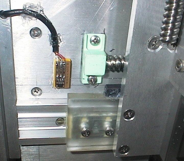

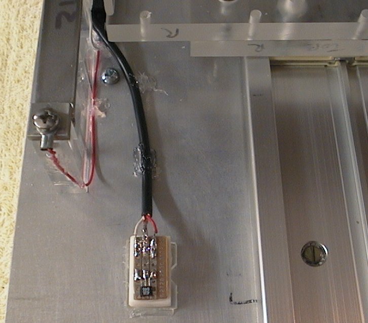

    First tests on the CNC machine
    I glued the little sensor PCBs onto small pieces of plastic using non-acetic (non corrosive) silicone as the glue. This will allow testing but also allows for removal and repositioning if needed.
    For the X axis I glued the magnet onto the moving part and the sensor PCB onto the gantry.
    The end of the magnet just covers the face of the SS441 sensor when at the home position. There is about 2mm gap between. It triggers the sensor when approaching, about 10mm (3/8") before it reaches the home position, about 5mm between the end of the magnet and the edge of the SS441.
    This will allow a safety margin of up to 10mm when moving home just in case it has skipped some steps in either way.
    On the Y axis I glued the magnet onto the moving table, and the sensor PCB to the machine's base plate. The distances are similar to the X axis setup, it triggers the sensor when approaching, about 10mm before reaching home.
    I'll let the silicone glue set a bit overnight and tomorrow I'll write some software to test the repeatability of both sensors with the machine moving home at different speeds.

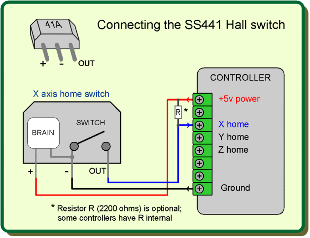

    Connecting the hall switches
    The +5v and ground are supplied from the controller, and the same +5v and ground can connect to all the hall switches on your machine.
    The output from a hall switch is connected back to a "home" or "limit" input on the controller.
    Some controllers have an internal pullup resistor, or you can select an internal pullup resistor. If not, then it is easy enough to connect an external pullup resistor, a value of 2200 ohms (2.2k or 2k2) is fine. Note! It should not cause a problem if you add the resistor when it is not needed, so if in doubt you should add the resistor.
    If anyone has specific info on a controller and how it would connect to these switches please post any info you have! I built my own controller so I am not familiar with all
    the common controllers and their specific setup.

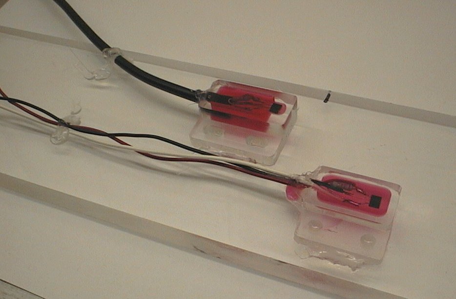

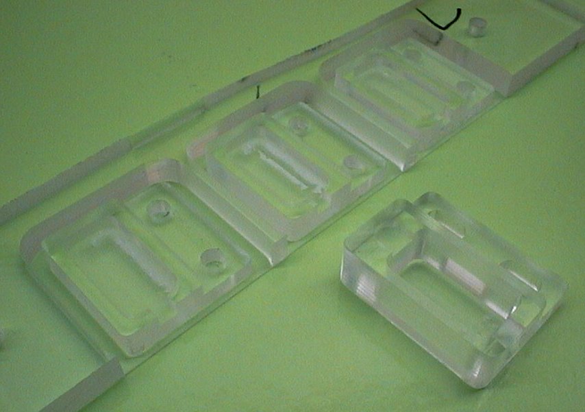

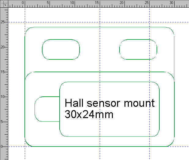

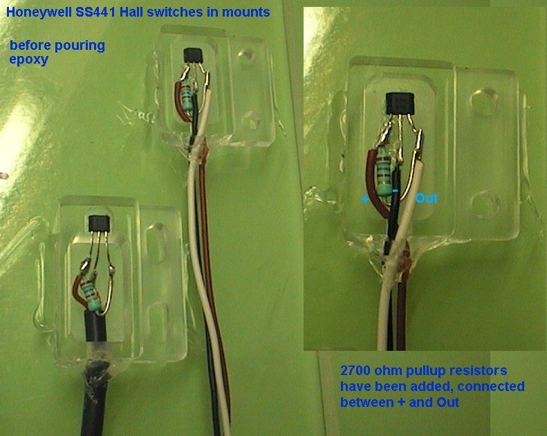

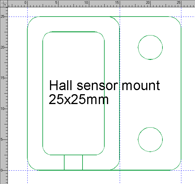

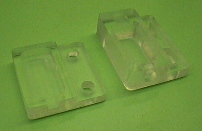

    Making mounts for the hall switches
    I know people don't want to go sticking sensors all over their machines with silicone (like my test setup above!) so this evening I put aside some hours to make some mounts out of clear acrylic (some scrap I had lying around).
    I roughed out some simple designs that can be cut out easily from 10mm (3/8") acrylic and from 6mm (1/4") acrylic.
    This mount above is 10mm, and has a deep pocket to hold the wiring, solder connections etc. There is also a shallow pocket of 2mm depth to hold the hall switch, to it is close to the surface and allows the magnet to come close to the hall switch.
    One drawback is that it needs to have a small hole drilled to insert the wires, and a special height pocket for the hall switch so there are 3 heights to be cut. Another drawback is that it needs more epoxy to fill it, and people using 5-minute araldite would be better with a small pocket that needs less filler.
    Above is my second design, I tried to simplify the mount to the simplest features possible. It is made from 6mm acrylic and only needs one height cut, for the shallow pocket and screw area are both cut about 2.5mm deep.
    It only needs a small amount of filler epoxy, and is more compact in general. The down side is that it is fiddlier to solder the wires because it is smaller and it is not as sturdy as the 10mm mount.
    Above is a (fuzzy) photo of the 2 mounts, on the right the 10mm mount shows the hole drilled for the wires, and the deep pocket for the soldering, and uoi can just see the tiny shallow pocket for the hall switch.
    On the left is the much simpler mount, with just one height cut for the pocket and screw recess. The wires are inserted by the simple slot.

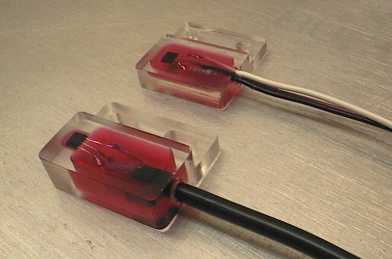

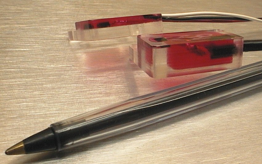

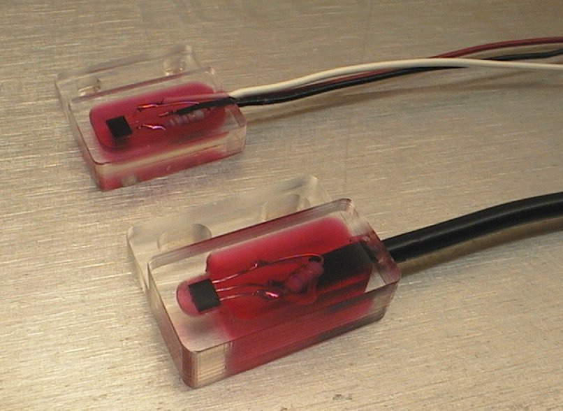

    Below shows that I made 3 of the smaller mount, because these are smaller than the 10mm mount I think they will be better for my small machine.
    Next I soldered the wires to the hall switches and inserted them into the mounts. I added 2700 ohm resistors directly on the hall switches, there is room in the mounts to do this and it means I don't have to add resistors later.
    The hall switches were quickly glued down with a little spot of superglue.
    Then the wires were sealed with a hot melt glue gun so the epoxy won't leak out before it sets! You can also see where i glued the mounts onto a flat piece of plastic to hold them neat and level while pouring the epoxy. I put an extra glue blob on the wires too to hold them steady.
    I used a shielded 2-core cable for the larger mount. This is cheap microphone cable, red+white+copper shield. It's quite tough, very flexible, and the shield is nice to have on longer cable runs.
    On the small mount I used 3 wires, red, black and white. This will only have wires about a foot long so the shielding is not needed and was easier to solder in the confined space of the small pocket.
    The epoxy is setting at the moment, i'll post photos of the finished mounts tomorrow.

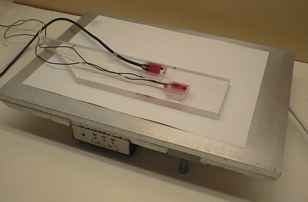

    Prototype mounts are finished!
    I let the epoxy cure for about 14 hours on my hotplate at 45 degrees C.
    The epoxy had a drop of red colour in it to make it more visible in the photos, but only a small drop because I wanted the parts inside to still be visible.
    The mounts were tacked down to a piece of plastic with hot melt glue, this will break straight off later.
    Below you can see the small mount leaked a bit! When I sealed the 3 wires with the hot melt glue it didn't get between the wires, so it slow leaked there. I countered by topping it up a bit more and because the mount was warm (on the hotplate) it hardened up faster than it leaked so it wasn't a big problem.
    The epoxy looks a lighter colour red in the small mount because it is much less thick.
    Below are the 2 finished mounts
    after breaking off the hot melt glue. If you chill the mounts in the fridge for a while the hot melt glue is brittle and breaks off pretty clean. Don't mess with the hot melt glue if it is warm, it just smears everywhere!
    Both mounts are successful and usable.
    Below you can see the large mount with the round drilled hole for the cable was a better result (cleaner, physically stronger, no leaks) than the simple slot used on the small mount. The round cable was better than 3 wires, and the round hole works better than the simple slot.
    The epoxy has nicely filled the tiny void around the cable in the round hole. The cable has no change in flexibility where it exits the mount, so there is no evidence of epoxy being sucked into the cable.
    The last photo below shows the volume of epoxy used. The larger mount used 4 times as much epoxy, and you can see a slight sink in the top surface where the deep pocket of epoxy has contracted as it cured.
    The small mount didn't have this problem because it was very shallow.
    Conclusion
    Both mounts came out good. Apart from the downside of the larger mount being well... larger! it was easier to solder, supports and seals the cable better, mounts the sensor at a known height and is overall more rugged and less likely to break.
    The pocket does not need to be so deep, this was obvious on the small mount which had a 2.7mm deep pocket. So the large mount could just have a shallower pocket than the 8.5mm deep pocket I used here, and this would fix some of it's issues.
    Holding both mounts in my hand, the larger mount feels much better, sturdier, and overall seems like a much better design.
