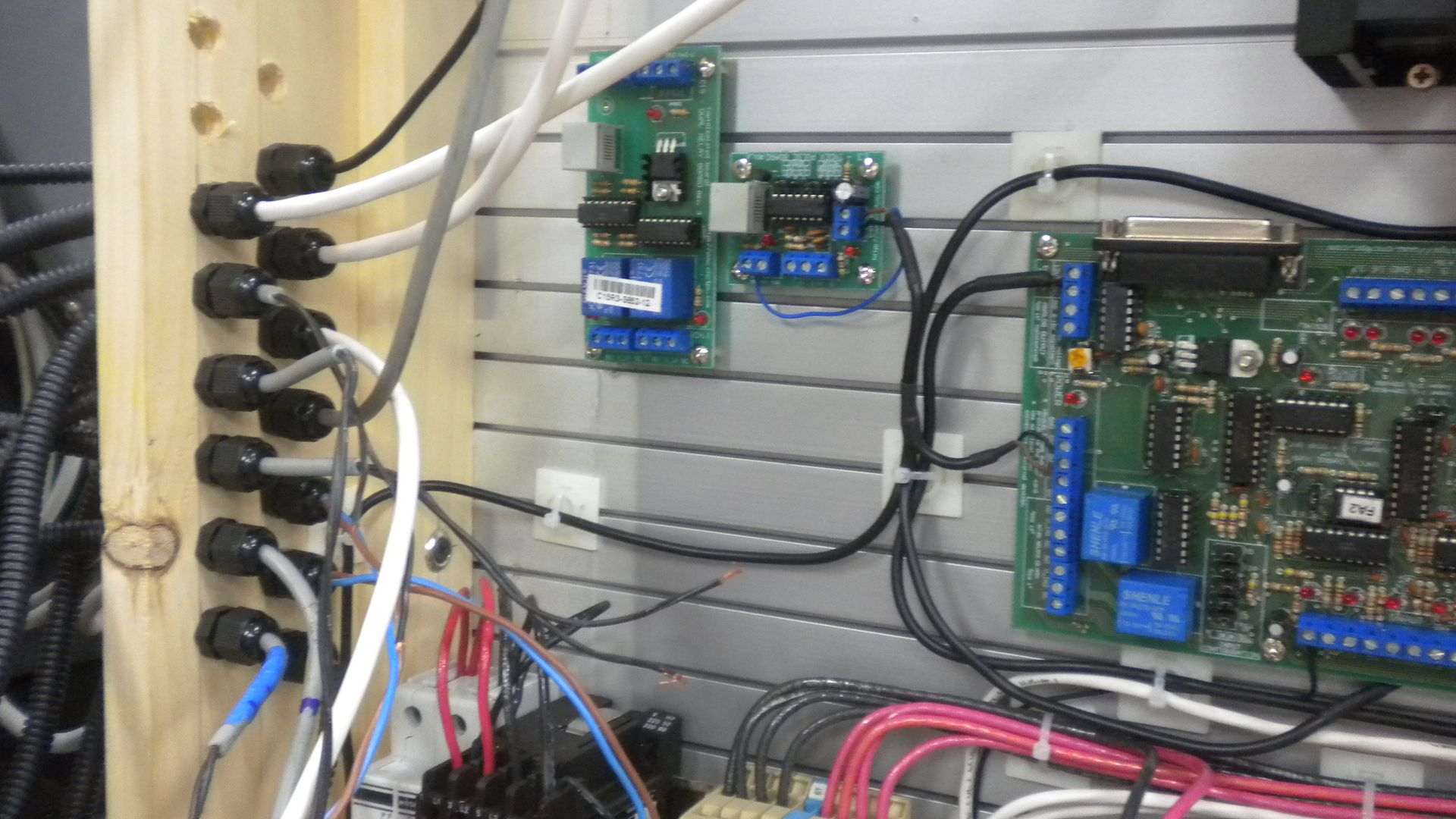

    Now for the control board… it’s still in the building stages, but, you’ll get an idea of what is going on.
    Here is the distribution area. My main 220 volt supply (with breaker and contactor), a 12 volt and a 24 volt supply…and terminal boards…
    Here is a shot of the C3 index pulse card, C15 dual relay board (which will be used for the automatic oiler) and some of the 18 cables that are coming from the lathe…
    The intel itx mother board, C11 board, Keling digital drives and power supply.
