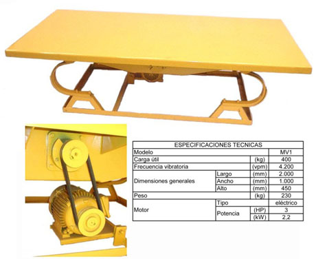

    Thoughts?
    [ame=http://www.youtube.com/watch?v=M8t-xtn-T0s&feature=related]MESAS VIBRATORIAS - YouTube[/ame]

    Hi People,
    It feels like I'm missing something here. That vibrating table which is displayed in the previous post has me beat.
    It cannot be for mixing or blending E/G as a vibrating machine will cause the material on it to segregate. The heavies will go down whilst the lights are pushed up. Not really what we are after when blending and mixing E/G.

    You notice you mention concrete vibrator in your last sentence? That's what the table is for. Drop your mix in the form, it will slowly oogle from a pile to the edge unless you have a runny mix. Runny mix means more epoxy,..
    Back around pg70 is a pretty good discussion on consolidation with vibration. Often used for consolidation of dry concrete mixes:
    [ame=http://www.youtube.com/watch?v=Kilw0pcj3W0]VIBCO Vibrating Table Consolidates Concrete Quickly! - YouTube[/ame]
    [ame=http://www.youtube.com/watch?v=GWImU7CCU8g]How to build a Vibrating table on a budget - YouTube[/ame]
    [ame=http://www.youtube.com/watch?v=gqX5ceWgHxg&feature=related]MESA VIBRATÓRIA - YouTube[/ame]
    And people keep saying the large particles will fall to the bottom while the small will rise to the top,...
    Search the net on "Brazil Nut Effect"
    [ame=http://www.youtube.com/watch?v=bkZJ4S8kY-o&feature=related]Brazil nut effect - YouTube[/ame]
    [ame=http://www.youtube.com/watch?v=lFzbvbGOAAg&feature=related]Phun Paranusseffekt - YouTube[/ame]
    [ame=http://www.youtube.com/watch?v=PGDP5DomhWc&feature=related]Brazil nut effect in a rectangular plate under horizontal vibration - YouTube[/ame]
    [ame=http://www.youtube.com/watch?v=hVDQ5TjO-N8&feature=related]Week1_wholenotequaltosum_brazilnuteffect.AVI - YouTube[/ame]
    So I am somewhat curious as to the impact of the vibration including extended to/through the gel point. Course too much curiosity costs $$. But if I were to take 6 cups of the same mix and lock them down on the table and remove one at different intervals, the results should show if it helps for compaction/air reduction/epoxy reduction or is more trouble than it's worth.
    Plus vibration helps on the front end with sifting of material.
    [ame=http://www.youtube.com/watch?v=SVM_DKOmCS0&feature=related]Kason High Efficiency Vibroscreen Separator - YouTube[/ame]

    Thanks for your explanation "Rocketflier". I guess I was tricked by the scale of your implication. As I now understand it, you are going to be pouring smaller volumes than I have been envisaging. So you would be able to vibrate the complete mould and its contents on a table. In my experiments and the job I will prepare for over winter, I'm pouring much greater volumes and therefore larger masses are involved.
    As a "shot from the hip" my base/stand for the EMCO lathe will be about 0,6m^3 and therefore perhaps 900kg. Just a little too much to put on a vibrator. More a case of bring the vibrator to the job.
    Thanks again for the explanation.

    Thanks for the feedback. The separator would be a bit of a project. Short term would be a simple screen stack on the vibrator table that I could feed material into the top. I'd have to stop and unload sifted material.
    If you look at post #4587 you see 2 tables and an attachment with a photo of some parts. Rather than a vibrating motor (weights attached to either end), the links show tables that have vertical motion vibrators attached to the table run via a belt & pulley to a motor mounted to the table frame. The solid 1" axle followed me home from the scrap yard and included the tire assemblies, bearings and pulley. I've yet to figure out how to remove the tires, but will use them to mount the unbalanced weights (weightbench weights) to the axle.
    I don't quite see how you could cancel the Brazil Nut Effect without impacting the vibration. I also don't believe a short vibration period is going to be detrimental to the mix (much as concrete is quickly vibrated once it's poured).
