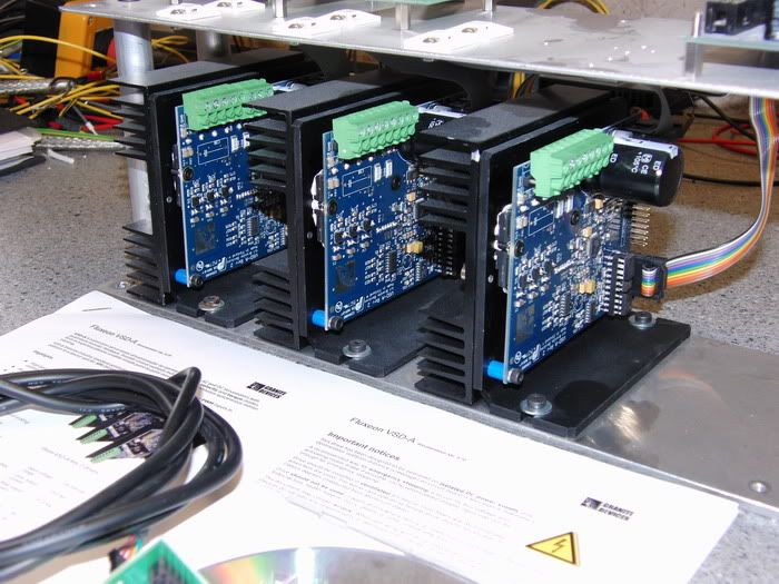

    How hard are these VDS drives to keep cool pushing them at their max?? I am thinking of making drive modules out of them and was just going to put on a aluminum heatsink and a pc fan. How would you keep yours cool?
  8. #8
    Join Date
    Jul 2007
    Posts
    887
    See section 8.5 in the manual for details about cooling requirments or contact Granite Devices.
    Here's how i did my VSD-A's, a simple heatsink mounted to the drive:
    http://i158.photobucket.com/albums/t...ols/VSD-A1.jpg
    The mechanical design of the VSD-E is a bit different though.
