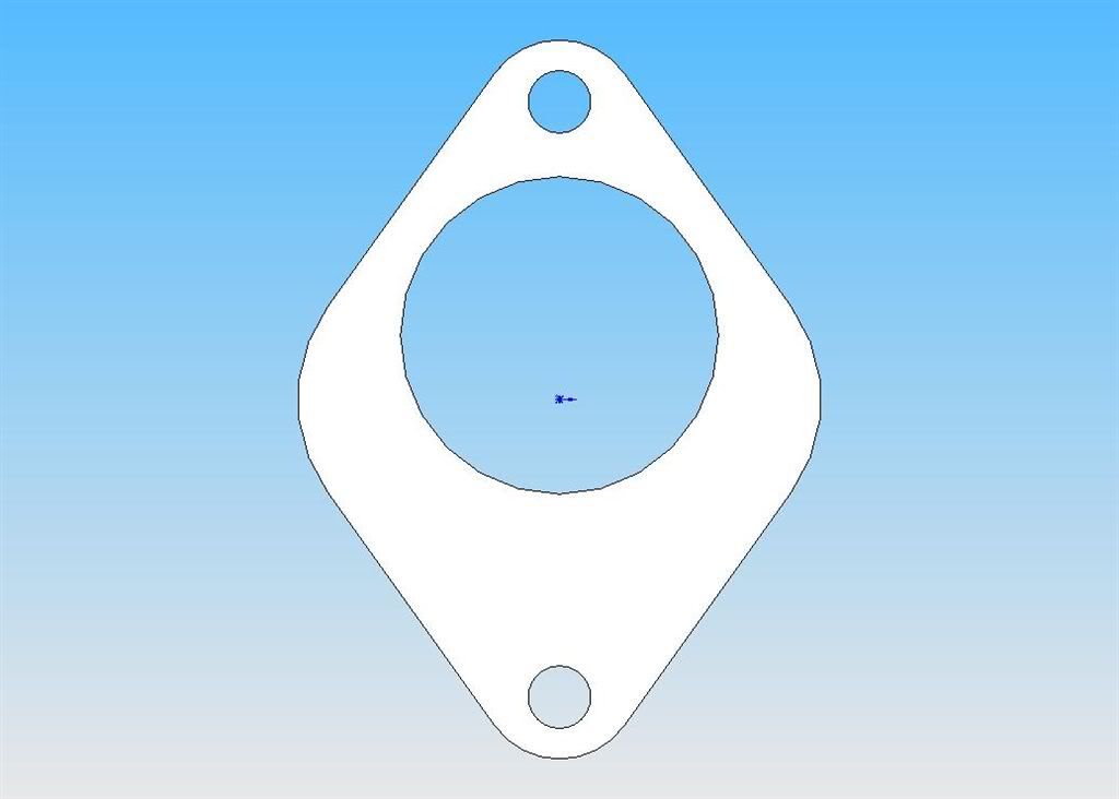

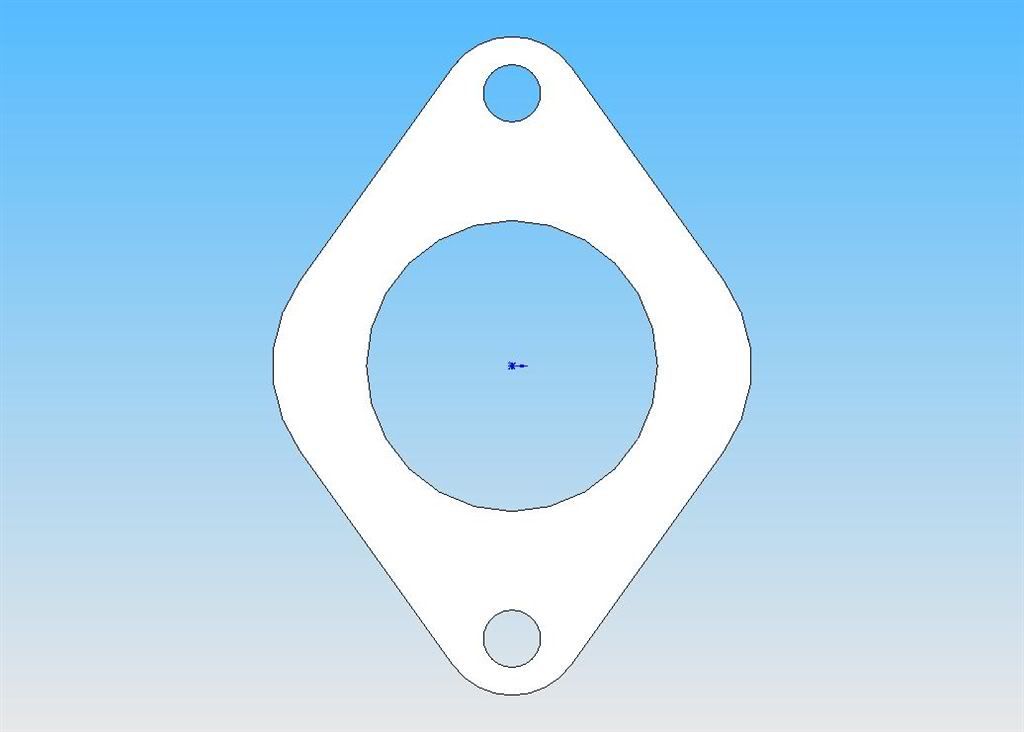

    Hi, i'm new user of mach3 my friend purchased old bridgeport that was already retrofitted, with mach on there.
    What i'm working on is first project, exhaust flange. I made part in solidworks, exproted dxf, used lazycam to make inside and outside offsets and into the mach3. Below are few pictures to explain what i'm doing and what i'm getting. I have only tried cutting outside chain, and big inside circle. Also attaching dxf and g code that i'm getting from lazycam.
    1. What part supposed to look like:
    2. How part looks when its cut:

    i'm cutting with 3/8" end mill, if that mattes(thats what lazycam knows also),so my question is, can anyone help me figure out what is my promlem? Thanks

    Is this machine stepper or servo? It almost looks like steps lost?????

    My guess is that you're losing steps on Y rapids (at least on -ve Y rapids). lower your rapids and see if that sorts it.

    well after the power supply was replaced, i reduced the rapid speed by 15% and cut the part again and it came out just like it was supposed to. Thanks for the help!
