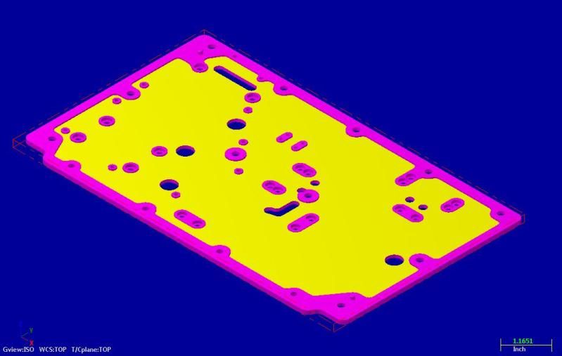

    Whats the best way to go about programming a part like this one?
    I don't have 2D geometry of the part, just the STL. I tried fumbling with the surface roughing, but since it's all flat and vertical, should I just do 2D pocketing? If so, I'll have to generate geometry from the model I guess. Those bosses are all at different heights so I thought a surface op would be faster.
    a newb learning on his own here,
    so thanks for any help

    STL files is only a bunch of small triangles arranged to generate a shape, which Mastercam shades to emulate the appearance of a surface or solid.
    This is NOT an ideal model file to program toolpaths around, it can be done--- with difficulty
    - the better files that are able to create desired geometry from are STEP & IGES ( can import & export from most CAD applications )
    - or of course bring the direct file into Mastercam from the accepted list of CAD systems ( costs may be involved to enable those particular types )

    If you create geometry from the STL and model it using Solids then you can use a Surface High Speed - Horizontal Area finishing toolpath and one-click that whole pocket.

    Ditto - that would be my recommendation! Spending 5 minutes getting a solid you can work with will pay off so that you can use the advanced toolpath choices.
