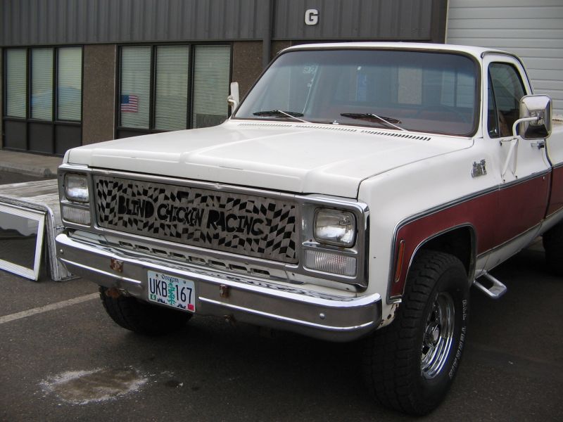

    As for the plasma, I have only ever had one problem with it. What I didn't like was the machine torch (in picture). I upgraded to a Thermal Dynamics one-torch and you wouldn't believe the improvement. I also did a major upgrade on all the guides on the machine to make it track straight. The pic below shows the new machine tracks and a grill for my pickup I made afterwards. I did not have near the control before the upgrade to make something like that.

    ok, that does redeem you just a tad...
    I was actually considering a thermal dynamics machine. It's around the same price.
    I can see why you upgraded if you didn't have that control before, makes perfect sense.
