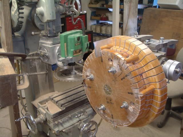

    The main limit on part size is the type of work and your ingenuity.
    I lifted this photo from a current thread on the Practical Machinist forum.
    Phil
    photo by Robert Campbell Jr
