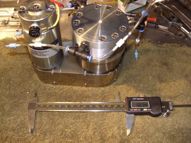

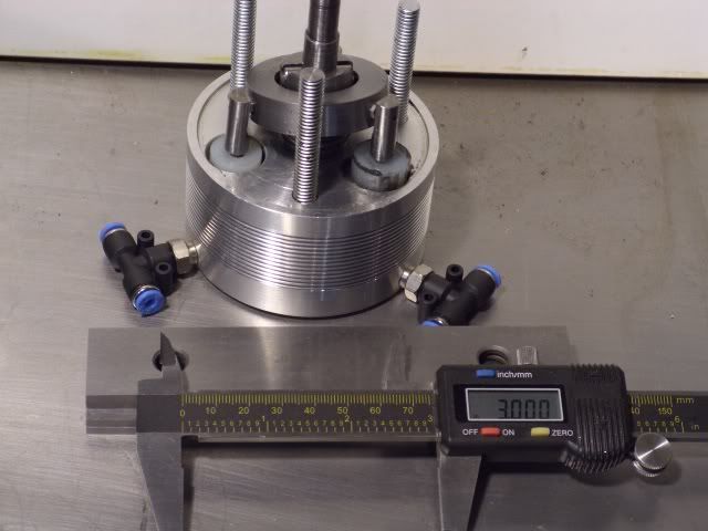

    Since there is a lot of interest in my lathe/mill thread about my homebuilt compressor, i decided to start a thread on it.
    Yes it does work(yay!), but im not quite done with it yet. i still have to figure out how fast my new motor that i won on ebay will spin the compressor.

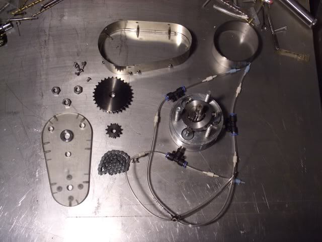

    it is made from a solid piece of 6061 aluminum round(duh) stock, the pistons are 3/4" nylon, the belt cover is made of plexi and SS shim stock (0.01" from enco) all SS screws, and fitting from clippard.com, poweraire.com
    ill post some pics of the internals but for now ill just repost the ones that i posted in the other thread
    *note* this is not the motor that i will be using, too wimpy

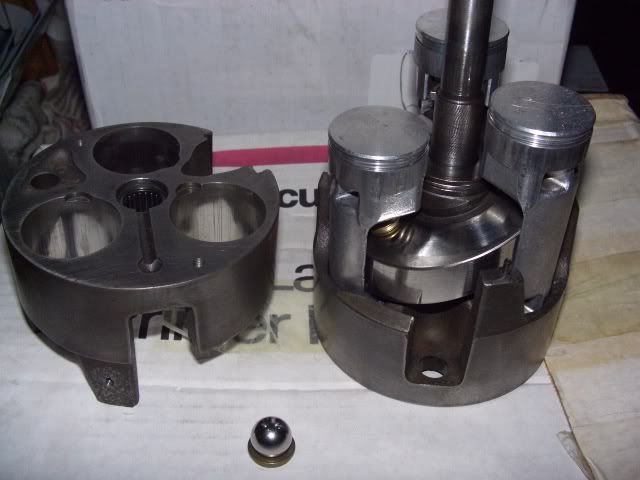

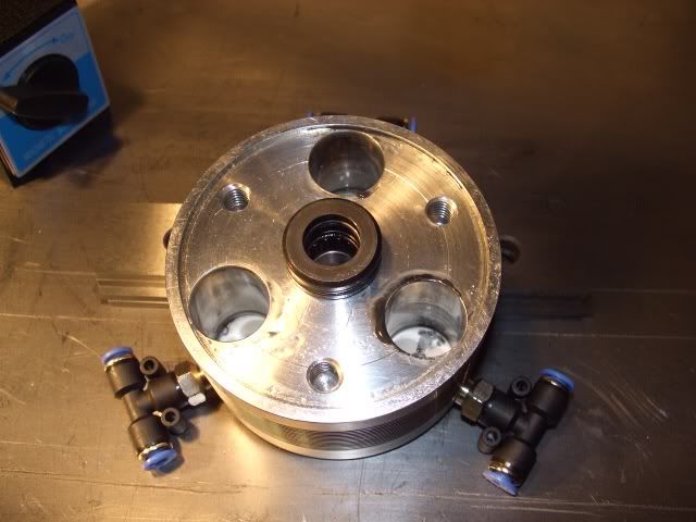

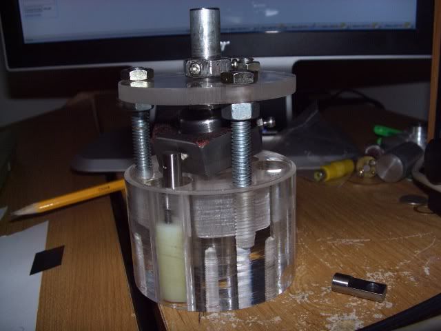

    ok here it is guys. the first few were a 'proof of concept' design to see if it would work
    'exploded' view

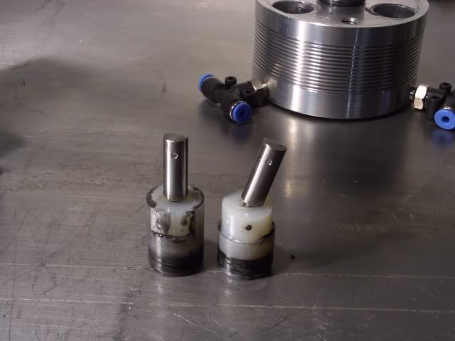

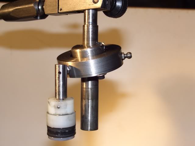

    pistons dangling from SS ball joints/home made SS ball cups
    the only thing i didnt make was the angled part on the shaft(the shaft is even hardened), that is what gave me the idea in the first place. it is from an ooooold impact wrench that didnt work.
    one piston needs to have a solid connecting rod and the other two need to be able to move, i found that out on the proof of concept (these things just dont come out on paper)
    piston block
    small video
    http://media.putfile.com/mini_compressor-034
    Click here to watch mini_compressor-036
  6. #6
    Join Date
    Dec 2004
    Posts
    524
    If you run this at high pressure, it will generate a lot of heat. I would be surprised if the nylon can take the heat. But it's a really neat design.

    I would use a belt drive if you can, it will quiet it down a bit. If you can't, try to tighten the chain up a bit...You'll get quite a bit of noise/vibration off the chain drive.

    that is where i also got the idea from, an auto ac compressor. i didnt want to use one because these are too big and i didnt want to buy a big motor to run it. the chain drive is just fine, doesnt produce a lot of noise, since its inside of a chainguard, with 3/8" plexiglass on either side. i could have made it out of aluminum but i didnt have any laying around. ill mill slots so i can adjust the motor and tenison on the chain.
    the pistons are made of nylon, but i dont expect this to run at 100PSI, just enough to move some actuators, i guess i could have made them out of CI but i dont have any and i thought it would be overkill. i know acrylic melts very easily but nylon has a melting point of 410 - 432 °F and an operation temp of 104 - 338 °F (from matweb), i dont think it'll get that hot the way ill be running it.
    keep in mind that this is a MINI compressor its probably not going to compress air up to 100 PSI, maybe 30-40 PSI. i was wondering what i could use as an air tank, an exhausted propane torch tank, a paintball gun tank. right now im using a 2 liter soda bottle

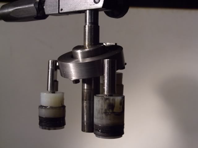

    Interesting, is the "wobble" assembly just a cam mechanism?
    Phil, Still too many interests, too many projects, and not enough time!!!!!!!!
    Vist my websites - http://pminmo.com & http://millpcbs.com
  12. #12
    Join Date
    Dec 2005
    Posts
    430
    it basically a piece of round stock drilled on an angle, a bearing preses on to that, then the outer ring with the ball joints presses onto the bearing

    got the new motor (all ball bearing) and a new drive sprocket (smaller, 11 tooth), much more powerful.
    at 3 amps i got a 2 liter soda bottle up to about 30 PSI, i didnt want to push is further because i didnt want the bottle to explode. it moves some actuators nicely and i found a pressure switch to turn it off at a certian psi. if i wanted too i could get some presseure regulators and regulate how much air flow comes out of the bottle.
    its pretty balanced and doesnt make a lot of noise, it would be quieter with a belt but its fine for now
