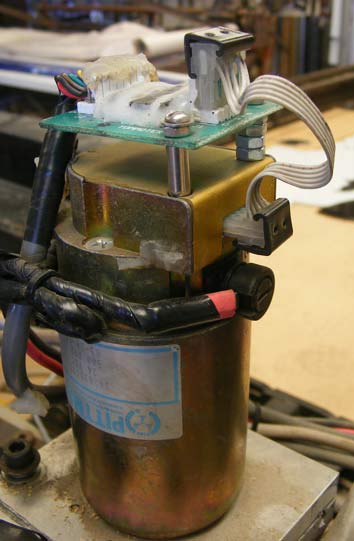

    Am I likely to need to alter any of the PID settings for the new servo in the driver software for the router- or should I just be able to plug the new servo in place & go?
    The existing Z axis servo became incredibly hot, and I changed bearings thinking that was the possible problem.
    When I retried it, the shaft spun readily enough by hand- not too easily- the magnetism in the stator made things a bit difficult.
    When I reconnected it, it would no longer turn slowly at low current/voltage settings where it did before. It took a higher % to make it rotate. I figured that'd be OK, and I reconnected it. Then I managed to blow a Mosfet transistor.
    I've just replaced that, but I'm thinking the original Z servo was underpowered for constant 3D height changes, while beforehand it was OK just moving to a set height/depth & staying there while a perimeter was routed.

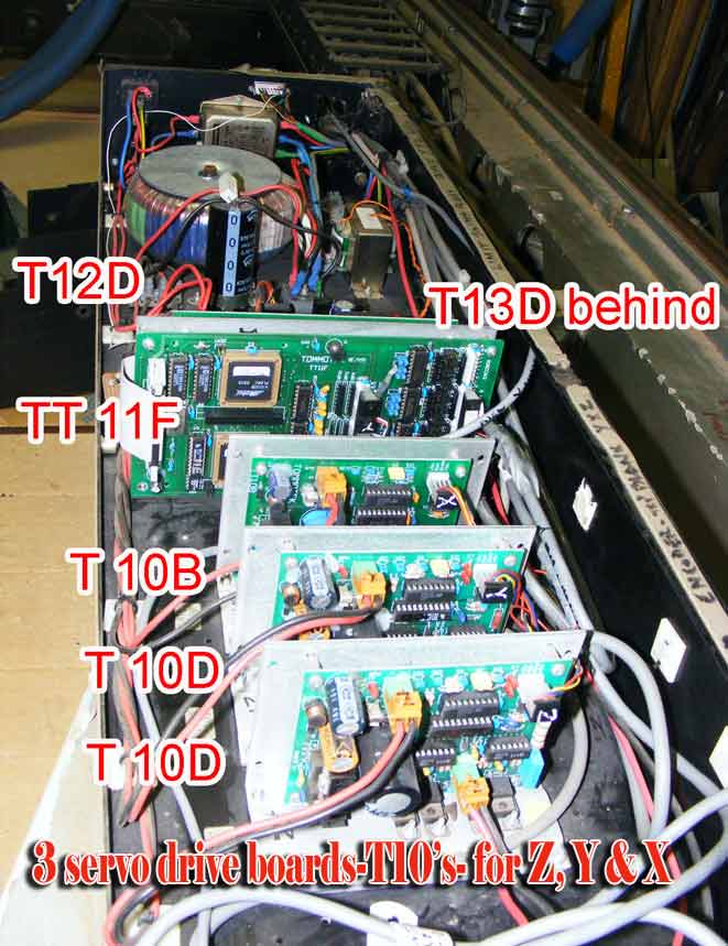

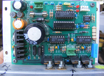

    Here are some photos which may clarify some bits of my inadequate explanations:
    The main computer on the router frame itself, containing the power supply for the servos, the drives for the servos, and the other boards that make it run & let it interpret the encoder signals etc:
    The T10D 'drive' board which is now fried. It formerly worked the Zaxis servo:
    The Pittman 14203 D173 servo which now operates in jerks of 180 degrees at low power, and stalls at higher power. I'm going to replace it. You can see the small board on top into which the encoder lead connects. A lead from that then goes back to the TT11F board, then from there to the T10D which drives each servo.
    (I hope they came through)

    Hi Stewey, if it was an Esab then I am guessing that in its previous life it was a plasma cutter or similar ? This would explain the small size of the servo's, I am not familiar with the controller at all, I rang a friend and he said they were a pretty good drive/controller.
    If nothing else I would think a bigger servo would help things greatly, as long as the drive can handle it of course.
    Looking at the drive I would think that the gate drivers would be fried as well if a FET or two has gone, they are the ones with IR2110 stamped on them, they are socketed and you could install new ones if you want to have a try at resurrecting it.

    Hi Stewey, the gate drivers may be the culprit, but also they may not, it is a bit hard to tell via forum
    I get my stuff from here, they stock through hole IR2110, do a search for that part number and they will come up :
    http://www.futurlec.com.au
    I also have a couple in the shed, I could send them if you would like to try them out, at a little over a couple of bucks each it would be worth a try.
    You did replace the blown FET's didn't you?, I think you mentioned doing so. What were they?

    Yes, I did replace the only obviously fried Mosfet- I think it was an IRF540 -r346. I got a very close IRF540 from Jaycar electronics when we were in Brisbane last weekend.
    I'm thinking of drawing out the schematics of this PCboard...to see what else I can do with it!
    The other two socketed IC's are an L6506 stepper motor controller (18 pin) , and a Lattice/Palce 16v8H-25PC4, 20 pin CMOS I think . I can't find them anywhere for sale yet.
