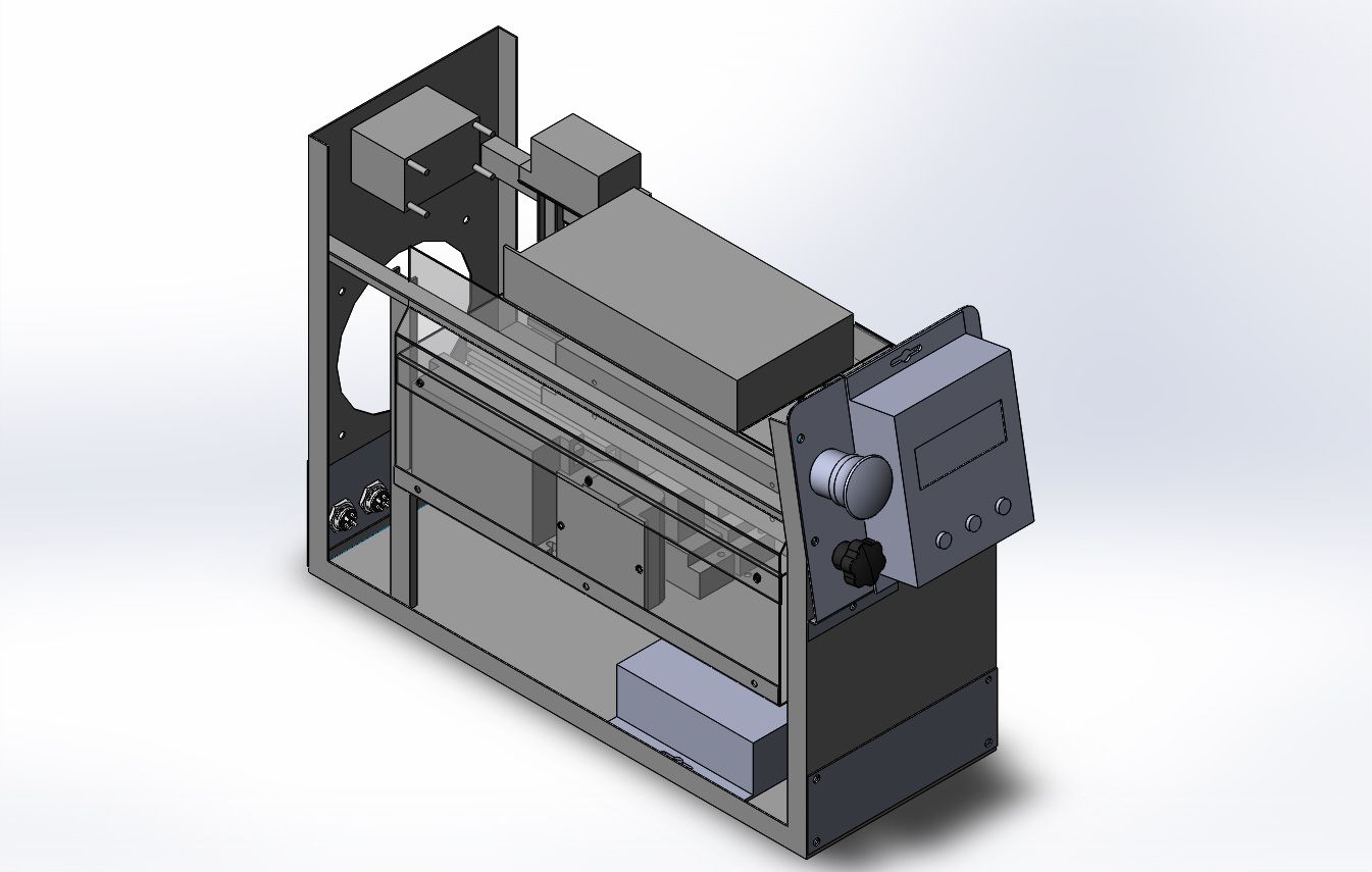

    Rod's Aussie Plasma Build
    Well, I really have no idea what I'm doing but after playing with an Arduino to make a rotary table controller, I got interested in steppers and seeing I had a basic plasma cutter here, I figured I'd have a go at building a CNC plasma cutter. I've decided to start with the electronics which I'm going to squeeze into a 40 amp plasma cutter case seeing I ended up with one that was beyond repair.
    So after accumulating some stuff which includes a mini ITX pc and an 8 gb industrial SSD unit, and a 12 volt Xenarc 7"touch screen, this is the mess I have (ignore the Arduino)
    Then I spent a fair bit of time designing some shelves for the enclosure to hold all the stuff
    So from the top down. Existing breaker switch and terminal, 12v/5v power supply,
    shelf for 48 v power supply
    4 x DM348A stepper drivers, 2 x relays, 24 volt power supply
    and room on the bottom for a breakout board behind the THC main board.

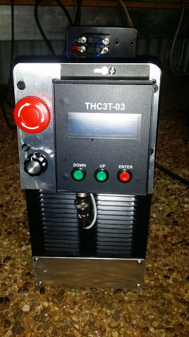

    And this afternoon, it started to come to life
    The THC controller interface box has a RS232 display on it and works in conjunction with the black knob to set voltages etc. there are heaps of connectors so I can't pass the wires through a grommet so have fed them out from under the panel. The THC is longer than the original slanted panel so I've extended the panel I made and folded it back to meet the case (you can see this detail on the rendered image). I did think about trying to mount it flush but in the end, I decided it was nice and easy to service this way even if the wires are a bit untidy.
    The Black knob is part of the THC. Selecting a THC took me quite a while as with the way the AUD is these days, it was not viable to import stuff from the US. In the end, I purchased a stand alone Torch Height Controller from Robot 3T in Vietnam THC3T-03: Stand Alone Plasma Torch Height Controller .
    You can find them on eBay but I bought direct and have been very pleased with the support received to date and the completeness of the kit which includes all the wiring, a voltage divider board and a proximity sensor for the surface sensing on the Z axis. Cost me USD $250 delivered. Not having a voltage divider or Arc OK signal in my Plasma was the deciding factor in selecting this unit over others, Plus Mesa were out of stock of their THC card. They emailed me the instruction book which is very complete and surprisingly well written.
    For software, I am going to start with LinuxCNC and may end up with a Mesa board down the track but my PC has a Parallel port on the motherboard so I will give an ordinary breakout board a try first as I have one here. I am absolutely blown away by the quality of the LinuxCNC documentation and the installation was a breeze even though I don't know much about Linux. If I run into problems getting the THC going, I might try Mach3 as Mach3 config instructions were included. From what I read, I will get better performance from LinuxCNC.
    Hopefully, tomorrow, I will be able to get the hardware off the design bench and folded up and the hardware installed in the case. I've got a small 24" pan brake here and have found it is pretty easy to print out a plan at 1:1 scale, glue it down with repositionable spray on glue and then it is simply a matter of cutting, drilling and folding along the dotted lines and peeling off the template later. In this case, I have had to join 2 A3 pages together. I had to bell out the shelves so they are wider at the bottom. I just hope those folds work out OK.
    I am certain I will have heaps of questions along the way. I'm lucky enough to have a mate who lives in the same street who is well versed with CNC builds and he's been helping me out a bit but any advice from the forum will be much appreciated.

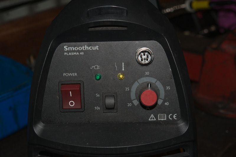

    I bought my Plasma from BOC here in Australia. A well respeted brand here. Probably Chinese made but running a Thermodynamics torch.
    BOC Smoothcut 40 Plasma Cutter | BOC Australia
    Yes, I know its only a baby (quite adequate for home use) but the electronics should handle pretty much anything so an upgrade to a better plasma cutter won't be a drama.

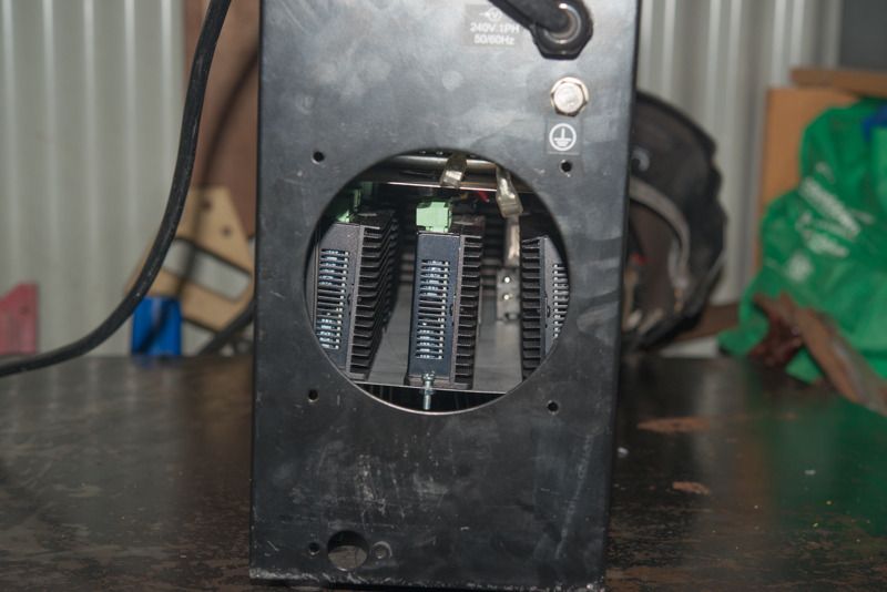

    The case I'm using for the electronics came from a Boss 40 amp plasma cutter. (An Australian brand and I have their 202 Amp MIG welder)
    Anyway, quite amazed that my chassis folded up perfectly. Even bolt holes to hold the pieces together lined up!

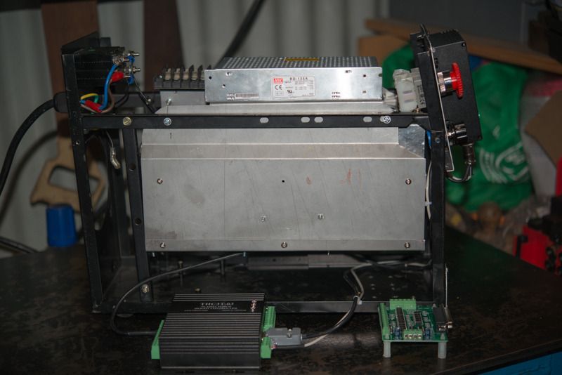

    Here's where I got to today
    I have to mount up the last layer for the electronics (layer 4) whihc comprises the BOB and THC control board pictured. I decided the Parallel port will poke out the bottom front panel and if it does not work out, It will be easy to make a new panel and add an Ethernet port for Mesa Card or Smooth Stepper. All of the wiring to limit switches and steppers will exit from the rear panel and I have not tackled that yet.

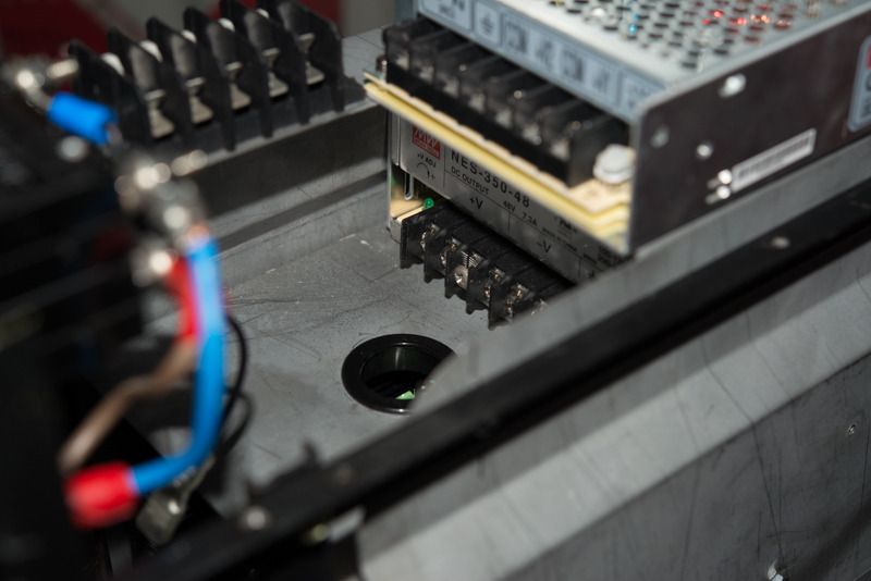

    Peeping into the middle of the machine where the stepper controllers and relays for the THC are mounted. I think the controllers are good for 4.2 amps and rated for 50 volts so I'm running at 48 volts. Once the fan is back in, there should not be any dramas with cooling!
    This shows the 12v/5v power supply (top) and the 48 V one below. Also the terminal block that was in the old plasma. I put the 12v/5v power supply at the top because it does not have a cooling fan and the 48 V one does. I mounted the 48v power supply further forward so the fan was not obscured by the smaller power supply.
    And what it looks like when closed up (minus a bolt or 2 to hold the cover on.)
    I'm hoping that this box can become a portable CNC controller that can be plugged into different machines but if that does not work out, It won't be too much of a drama. ONce I get to the wiring, I'm sure I'll have questions.

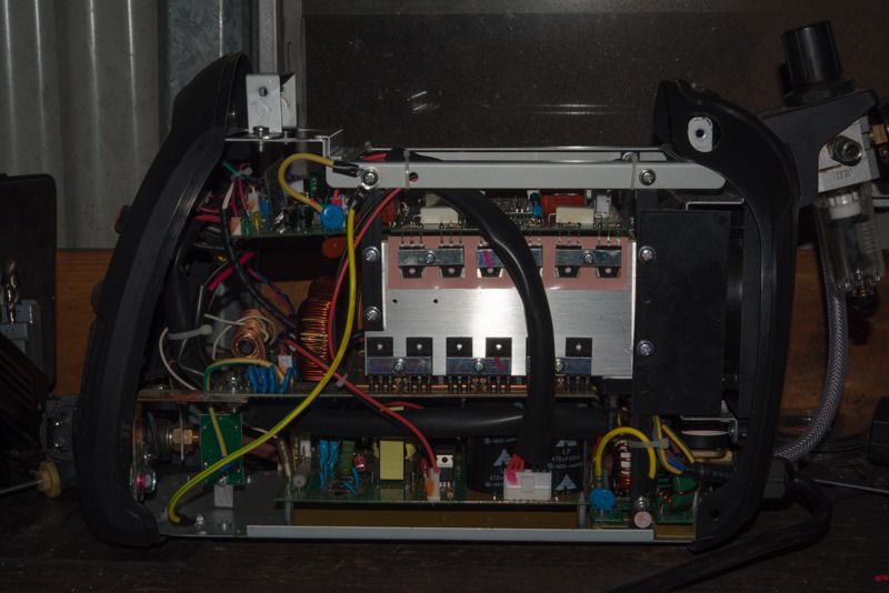

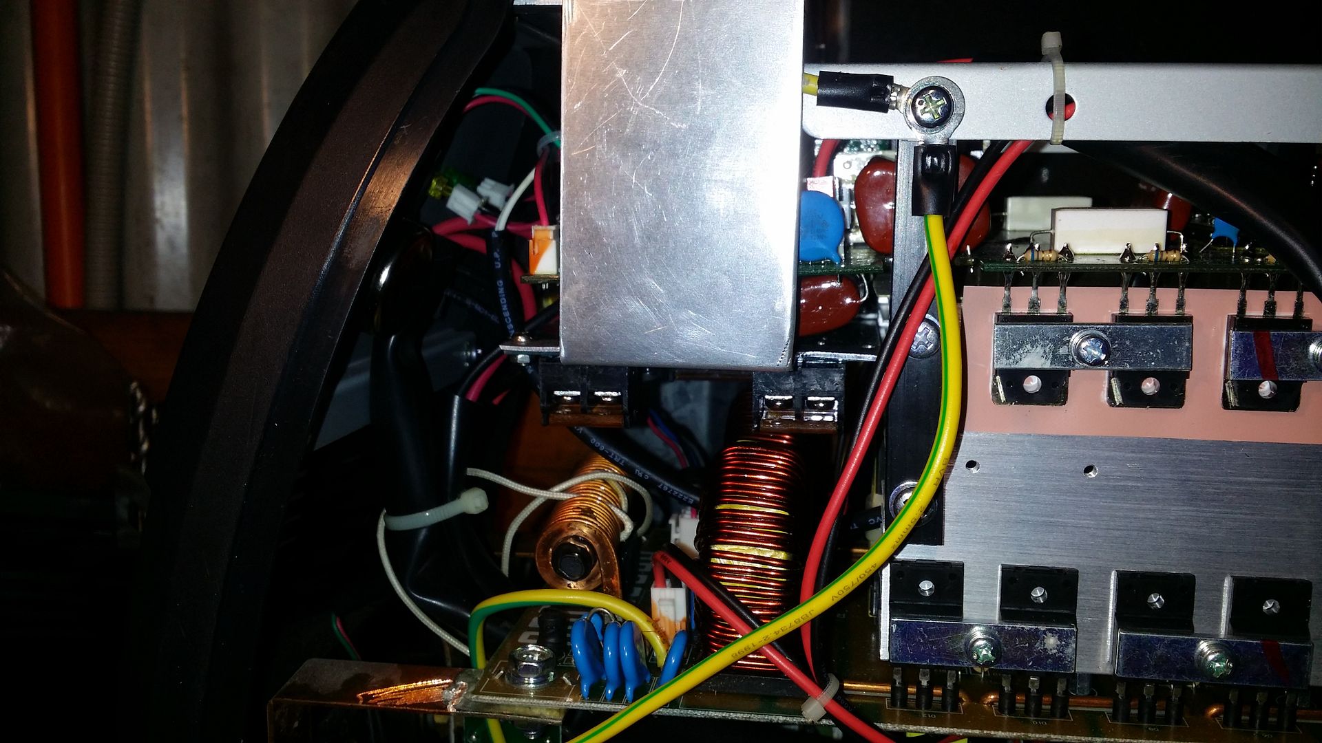

    Re: Rod's Aussie Plasma Build
    Torchhead, thanks for ongoing info. I am an absolute noob with any CNC stuff so have nothing to unlearn about Mach3, just heaps to learn.

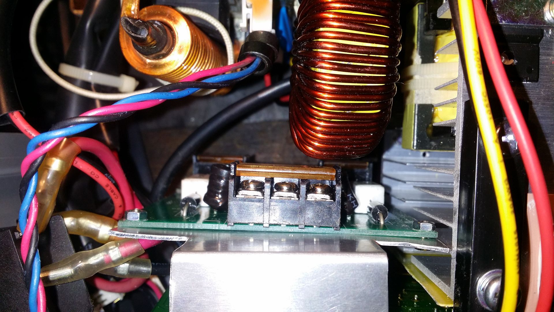

    So decided to look where the divider card might fit.
    Hmm, not a lot of room but there is a bit of space to the left of the large aluminium heat sink if I fold up a bracket
    Getting some wiring to the outside world seems to be easy enough. So much so, I drilled a 16mm hole in the front panel while I was at it. Absolutely amazed the instrument panel was fairly thick aluminium. I had assumed it was plastic like the rest of the case...
    So now to make sure I have shielded cables on the low voltage side of the divider card, I believe I need solder the earth shield to 1 pin on any connector. This is not the final connector I'll use but is what was handy to check for fit. I was planning on using a 3 pin version of this connector for the shield and low voltage wire back to the controller. Does that sound right?
    Off to design up a folded bracket to hold the voltage divider card......

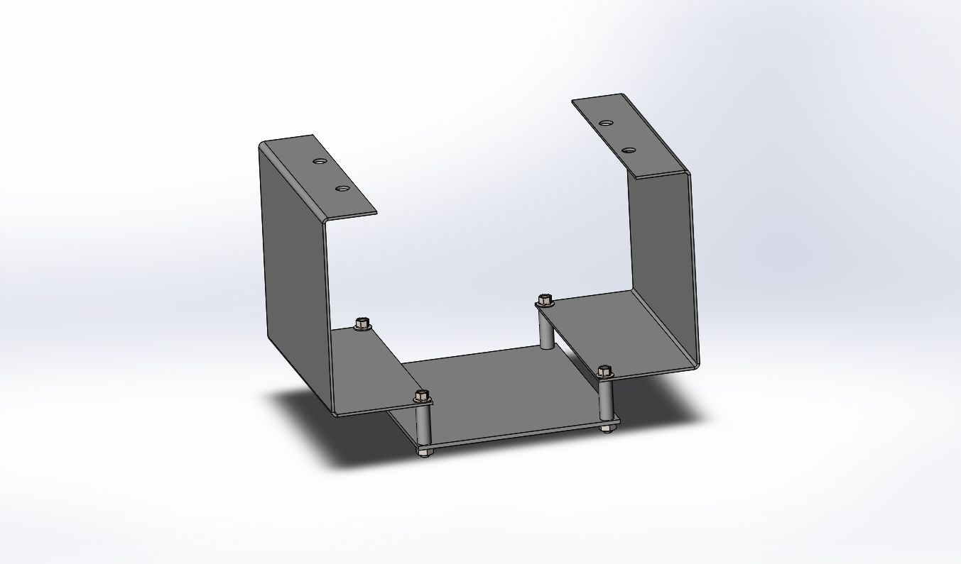

    This should do the trick to squeeze the divider card in
    Should mount using the 5mm screw that holds on the handle like bracket up the top front of the machine. Card will be upside down to give access to the connectors

    Mal, Thanks. Got me thinking. This type of connector does not give you a choice for panel mount so If it looks to be a problem I'll turn up a cap to protect the pins when being used as a manual machine. I've ordered some 3 pin connectors off eBay as Jaycar did not have any.
    IT looks like I have just enough room for the divider card.
    This pic is upside down on the opposite side of the machine but it shows how little room there is for this.
    I need to find some nylon nuts and bolts to secure the card to the bracket.. Jaycar have a listing for them so I'll grab some by the weekend.

    Hit a bit of a snag today. The 5v/12v Meanwell Power Supply I bought proved to be DOA. Very annoying.
    THe plasma is wired up and waiting for a plug to arrive for the voltage divider.
