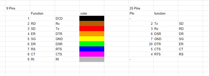

    I will need a way of getting these programs from my Computer to the machine.
    In the past, i have operated an HS-100 in the Toolroom where i used to work, we had a computer connected to the machine with an RS 232 Cable, and we could send the programs to the machine..
    That worked flawlessly, so i want to get that to work in my workshop as well.
    I do have a computer, with Windows XP, which is sufficient for Running 2D Cad and CAM sottware.. it has a 9 pin RS232 Connector, and the machine has a 25 Pins Connetor..
    In the Past i had a similar connection between my Emco Compact 5 CNC Lathe and the Computer, when i was still running it with the EMCO Control.
    My Question is:: "Does anyone have a wire diagram for the Cable? ", and.. what kind of software are you running on the Computer to transfer these programs?

    Hi Arie,
    For the first part of your question what you need is commonly known as "null modem cable", plenty of examples found on Google. But you should first know if your machine (HB100) needs acknowledge signals, that needs a little bit more complicated cable but also easily found on Google.
    Simplest null modem cable would need just 3 wires for TX/RX plus GND but adding a shield is desirable. If acknowledge signals are needed then two more wires will be necessary.

    Re: Brother HS-100, Connection with Computer over RS 232
    I got everything sorted.. made a 9-pin to 25-pin cable, according to the pinsetting in the manual for the Machineside, and the "standard" pinsetting for a 9-pin Computerside..
    Rx and TX are indeed Crossed for my machine,
    But, this is for a 25-25 Cable, and my PC has of course a 9 pin connector.. so i had to make a 9-25 Cable
    like so.. and.. whaddayaknow...from a 9 pin to a 25 pin.. Rx and Tx are "Crossed" at the pins.. no crossing wires.. Pin 2 and 3 go straight across..
    Nice...
    For Communication, someone on the Dutch CNC Forum recommended NCnet Lite, It's only for one machine.. but ah.. well..all my other machines have USB receptacle, for insertion of USB Pokeybits.
    I took a 9-9 RS232 cable, Cutt off the pokey bit on one end, and soldered a 25 pins pokey bit to it.. Installed NCnet Lite on my Computer
    Put everyting in my car.. drove to the workshop (yes.. i know.. it is only 450 meters.. but Transporting a Computer, a screen and a keyboard on a bike.. hey.. i'm dutch.. but we do have our limits :wave
    I Set up the Computer near the Wire EDM, Hooked the RS232 Cable up, and... it all worked from the Get-Go..
