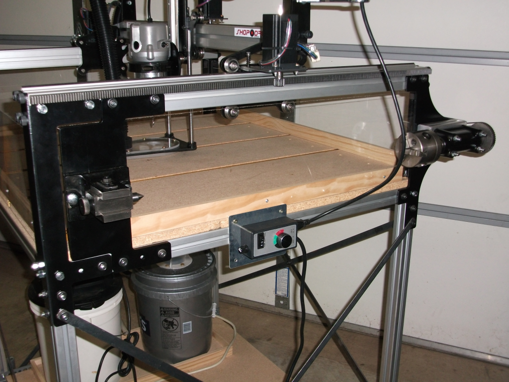

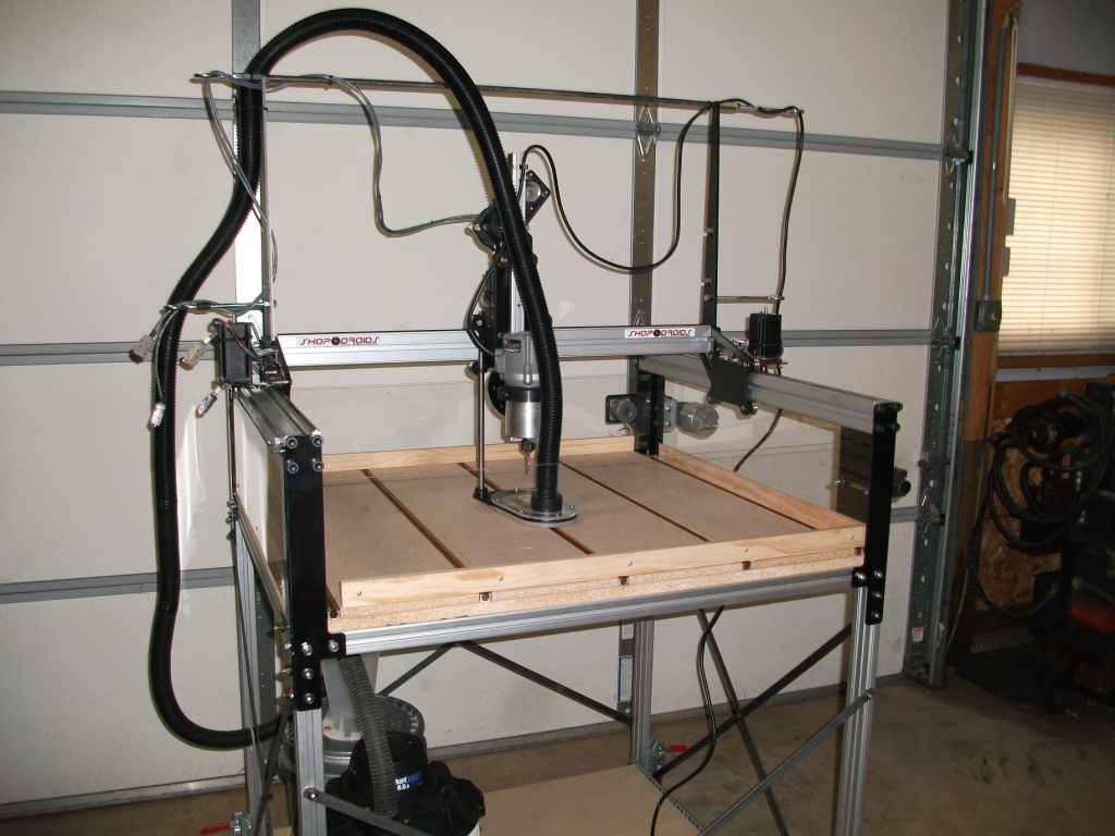

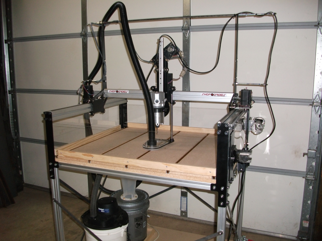

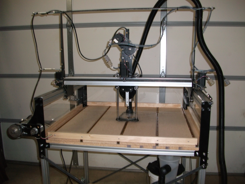

    I finally took out the time to take some pictures of my cnc router. Still a work in progress as it seems like I never run out of simple ideas to add to this machine...

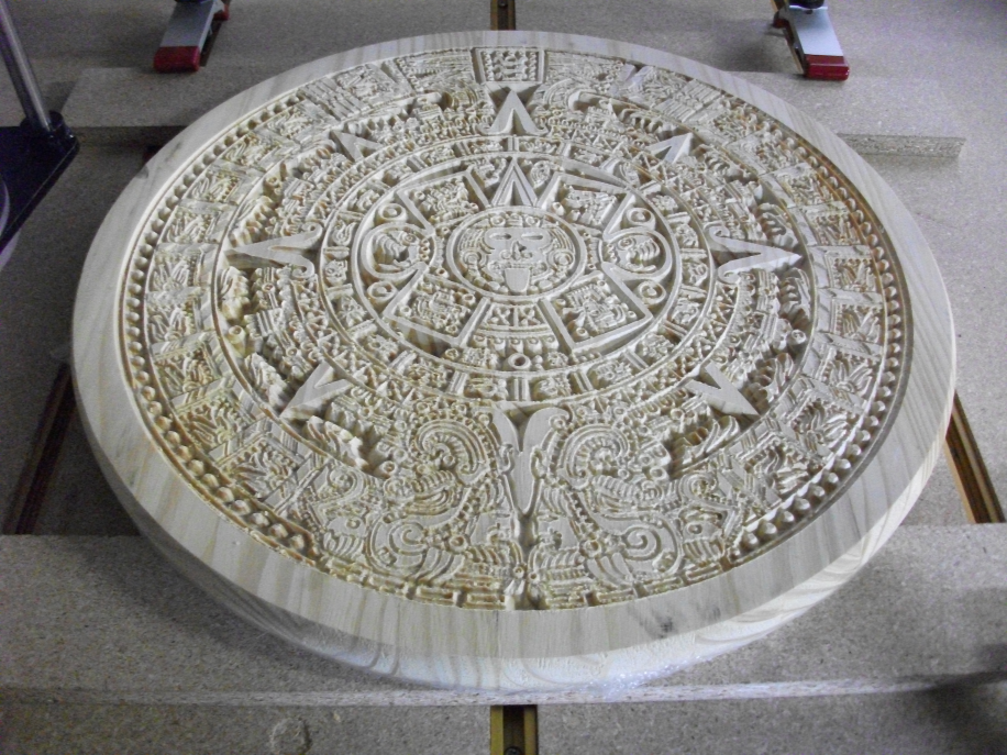

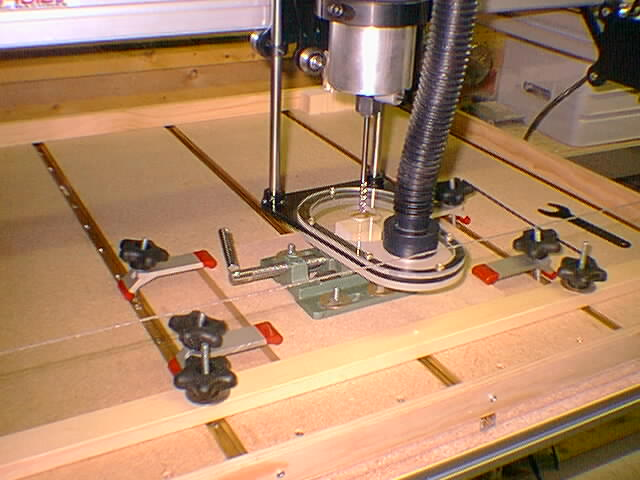

    Here is a picture of a Mayan Calendar carving that my son and I made today. We also shot a video to add to the fun...

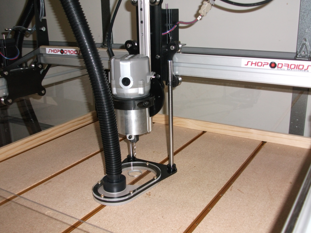

    Very clean, and that is a different take on vacuum. Rather than the vacuum moving up and down with the router, it is at a fixed height. Seems to work pretty good because dust wasn't flying everywhere.

    Thanks.
    Yes, the dust shield worked great, actually beyond my expectations. Although this type of dust control is mainly for flat panel type routing. Doing carvings in 3d would require the traditional vacuum which will move with the router.

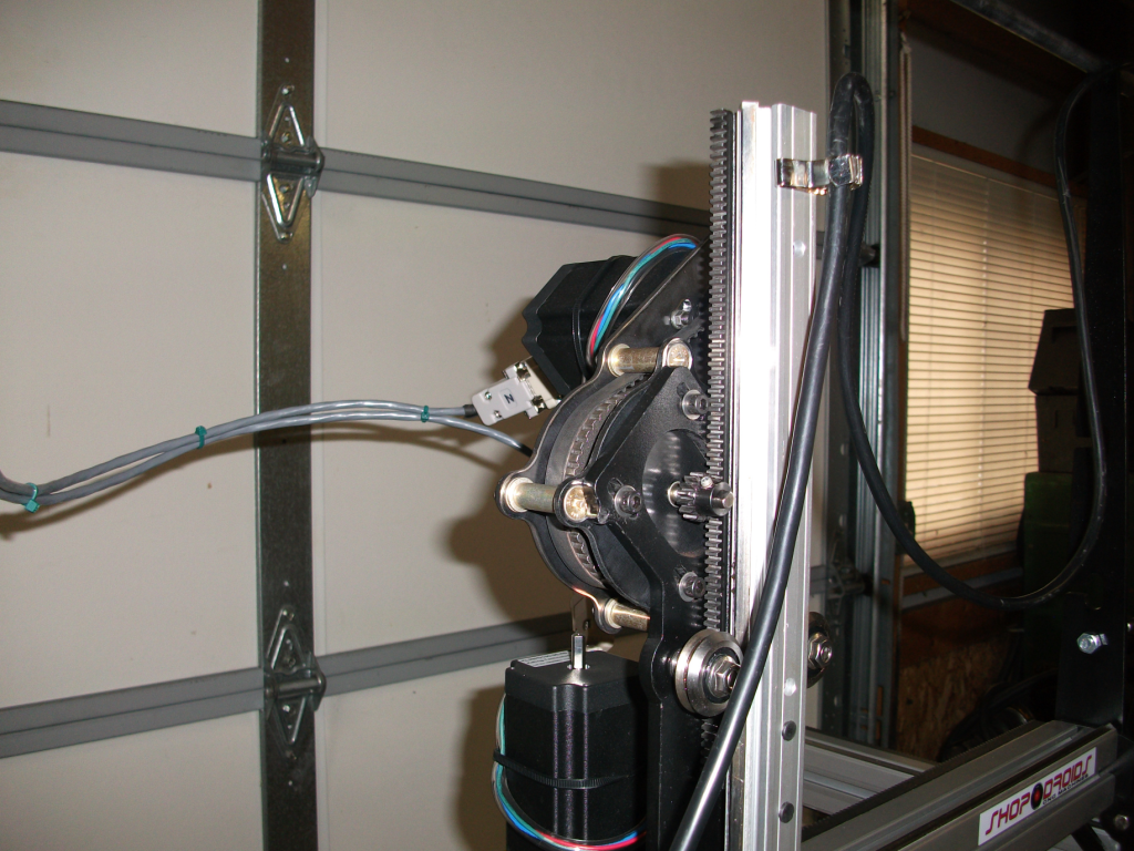

    Nice looking setup. I've only seen a very few with R&P Z axis.
    The Aztec calendar is an impressive carving isn't it? When it starts by boring holes in a random pattern it made me wonder if something was wrong the first time I cut one. I almost shut it down.

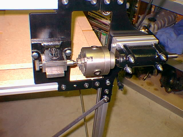

    Interesting 4th axis. This is definitely not a "me too" design.

    Thanks. I really wanted the R&P setup for my Z axis versus the traditional screw drive. It took a while to come up with a working design but I'm very happy with the way it finally turned out. The 3:1 gear reduction drive was the "Cherry on Top" of its final design...

    Yes, the calendar is a very impressive carving. Its funny that we had the same thoughts. When my son and I started watching the carving process, we were like "OMG, that doesn't look right!" It was a definite treat to watch the carving unfold to its final results. We had a lot of fun with this one.
    When I originally saw the mayan calendar on the vectric forum I knew that I had to make one. I'm just glad that I ran across your thread when you began to make them a while back then graciously posted the gcode. Once again, Thank you!

    Trust me that was not originally the case. I've had my fair share of dust storms. Now that winter is here, I moved the machine inside my office in the shop where its heated. I knew I could not operate the router in there unless I came up with a way to control the dust and chips. With that said, I can now spend more time creating with the machine rather than cleaning...

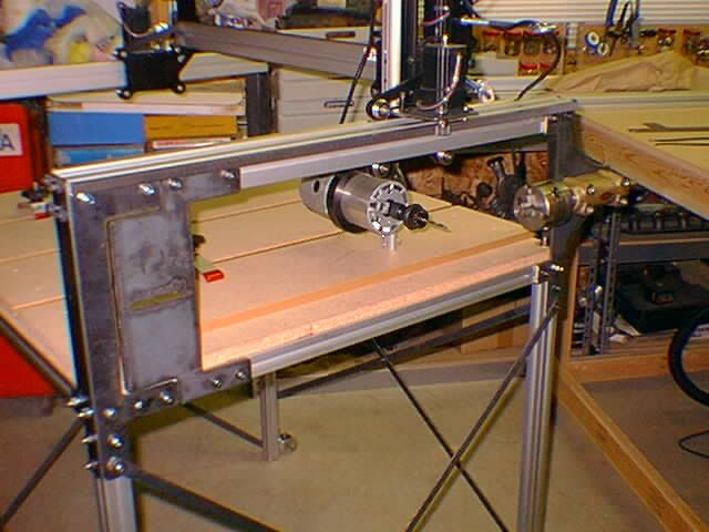

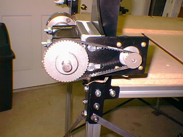

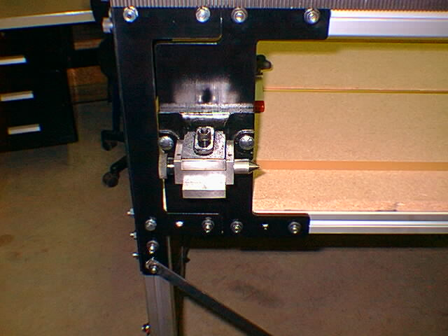

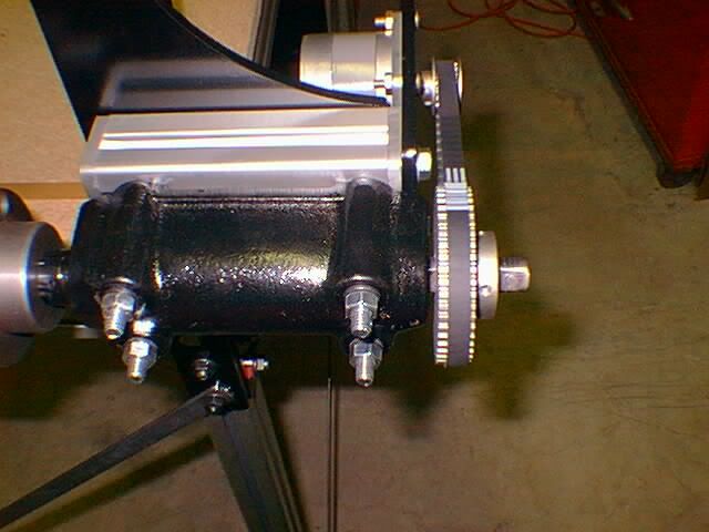

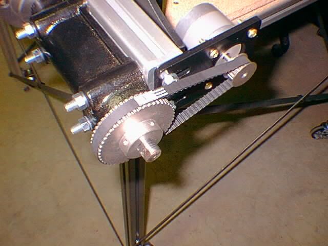

    It was an afterthought. I wanted to play around with making things on a 4th axis and to do that I had to come up with a solution that did not involve taking the machine apart.
    Here is a picture taken during the design process on how the router will interface with the 4th axis.

    Here are some additional images of the 4th axis. Max swing diameter on my table is 8+ inches with a 24 inch work piece length.

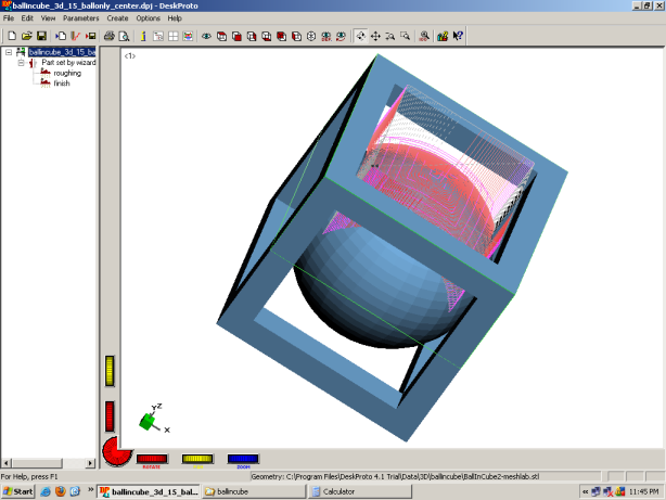

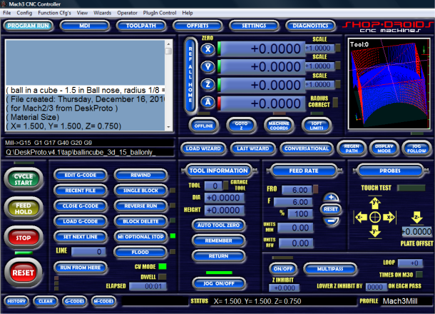

    The next project will be the "Ball in a Cube". (1.5" x 1.5" x 1.5") perfect for testing purposes prior to tackling a larger size. I've been wanting to make one of these ever since I saw one made on youtube. Just finished up the tap file and running it through Mach3 to view the profile cutting.
    The machine is all set up and ready to go. As soon as I get the extra time, with no interruptions, it will get started...

    I like your Mach 3 screen how did you get it
