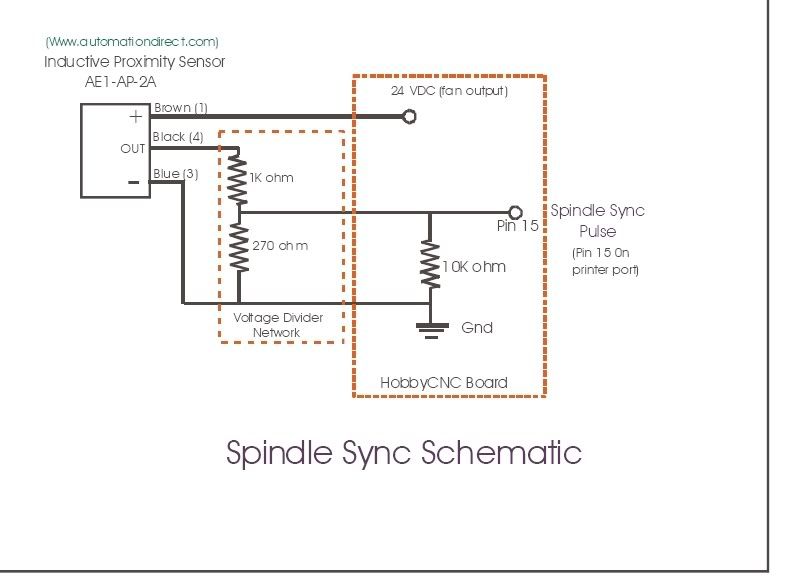

    Randy, very interesting. I did try hooking up the tachulator with a single band to the parallel port pin a while ago and could not get it to work. At this point I'm stumped. I can get both the tachulator and the proximity sensor to show a 5-v switch using my DMM but no luck with getting them to activate the parallel port pin for mach to recognize.
    I'm probably just to dumb with electronics to know what I am doing wrong.

    Stupid question, do you have the ground for the tach hooked up to the parallel port? Have you posted a schematic?(too lazy to look through the thread..)

    Question
    This is Ron's schematic I tried. I can get the sensor to output a 5 V pulse but it just does not do anything when hooked directly to the Parallel port.
    So what am I doing wrong?

    ......BREAKING NEWS.......
    It turns out that my printer port pin #15 just does not work. Arrrrgh!!!!!!!!!!!!!!
    The proximity sensor is now working on pin #13 and MACH sees the index signal! Son of a B!!!!!
    I never thought to hook it up to another pin as the all the other pins work fine.
    So the tachulator setup would probably work just fine as well. Oh well, now I will have two sources for spindle rpm readout.
    :wee::wee::wee:

    If memory serves me correctly, pin 15 is not pulled up internally in the printer port, add a pull up resistor and you should be fine.
    Cheers,
    Greg

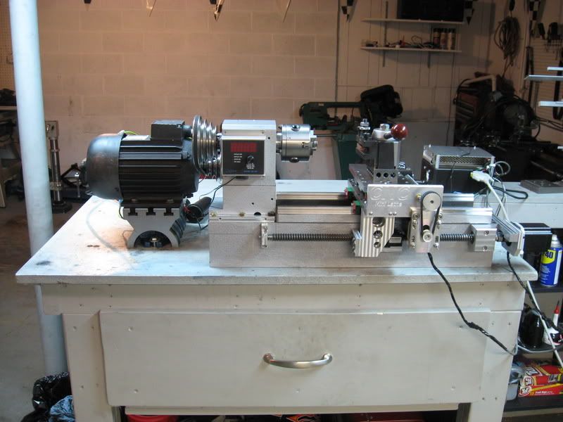

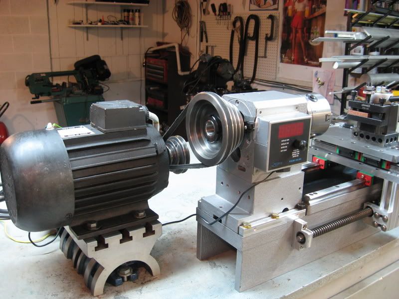

    the4thseal, many lathes use tapered rollers in the spindle. The mini lathe headstock uses ball bearings but you can fit in tapered rollers.
    dkowalcz, very interesting! Can you post some pics of your machine? I would love to see it.
    Willy, I have a 1hp Marathon 3ph inverter duty motor and a automation direct gs2 1hp VFD drive on my 9x20. Yep it is just to cool with all the functions.
    So, I spent the weekend machining some old iron step pulleys to test out the 3/4hp motor on the lathe.
    Well the results were just fantastic! The machine can easily take a .1" DOC (.2" off the diameter) in a single pass without any issue in both 1" steel and 1" aluminum! This is major cutting power for a machine this size and the lathe was not even bolted down so I could only put so much tension on the belt and it was a very worn old belt!
    But the best part is it now cuts great threads.
    These pics are of the test setup I rigged today. The pic of the thread is a 13TPI in .5" steel that was cut at 500rpm(try that manually). Very nice thread and it fit a nut perfectly. The other threaded piece in the pic is what happens with a week spindle drive that can't maintain consistent speed.
    SOOOOOO,, I am going to be doing some swapping of motors and drives.:rainfro:

    I want to to use polyflex belts since they run so smooth and are very easy to machine. So I'll be machining a lot of pulleys in my spare time.
