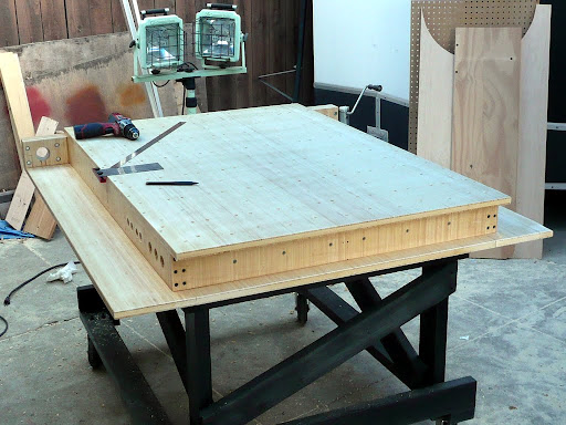

  20. #20
    Join Date
    Aug 2011
    Posts
    1000
    Somewhat slow progress due to varnish drying time and some small stuff but I got the table substructure pretty much finished now. Next step will be to attach the 80/20 profiles and the x-rails.
    So far I got the table flat to 15-20 mils over the 36x53" surface (judging from my steel ruler). Not bad for a lumber construction but will probably need shimming of the 80/20 profiles once I am done (or flat milling of the waste plates)
