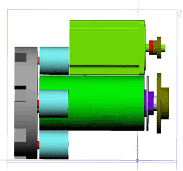

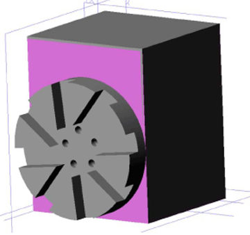

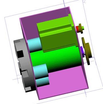

    In addition to the motor swap, I will be making a turret that will hold probably 6 tools (that’s the reason for the 3rd motor).

    I did spend most of last week designing an automatic tool changer. That is pretty much done. I now just have to order the material and make it.

    Here are a couple of the screen shots for the ATC.
    Since I only have a lathe, I needed to design a ATC that only had lathe cut parts. This was as close as I could get. The frame is welded 1/8” steel but everything else is lathe cut. The rotating assembly has angular contact bearings to keep it centered and straight. The motor is a NEMA 34 1200 oz motor. I’m going to use a chain drive to connect the motor to the spindle. There are four locks that hold the rotating assembly still while cutting. The turret uses air pressure to release the locks, but spring pressure to lock everything. This should provide for reliable use. I was concerned that if we lost air pressure, we could ruin the part.

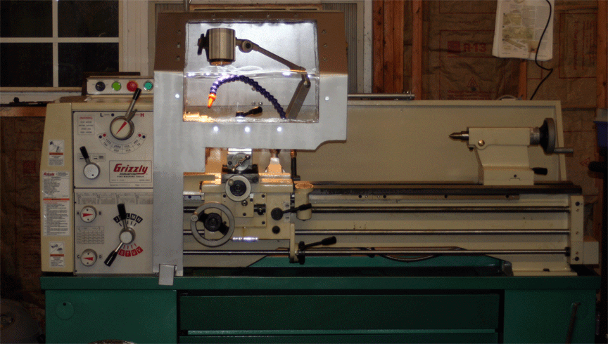

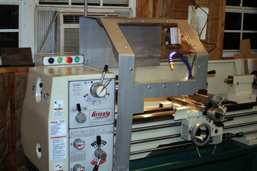

    Since I'm waiting on parts, I figured I would go ahead and make a coolant door.
    nothing fancy, but should do the trick.
