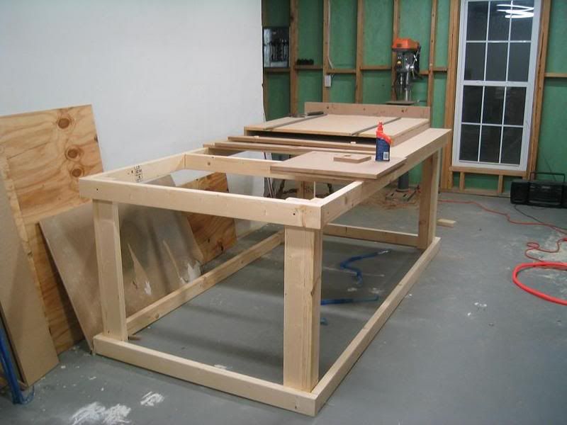

    Made a little progress. I've got the acme rods installed (not the nuts though). I'm using shaft couplers to mount them to the motors. The workpiece platform is just laid in the machine and not mounted yet....it will be removable.
    The MDF got chewed-up when making the motor mount hole. I didn't use clamps and the wood began vibrating and chewed up the hole. It still works, just looks like crap.
    -Levino

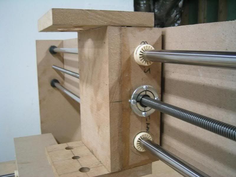

    The acme hardware is finally installed. I used "Precision Acme Rods" instead of "Precision Modified Acme Rod". Precision Modified Rod is a lot more expensive. Because of this I had a crappy selection of Acme nuts, none of them had flanges, so I had to make a clamping flange from a washer.....turned out pretty good.
    Here's the acme nut (black), hole and washer:
    Installed nut using 4 screws and washer:
    Installed on machine, X and Y axis:

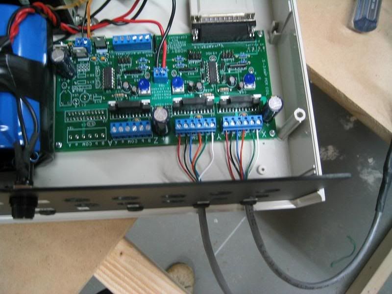

    For a controller, I'm using the 3-axis kit from www.hobbycnc.com.
    Here's the motors wired up, I don't have the Z-axis wired up yet:
    I might need to purchase a desktop computer. I don't have a 25 pin plug on my laptop, so I'm reduced to using a usb => 25 pin adapter. I'm guessing if there's too much lag in the adapter, the machine won't work properly.
    Here's the front of the unit:

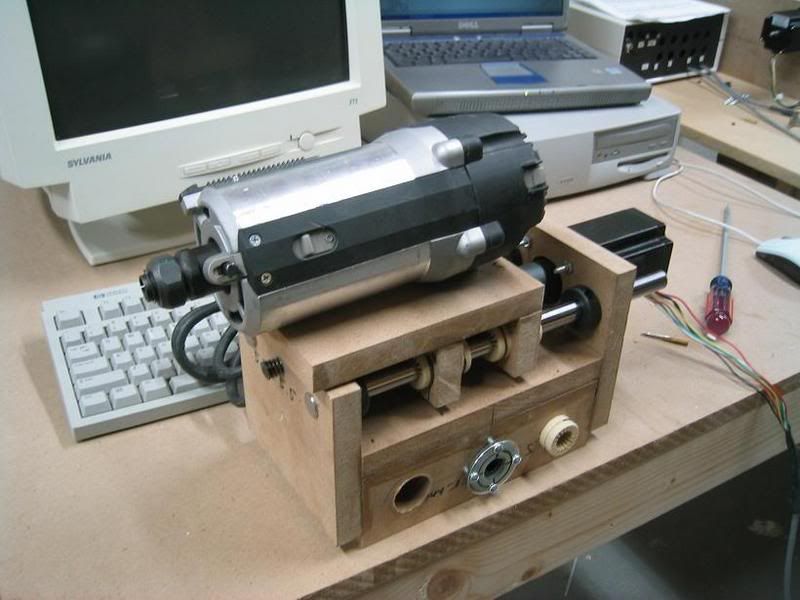

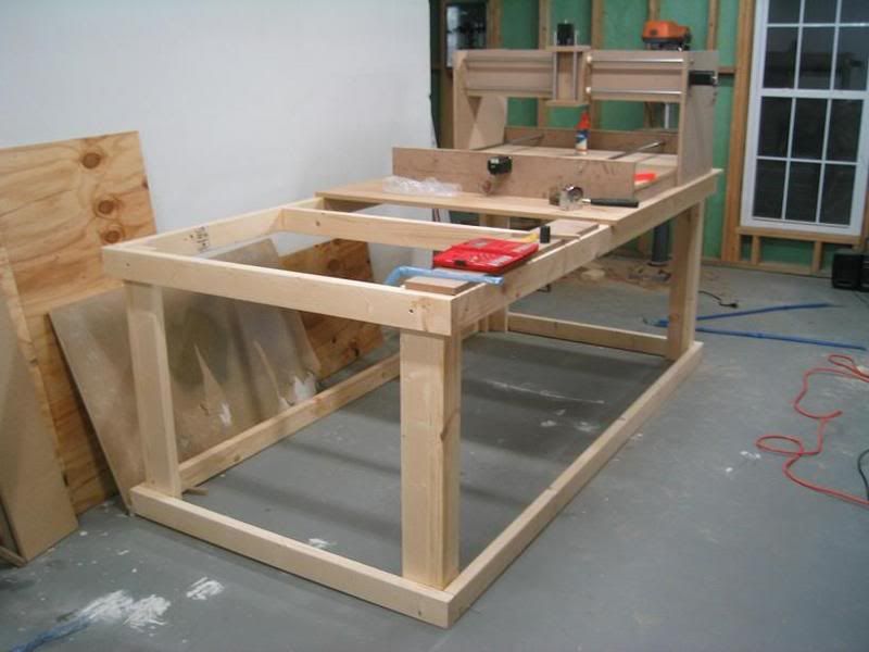

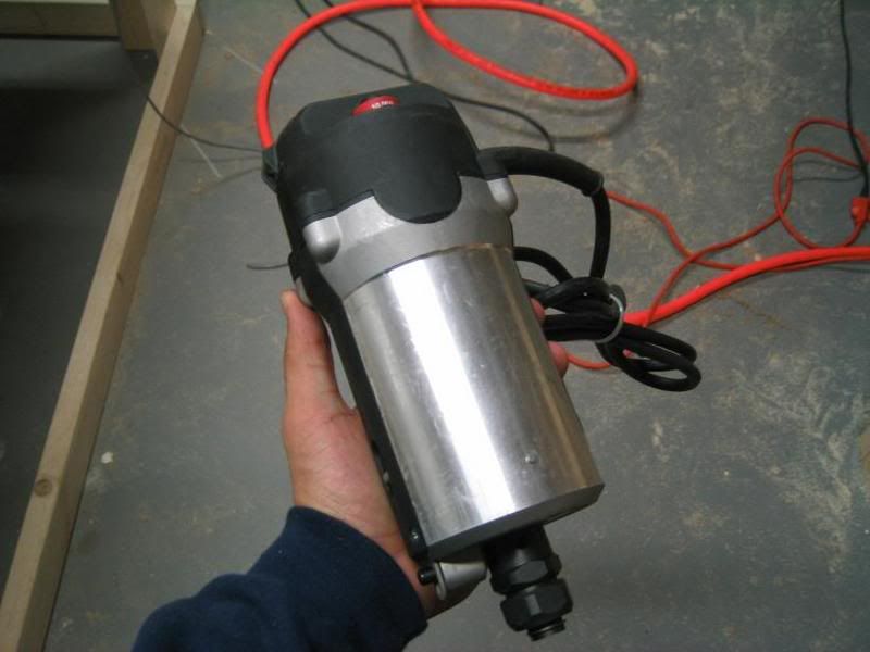

    Okay, here's a little progress. I finally worked on the Z-axis. Here is the finished Z-axis (one bearing isn't installed). I should have ~3.5" of travel. I need to move those shaft collars to the outside of the wood to get the full 3.5":
    I bought a porter cable router off ebay a while back:
    I'm waiting for the mount in the mail, should arrive by the end of the week. I got the K2 mount:
    Here's the Z-axis on the gantry:
    And the motor for size comparison:
    Also me holding the motor:
    The motor weighs 8-10 pounds, so it causes the Y-axis guides to deflect a little too much. To discourage this, I want to incorporate a L-bracket that hooks to the back of the Y-axis, and use bearings to decrease friction:
    I don't know exactly how I'm going to go about it, but if I can't mount the big motor, I'm going to have to use a dremel instead.....which would suck.
    As soon as I get the motor mounted, I'll only need to get the computer stuff figured out and I can then begin cutting stuff :biggrin:
    -Levino

    The real deflection problem will be in the other direction. When you start plunging the Z will tilt back a lot more than just the weight of the router tilting it forward.
  19. #19
    Join Date
    Mar 2007
    Posts
    18
    Quote Originally Posted by Rhodan View Post
    Ha, didn't even think about that. Cool thanks! I'll see if I can come up with a solution that makes it rigid in both directions
