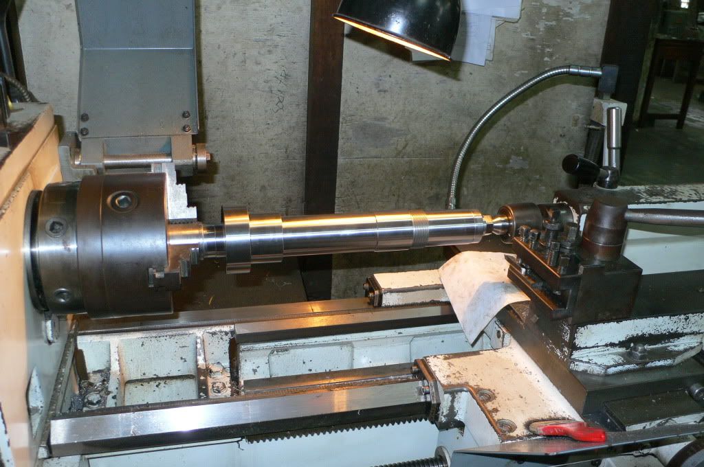

    Hi,

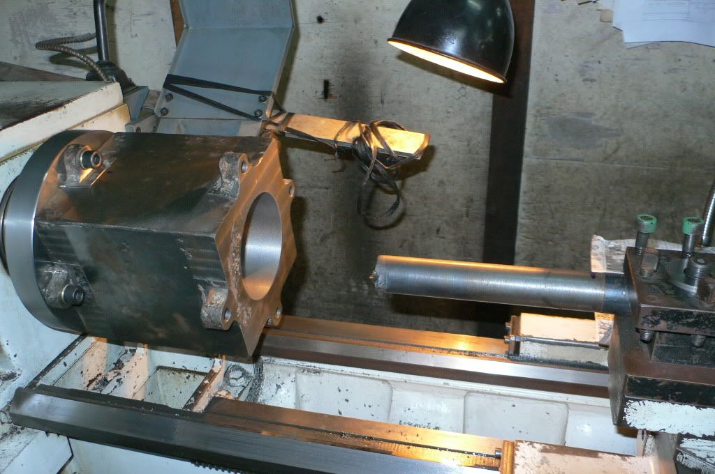

    I plan to create vertical gang lathe.
    Total length will be 800mm
    Linear slide by HIWIN 15mm with AC Servo motor.
    Ballscrew dia 15mm pitch 5mm
    Headstock 3-jaw chuck will be 3"
    Spindle speed 5000rpm

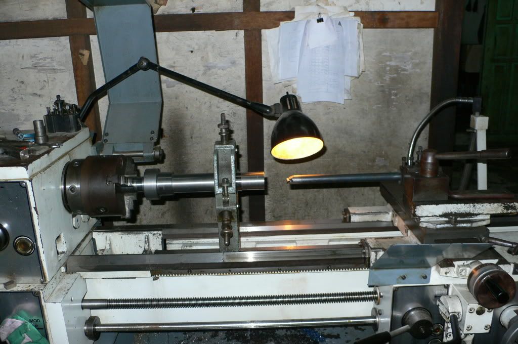

    I already start 1 week ago, by turning & grinding the headstock spindle.
    Here I do Internal turning.
    Finish Spindle, next week do drilling

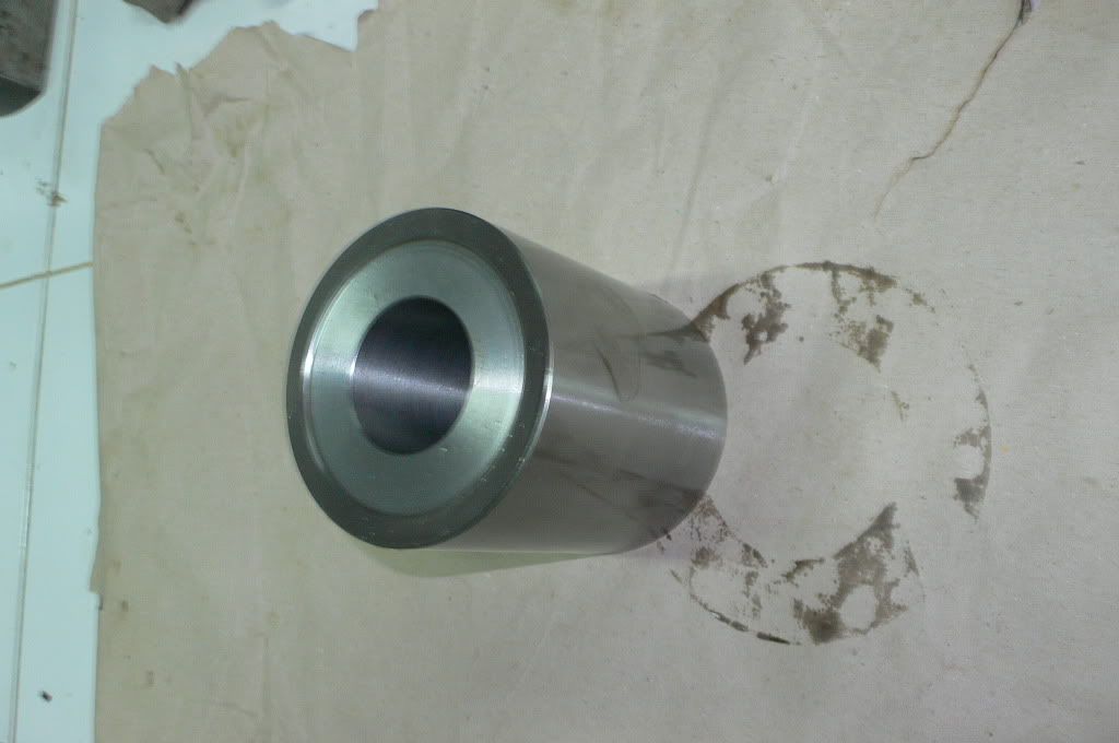

    Hi,
    Finally, I can do the headstock.
    http://i813.photobucket.com/albums/z...g/P1020487.jpg
  4. #4
    Join Date
    Nov 2005
    Posts
    264
    looks very nice. did you cast the headstock, or bore it to that size?

    The headstock made by cast iron, boring and finish by grinding.

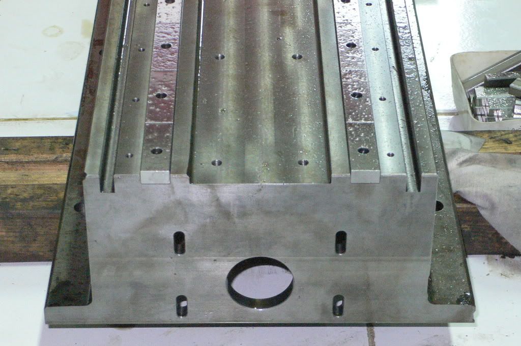

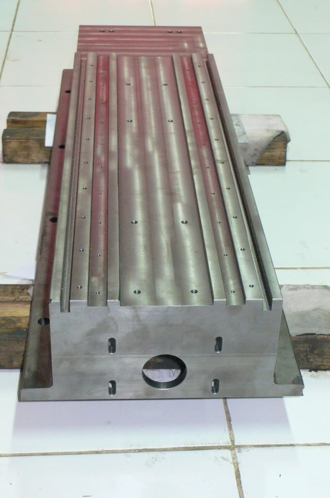

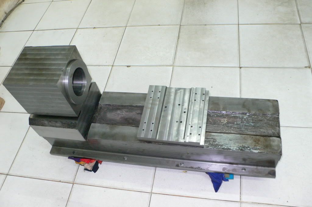

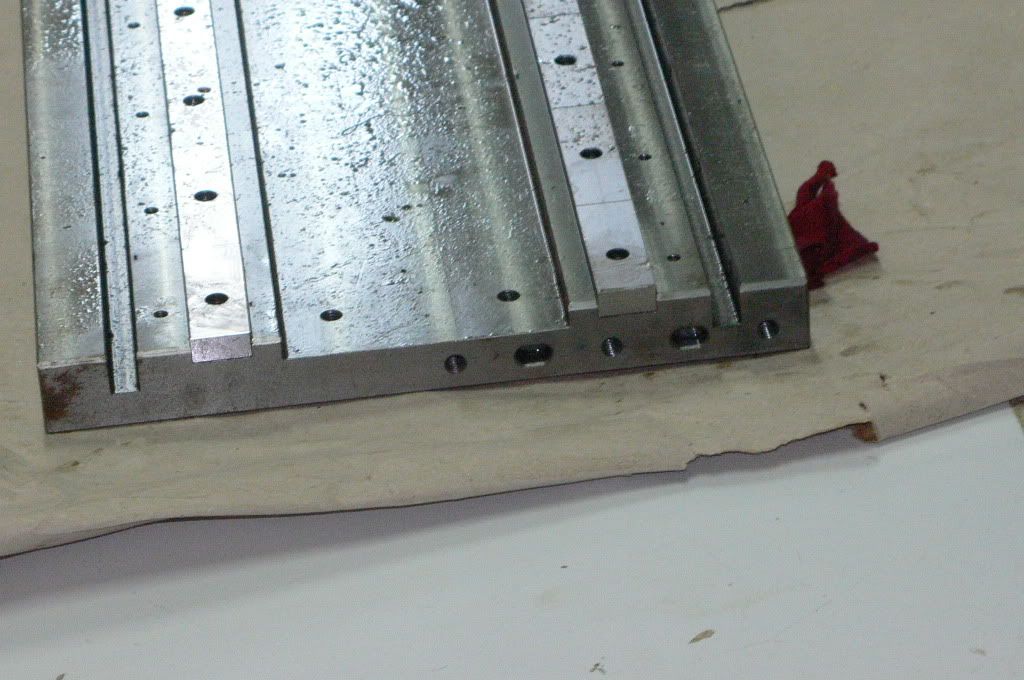

    Today I do the bottom of Z body.
    See the picture, total length is 800 mm, weight about 120kg.

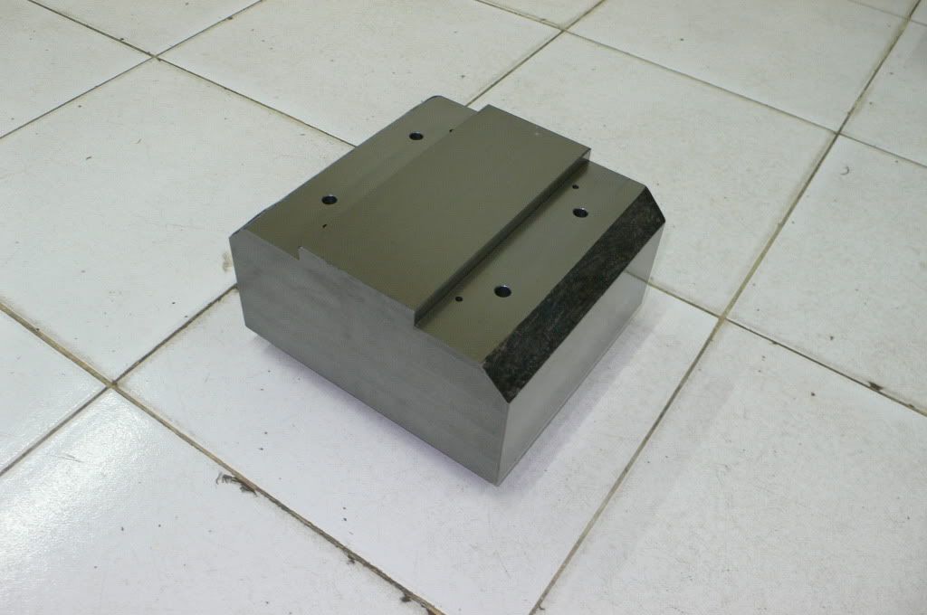

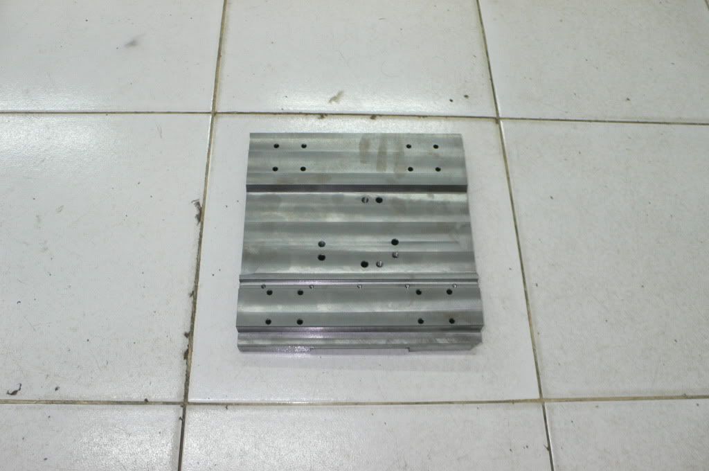

    Here is the riser block, will be put under headstock.

    That's some fine turning you've done there Monkey King! I can tell you enjoy doing it. I predict that your new lathe will be a work of art.
    Take care,
    Paul

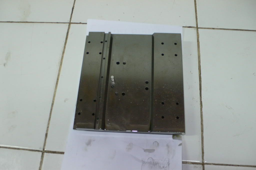

    Here is the middle parts between z axis & x axis.
    as size reference, 1 ceramic tile = 30 cm.

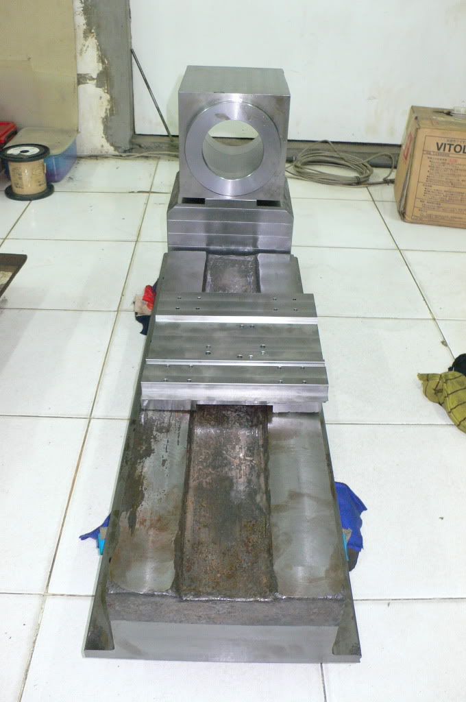

    Size estimation of the gang lathe.

    Wow, that is a serious lump of metal you have there.
    Nice design.
    Regards,
    Mark

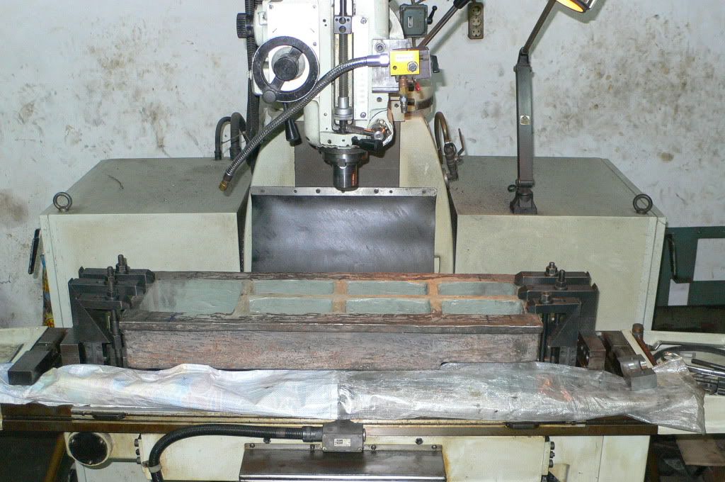

    Today I finish the Z Body.
    :banana::banana::banana:

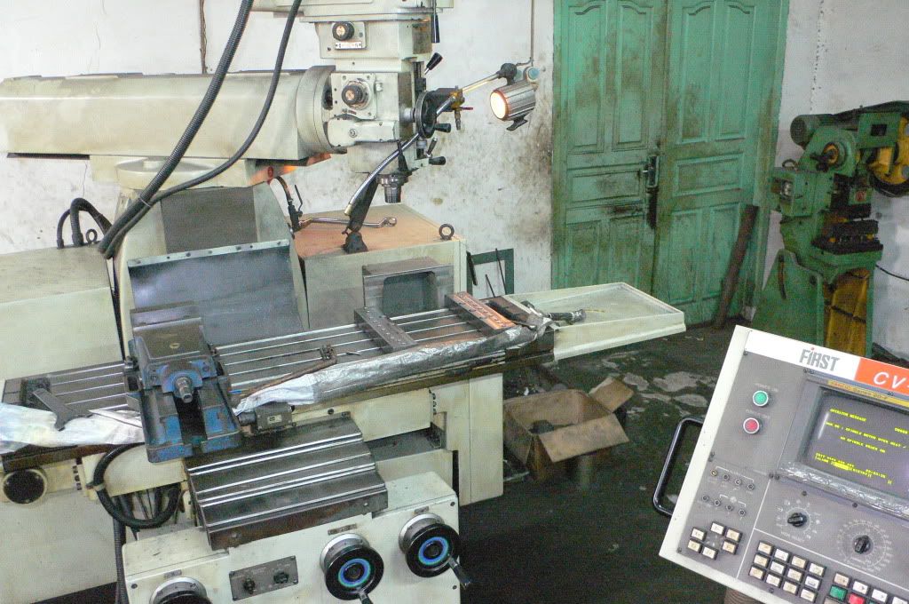

    Nice work. What mill are you using to make this?
    Regards,
    Mark
  14. #14
    Join Date
    Feb 2010
    Posts
    0
    Hi Mark,
    I use cnc kneemill.

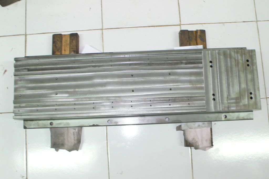

    Here another view of Z Body.

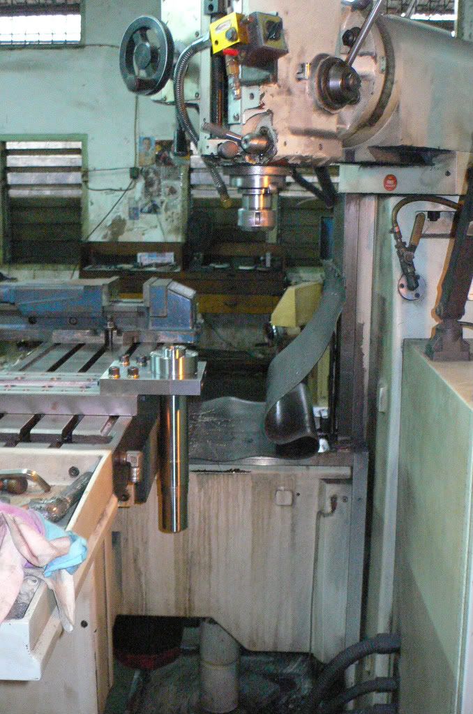

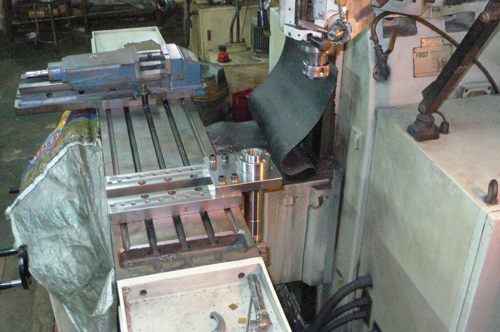

    Today I drill the bolt hole for lathe spindle. Must be precise to maintain the balance.
    Also I grind the middle parts between z axis & x axis.

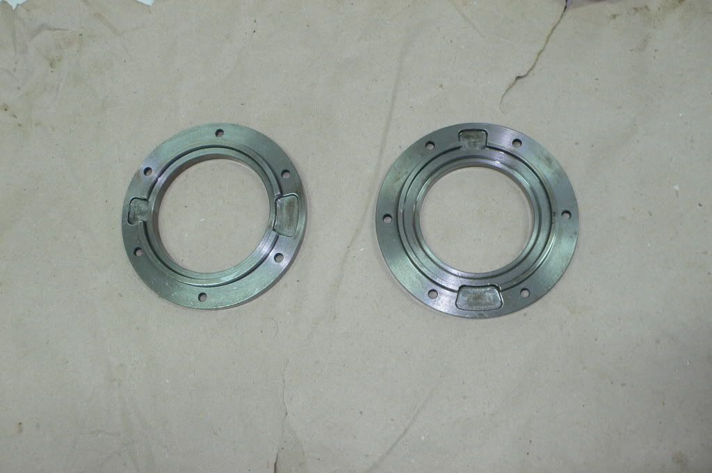

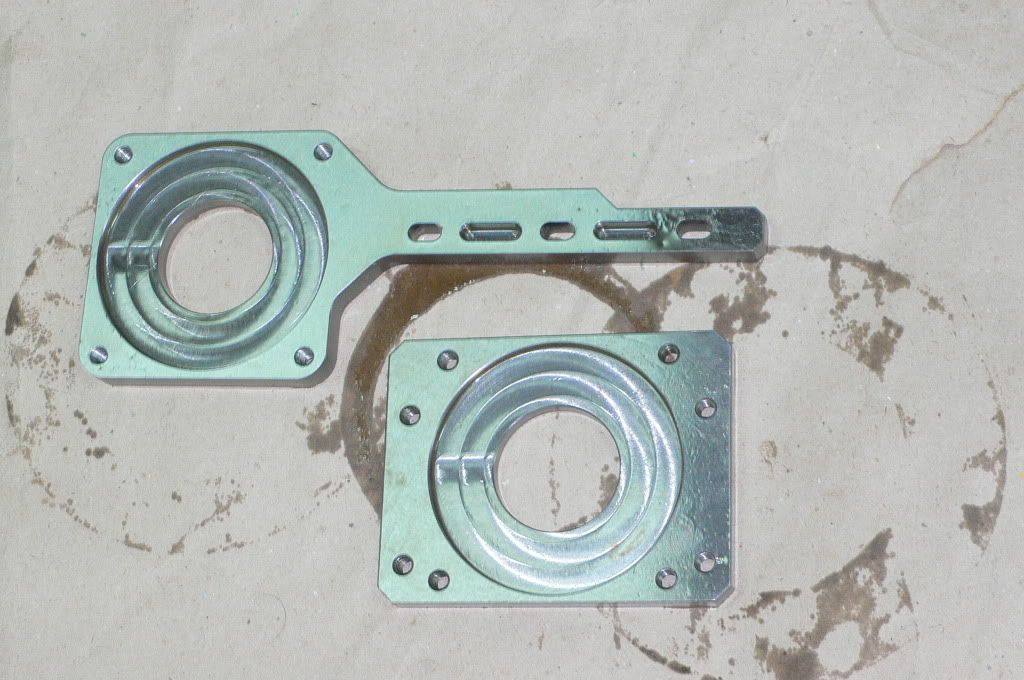

    I've done many thing here.
    Made the insert to stop the linear rail.
    Bearing stopper with grove for oil way.
    Holder for servo motor
    Ring between bearings.

    Very nice work!
    What bearings will you use on your spindle?

    Hi Bob Warfield,
    I'll use SKF 30310 J2/Q as back bearing and SKF 32212 J2/Q as front bearing.
