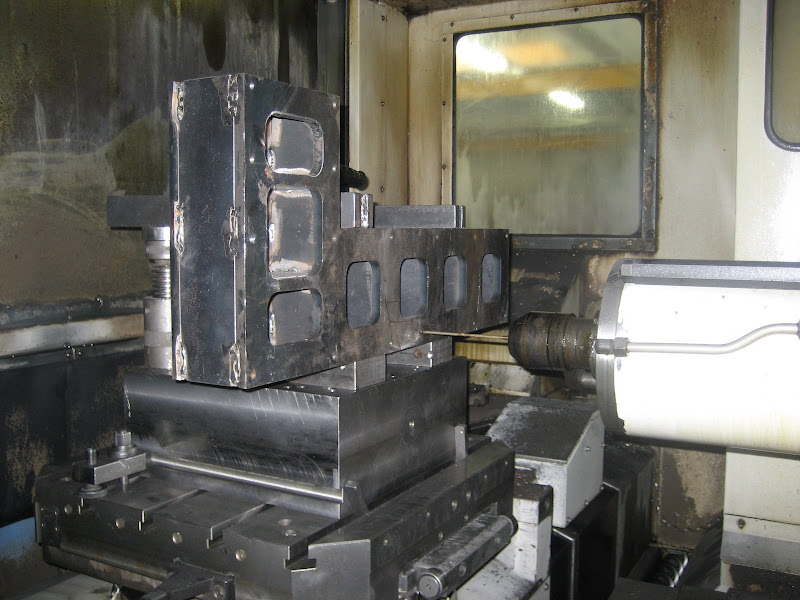

    Finally some update. I droped off the base at my uncles mid december, but nothing has happend until today, so lets just say that it has now "aged". Anyway, they have a nice big 4 axis machine, capable of machining workpieces up to Ø900x900 and 1200kg.
    Here is a picture of the first setup, machining the bottom and ends

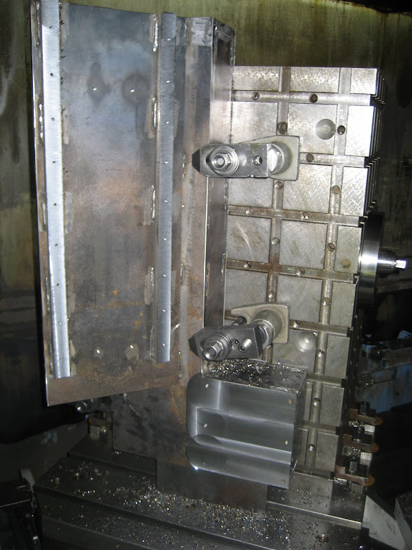

    Second setup

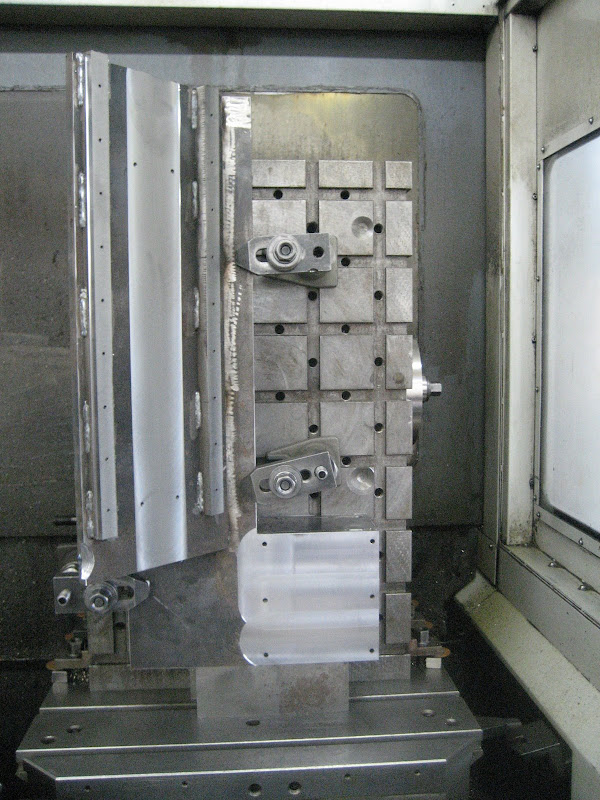

    Machining finished

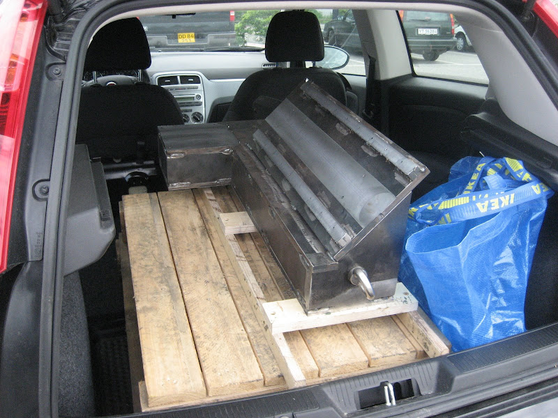

    Fits right in a punto

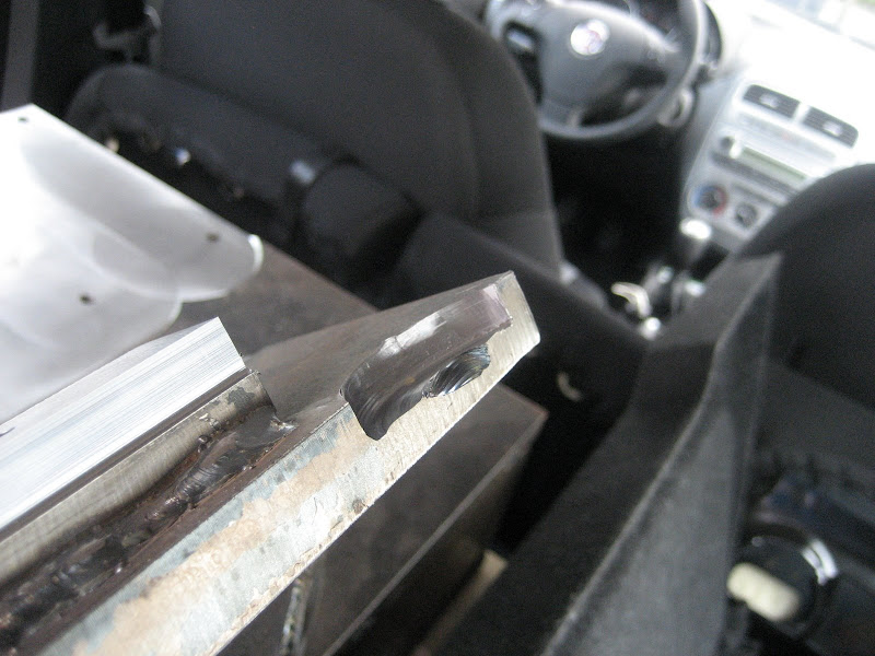

    And now the best part, this gonna make me feel a little better when I makes mistakes in the future. The machinist with 16 years of experience with this machine managed to ramp the face mill right into the workpiece. Its not ment for ramping so the material in the center is more or less just "pushed" away. Some serious forces, the machines is rated 380v 87amps!

    The difference is that it will now take another 16 years before he makes that mistake again.
    Looks very good.

    Were those setups done on the machine, or were they done with the fixture and lathe-bed horizontal on a bench, and then just hoisted on to the machine?
    I'm glad you got it home safely - from those pics , an E-stop in your car could have left you with a lathe bed for a head!

    A lil bondo will fix that screw up. Its looking great so far, love your enclosure.

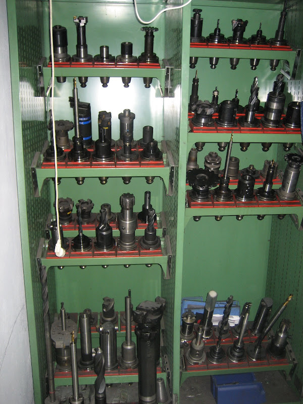

    Er, Guldberg, was that a counterbore he decided to give you for free or as they used to say in UK when someone made a mistake at the start, "a false start" LOL.
    You could always just drill a hole through the centre of the "cutout" and bolt something to it.
    It's in the right position to hang a light on.
    I love that tool cabinet with all the "goodies" hangin there, I bet you've got one in mind for yourself too.
    Ian.

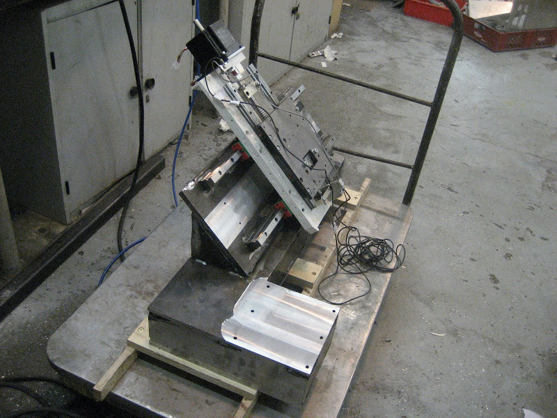

    The machine has interchanging pallets, so the pallet just roll outside the machine where you can access it. We decided to add a eye bolt (?) to the end so we could lift it with the crane in the second setup. With both the drill and the tap already in the machine it only took like a minute anyway. Got to get me one of these one day:-)
    I did a quick mount of the rails and the x-axis carriage. We made cut along the rail stand off's, so it was a breeze to dial in the rails. Wont be long till both axis are running, so I have to start fabricating the headstock soon

    Great job designing and building your CNC Lathe. Can't wait to see this machine in action. Keep of the good work.
