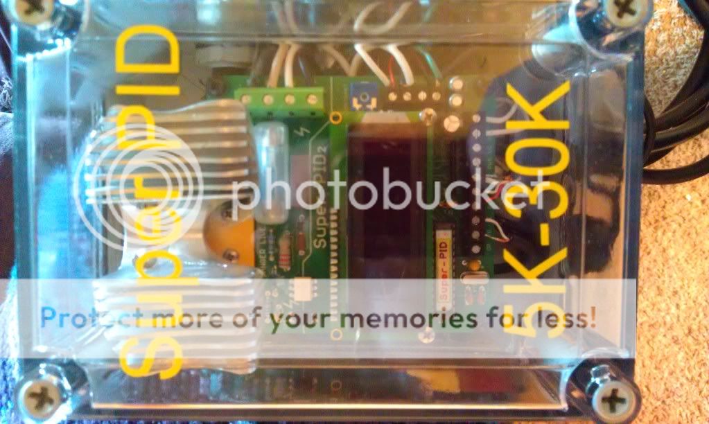

    Hey guys
    I am just about finished installing my Super PID and I was wondering if anyone is running Flashcut software? I'm running a Torchmate machine and they use FC. I need help figuring out how to interface the PID to my control box. I'm pretty sure I have figured out how to get it to turn the PID on and off but I have not figured out how to adjust the rpm from it. If needed I can supply a schematic for the control box and a screen shot of the software. It has an analog output in the menu but I see no way to hook it up. I have tried to contact FC but so far no reply.
    Thanks

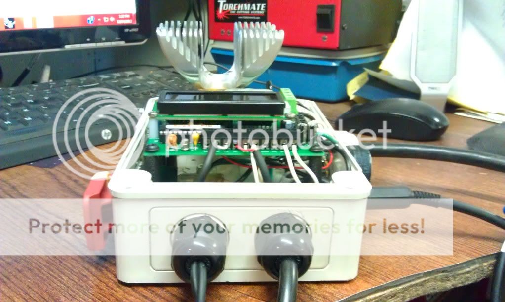

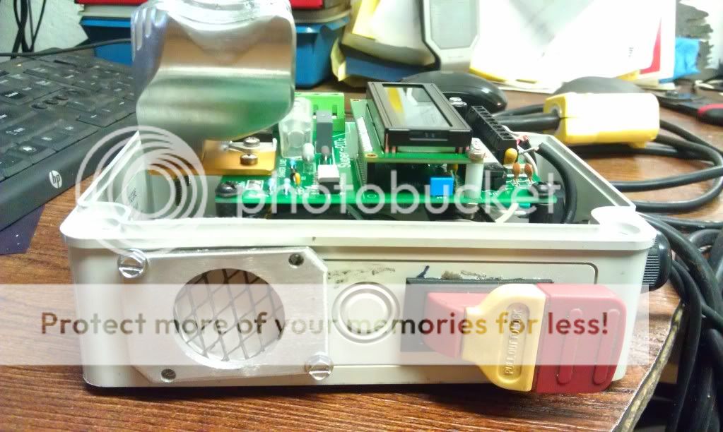

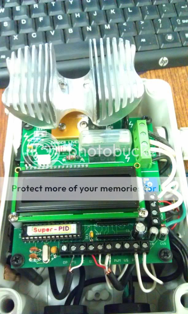

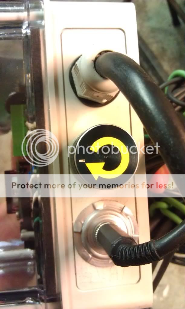

    Here are some pics of my setup.
  6. #1986
    Join Date
    Sep 2011
    Posts
    1183
    Great Pictures nice box I should install mine it has been setting on my work bench for almost a year..
    Lou

    To Stalthshooter- Hi, and thanks for all the great photos! That heatsink is amazing, I have never seen that style before. It's probably much bigger than is needed but that never hurts in an electronics device, the cooler the better is a general rule.

    Thanks RomanLini
    The heat sink is out of an old computer . It was way too big to fit where I needed it. I took the band saw and sander to it and custom fit it LOL. I'm in the midst of deciding weather to keep my flashcut system of change to a mach3 system. The Flashcut seems to be nice stuff but it has a lot of things lacking that I would really like and it will cost more to upgrade them than it will to just start over.

    curioser and curioser
    tried two more tests
    1st test
    comand RUN and just see what happens
    motor starts to turn
    gets faster and faster (way beyond 5k set on pot)
    PID say - start failed, power off
    as motor slow sensor reading appears
    so PID start up again
    GOTO step 1
    rinse
    repeat
    maybe sensor just doesn't work at high speeds
    2nd test
    RTFM
    noticed Open Circuit mode
    let's give that a try
    motor speed responds nicely to pot position
    so all is not completely lost
    just need to figure out why the sensor doesn't work at high speed
    haven't changed anything
    well almost nothing
    sensor now comes into the PID enclosure via a 5 pin socket
    might try removing that from the equation tomorrow
