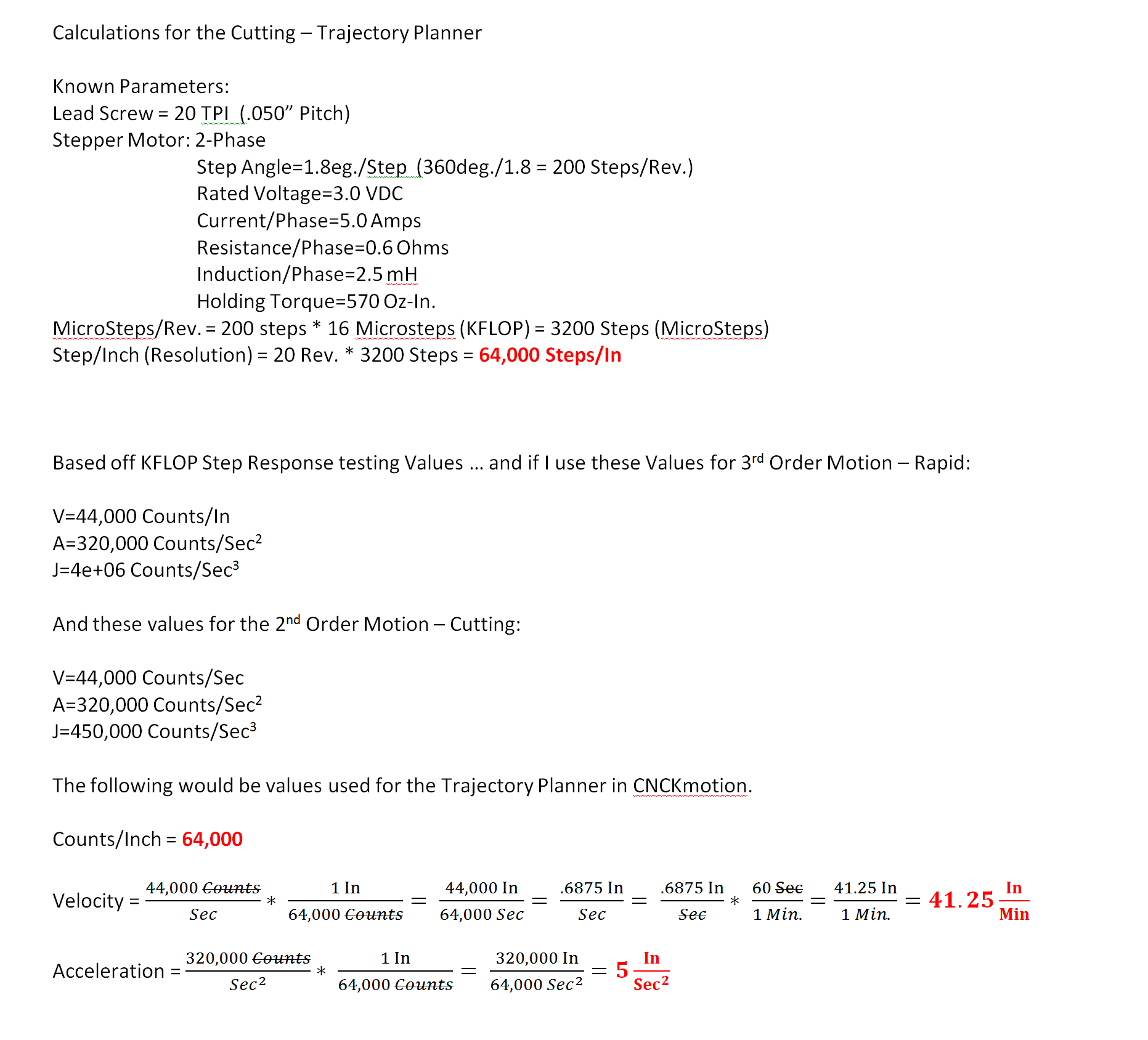

    Can I please get you to review my calculation for the KmotionCNC Trajectory Planner Perameters?
    Attachment 432162 Image LINK
    Here is the a link to the Word Doc: My Calculation for the Trajectory Planner

    J=4e+06 (If I decrease this to 4e+05 it never reaches the top V, if I increase this to 4e+07 to 08 ... it will hit V almost instantly).
    Probably reasonable values. With the lower Jerk value you would reach max V if you made a longer move. If you care about making long rapid moves quickly then lower Jerk may help you move in less time. Note lower Jerk increases the move time as acceleration is applied more gradually, but if the lesser disturbances allows higher acceleration and possibly higher velocity then the overall move time may be less.
    64,000 Steps/In seems correct
    2nd order motions don't have any Jerk limiting (Jerk is infinite not smaller) and usually require slightly smaller V and A. But these are all probably good starting points.
    Note V should be entered as 0.6875 Inches/sec on the Trajectory Planner Screen (not per minute). Or maybe 0.7. It sort of bugs me when 4 digits of precision is used for a number we are basically guessing at

    Yes ... I see that now.... I was too in-tuned with making sure my math/unit conversions were correct. Thank you for pointing out the little things that can make such a big difference when things may not be working correctly.
    Single Digits on calculation approximations .... GOT IT!

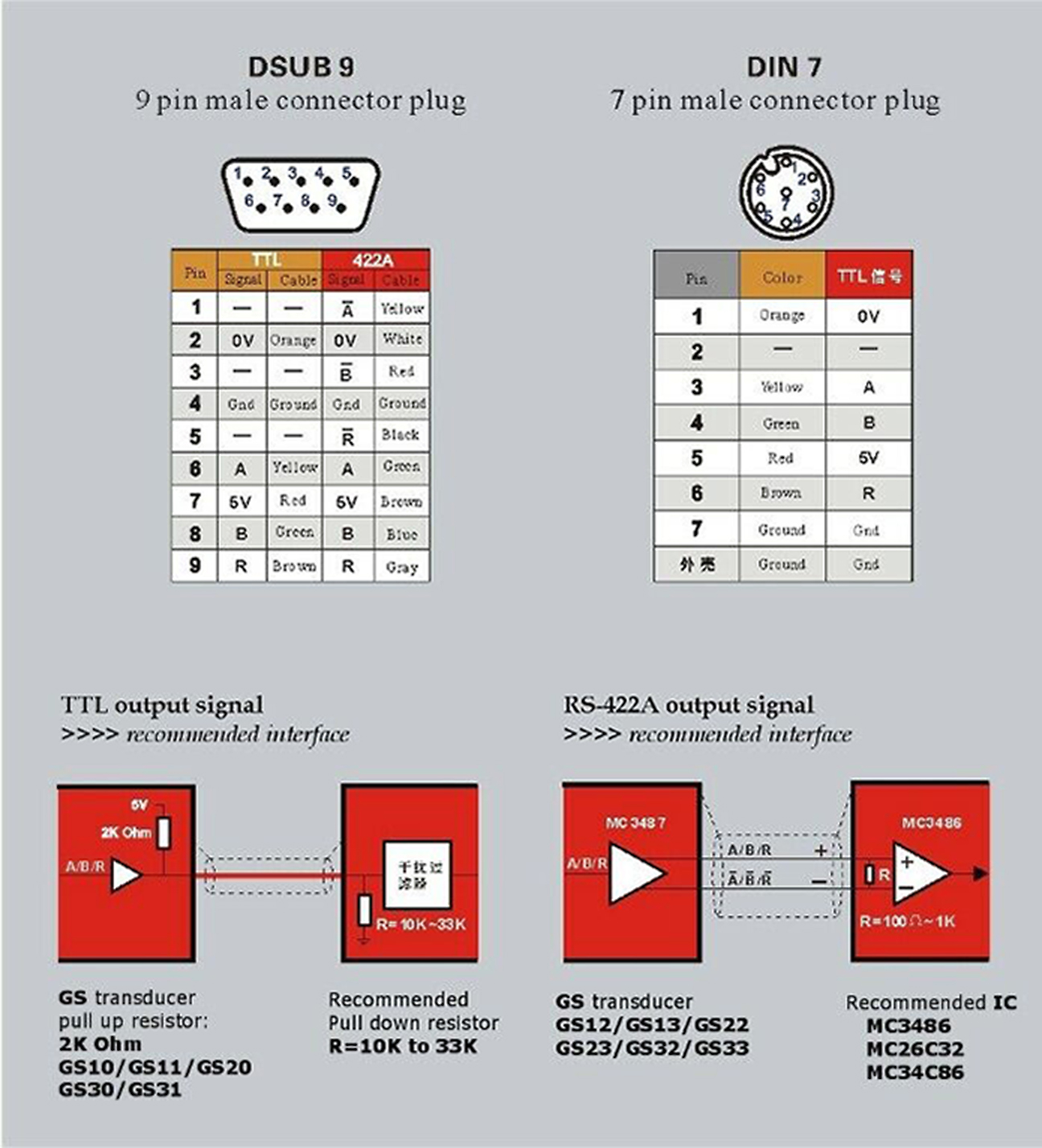

    Since an Encoder will help me understand the tuning process with feedback, I would like to add this to the bench top testing of the tuning of the stepper motors. I understand that it will need to be re-tuned once it is mounted on the machine. Plus I will gain the advantage these encoders once i get it up and running on the machine.
    I would like to purchase one of the US Digital E6 Optical Kit Encoder for testing. I know you suggested a Linear scale encoder; however, they seem to cost more then the shaft Optical Encoders.
    Am I going to see issues with using these US Digital E6 Optical Encoders on the back shaft of the stepper motors instead of the Linear Scale Encoders?
    Would something like this encoder work with KFLOP/KSTEP?
    Attachment 432216
    Tom,
    Can you please review this US Digital E6 Optical Kit Encoder and the configuration I have selected to verify ease of comparability with KFLOP/KSTEP?
    Attachment 432218 Link to PDF Specs.
    This word Doc. holds the configuration I think I should be ordering ..... Does this look Correct?
    Wow 300mm 5um resolution linear scale for $50 + shipping? I couldn't find the pinout but it says TTL/EIA422 (differential) so it should work.
    Yes it is compatible. Purchase the differential output because it can then be connected to either a single ended input or a differential input. KFLOP only has single ended inputs. If you have noise problems you can add differential inputs (Kanalog, SnapAmp, or 3rd party differential receivers).
    US Digital sells differential to single ended interface modules. See here.

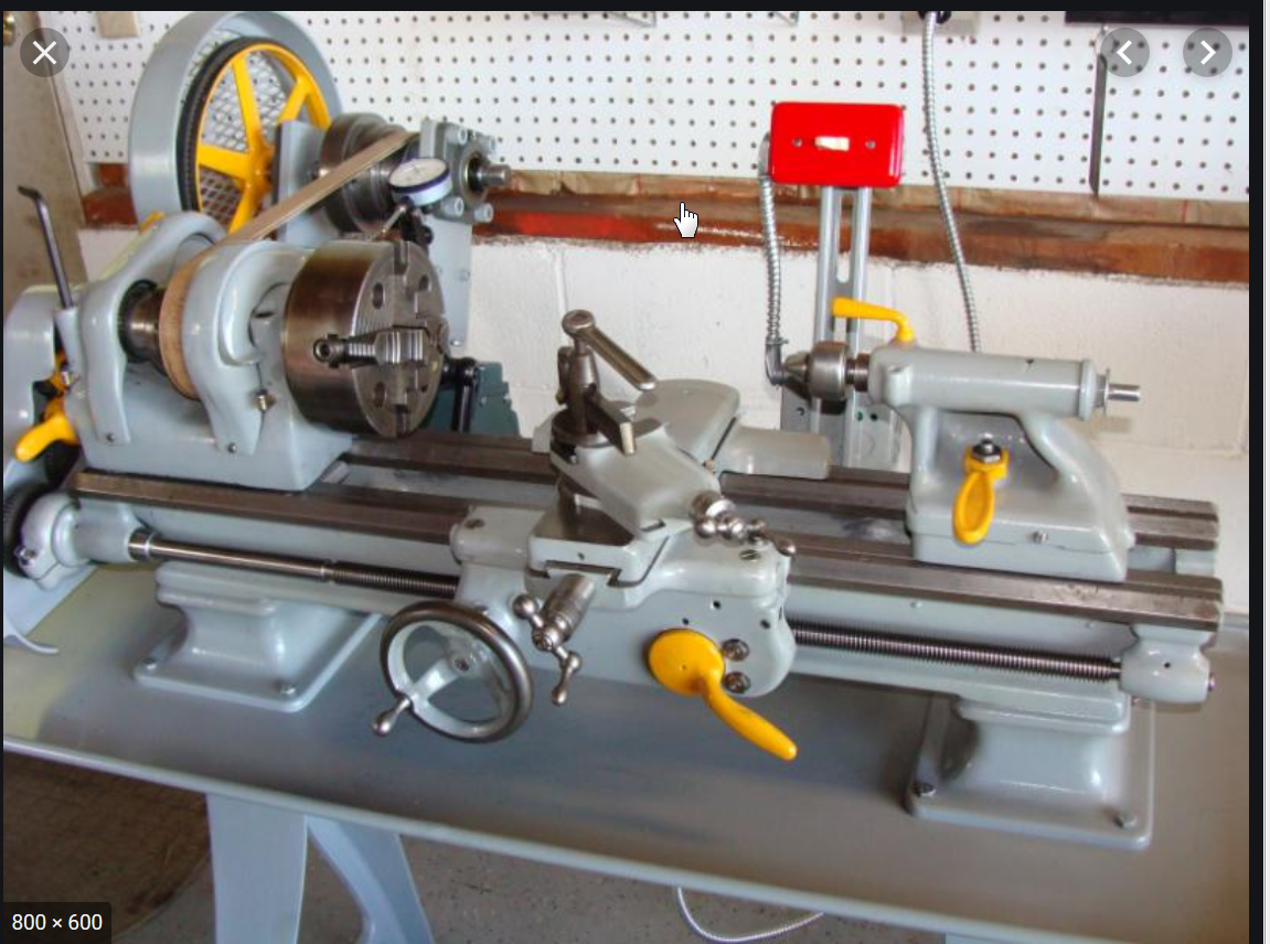

    Well here I am almost two years later, back on the this Taig CNC.
    I am really just retrofitting this Taig for fun and to learn more about KFLOP/KSTEP / Stepper Motors. Since now I have the Tree 325J to actually machine parts on for retrofitting.
    Once I learn enough with this project and the steppers, I would like to retrofit a old South Bend Bench Tip lathe with KFLOP. My lathe isn't are nice as the image link.

    Word Doc. of my Calculation for the Trajectory Planner
    Ok ... I purchased this Linear Scale Encoder for the X-axis and Here is the PINOUT
    Attachment 432398
    Quote Originally Posted by TomKerekes View Post
    Tom, Will it be easier for me to get the Kanalog board for getting the three axis connected to KFLOP/KSTEP on this project?
