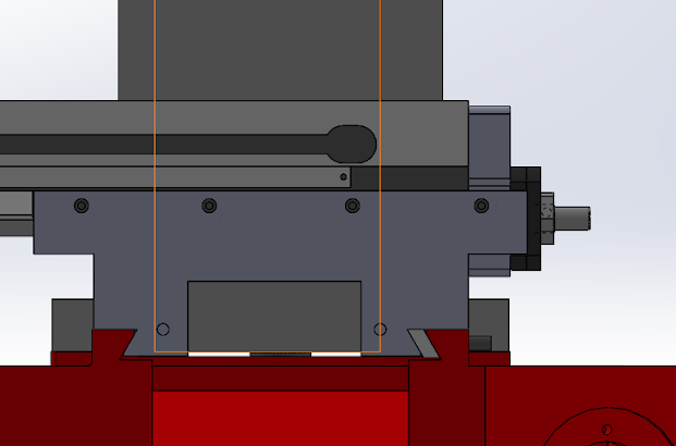

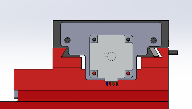

    I spent time working through Hamzter's SX3 model in Solidworks. All the mates had to be redone due to the importing. I need to do the modeling for the X3 head, but for the mean time I've left the SX3 head off as well as all the parts removed from the CNC conversion. I went and modeled the X-axis components of the CNCFusion kit.
    The hole alignment on the saddle is good and on the stepper sides it's OK, but not perfect. There is an issue with the hole alignment on the fixed support side.
    Here is the issue with the fixed support side:
    The asymmetry is on purpose, but there is an offset to the slots I measured on the kit and what's in Hamzter's model. I'll do some measuring and figure out which of us made a mistake. It could also be that there is a difference in our mills, but that isn't super likely since the other parts match up.
    There is very little clearance for the flange of the ballnut; only around 1mm on the top and bottom. That's pretty tight. The same goes for the bottom of the fixed side plate assuming you want to over-travel the edge of the ways.

    I spent time carefully measuring the worktable and found the problem. The worktable is modeled as symmetric from the left or right views. You can see this in the last picture of the previous post. In reality, the worktable is not symmetric and the ways toward the front of the worktable are longer than the ones toward the back. I don't know if this is an issue with the original model or just the import.
    Now that I have the worktable correct, I see that there is an issue with the saddle. I'll have to get this correct also before I start cutting anything.

    I've determined it's very challenging to measure the center locations of tapped holes. After measuring and remeasuring about 4 times, I think I have enough accuracy in the model that I can use it to make engineering decisions. I made the saddle over again from scratch and I modified the worktable main shape to not be symmetric as it was originally drawn. You can see the difference in the worktable by the side views from the original.
    I've only really spent time on components that effect the X-axis like the worktable and saddle so far. I'm sure there's work to be done on the rest at some point also.
    Here's how the mounting alignment looks:
    Notice that there is still some misalignment of the holes to the mounting plates of the CNCFusion kit. I believe this is real because I have to rotate the plates a small amount on my machine to get them to align and not put pressure on the screw.
    I'm done picking parts for an upgrade of this axis, but I still have to finalize on the shape of the new mounting plates and then make a final decision on whether or not to spend the money. I'll post some screen shots of the solid model of the parts I'm thinking about next time.

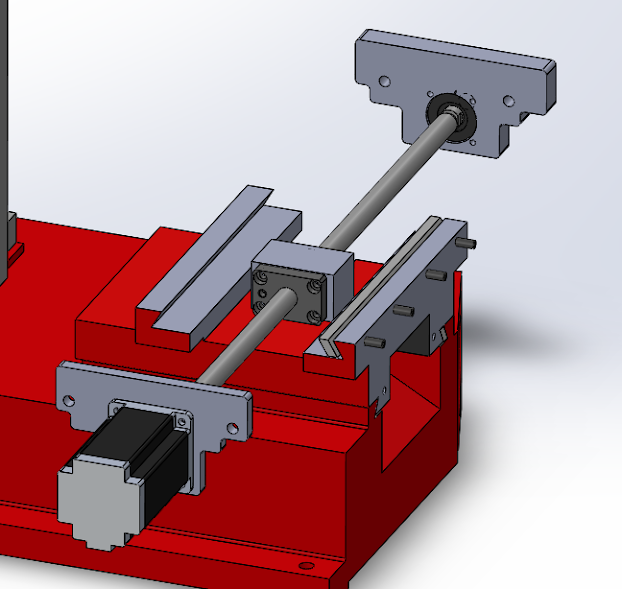

    So here's what I came up with for the x-axis:
    A few points for thought:
    - I wanted each end plate to be clean, fit in a comfortable work area when I'm cutting it, and maximize contact area with the end of the worktable to minimize tilting under load
    - I'm looking at a component fixed-side back-to-back angular contact bearing housing; it keeps the bearings enclosed to keep chips out and I never liked the press fit arrangement in the CNCFusion kit
    - the ballnut has a larger flange than the CNCFusion kit ballnut, but it should just barely fit under the saddle
    - for the screws that hold each end plate, I'm looking at a round through hole with about 2mm clearance all around; I'll have to use a quality washer, but I've chewed up the CNCFusion kit screw slots because they are too thin and I didn't want to do the same when I really tighten the screws down
    It allows each side to over-travel some distance:
    The over travel on the stepper side is limited by the stepper motor frame itself. The CNCFusion kit did not allow over-travel on the stepper side. The over-travel on the fixed side is limited by the size of the bearing housing.
    Now I just have to decide if the cost is worth while. Ha. Maybe I'll cut the plates while I think.
