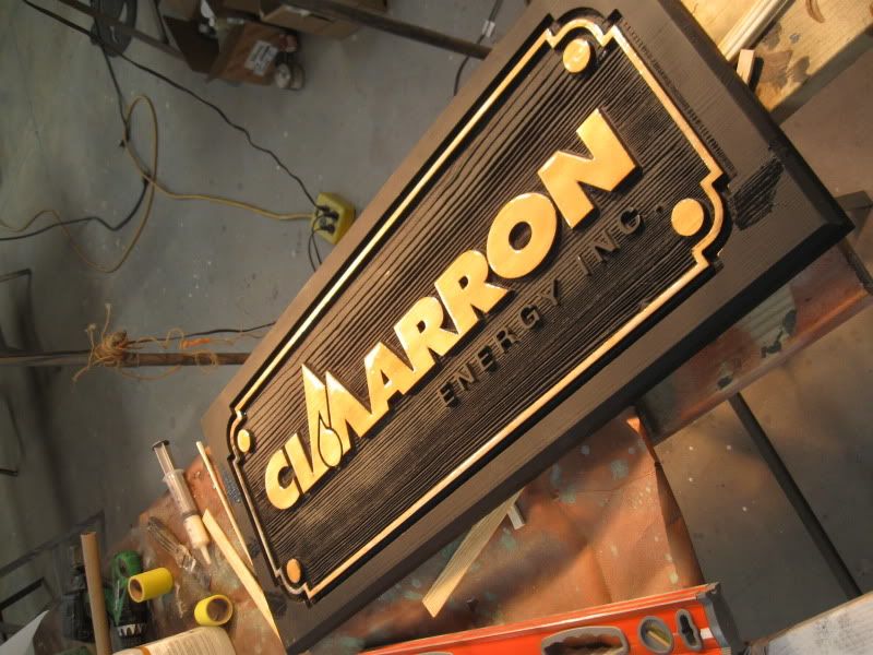

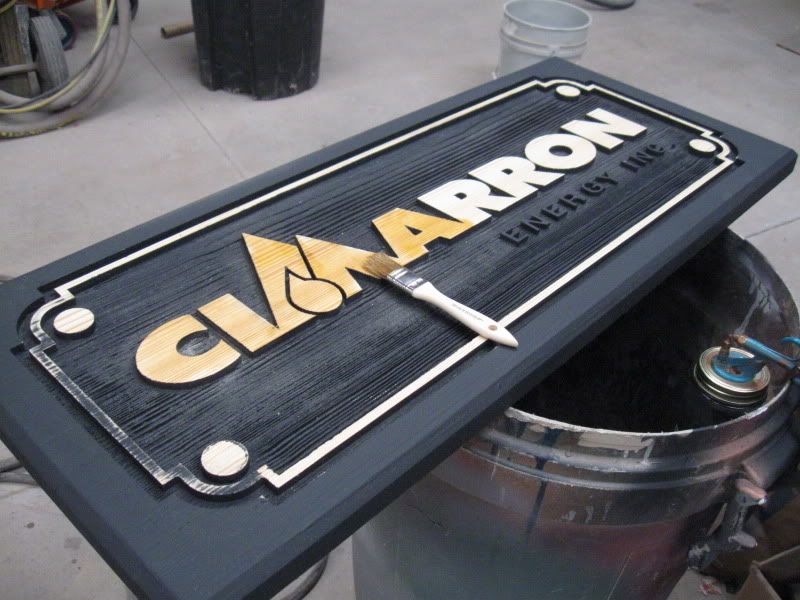

    Coming to a finish on another Pine and Gold sign

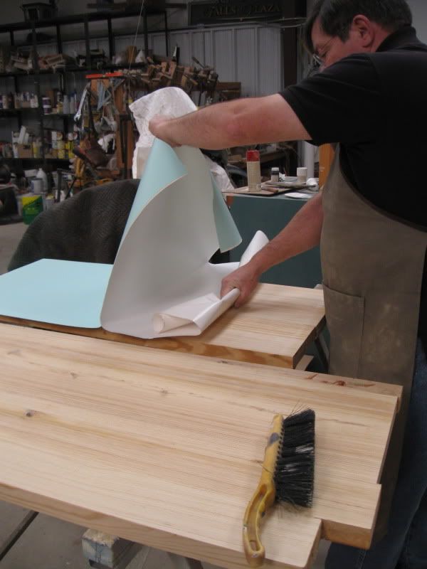

    I glued up yellow pine and Ron applied Sandblast Mask. We used the router to score it. Then an area clearance down .40
    [IMG]http://i38.photobucket.com/alb
    Although I only wanted a little texture, this material is so hard it took a little extra sandblasting.

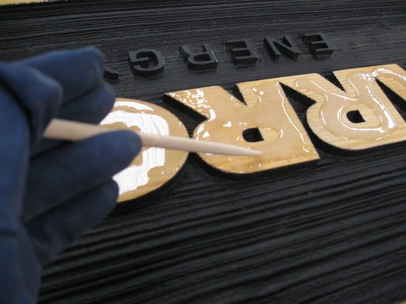

    To make a perfectly smooth surface on the letters and border I pour on epoxy and move it with chop stix. Now she's ready for gold. That's todays chore.

    With the depth already routed it out, the mask wasn't under any kind of pressure.
    I went around all the letters and trim with a 1/8" down sprial in .125 increments to .40. At that point I did an area clean with a 1/4" bit. Not much step-over. Eeeesy peesy.
