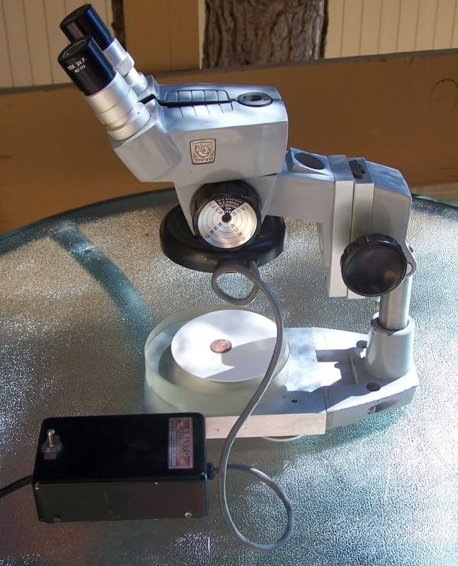

    I have spent many hours staring into the binocular eyepieces of AO & B&L zoom microscopes mounted on an air table with micro manipulators mounted DC & RF probes. Those AO & B&L microscopes with binocular eyepieces were not true stereo microscopes though since there is only a single objective. The view through the binocular eyepieces was not significantly different than the view of the CRT monitor with feed from a video camera mounted on the microscope. However the view through a true stereo microscope is like viewing a 3D movie with spacial information supplied to both eyes with a slightly different image fed to each eye from two separate objectives. I was wondering if a pair of USB microscopes could be used and the outputs from each microscope processed by DSP software to give even more spacial information than a single USB microscope.
    Here is a picture of my classic AO Spencer cycloptic stereo microscope with florescent tube ring illuminator. http://i72.photobucket.com/albums/i1...Microscope.jpg With a stereo microscope objects such as the penny shown on the stage looks truly three dimensional . BTW the classic Spencer Cycloptic stereo microscope is very popular nowadays on TV seen in both Dexter's and Grissom's labs http://www.xmission.com/~psneeley/Pe.../AOHistory.htm
