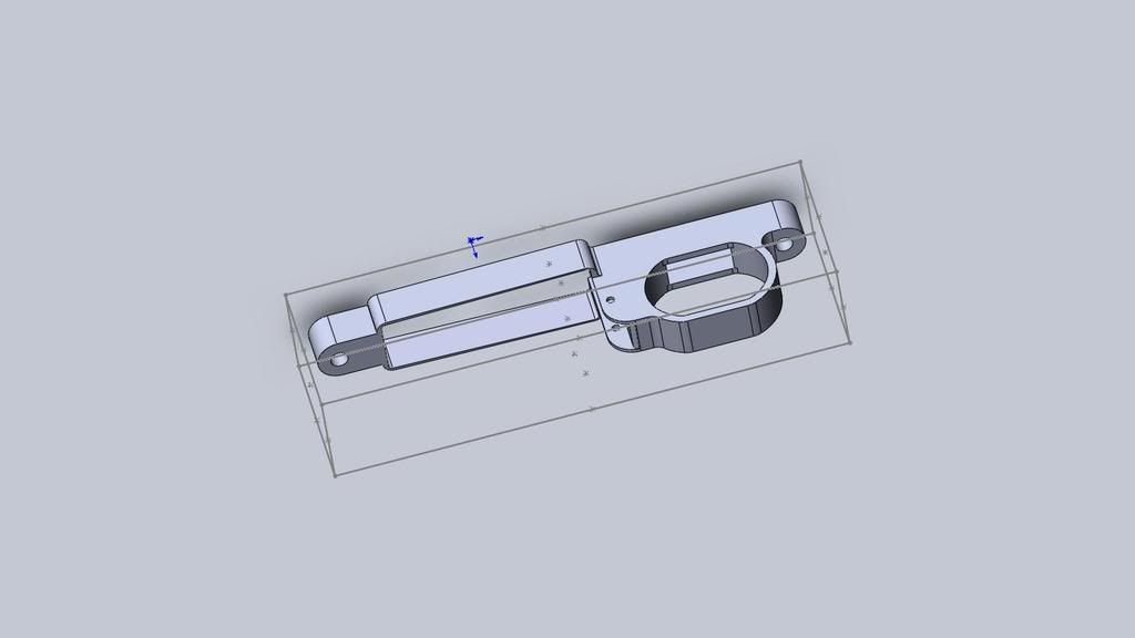

    HI all.
    I'm trying to come to grips with Solidcam.
    I have a part drawn in Solidworks and have playing with different ways of machining it on a 3 axix machine.
    I think I have come to grips enough with it, but would like the input from others are to how YOU would do it.
    As in what type of operation etc
    The other question is, for a newbie to CAM is Solidcam the best prog to use or is there something easier for what I'm trying to acheive?
    Thanks

    Wow, that is a big question. First of all, what material is it and do expect to machine the wholw thing on your 3 axis machine? The aperture with square corners will prove very hard to machine because round tools do not make square corners unless end on, so it is either radiussed corners, a right angle head or a subsequent broaching operation. Similarly with the channel behind the large aperture.
    The sequence on machining will be critical as the part will not be very strong (in machining terms) after that big aperture is machined.
    As for software, thay are all much the same in terms of machining operations available. Think of CAM software like cars, they all go from A to B, but some get ther quicker, some are more comfortable, some are easier to drive and some are not much better than a plank with four wheels and a clockwork motor. No software will make cutting this part easier, just easier to program. What will make cutting this part less troublesome is a lot of thought into the order of operations, how many release & repositions and most importantly, how are you going to hold it.
    For myself, I would start with a block of material considerably bigger, square off the back face and drill the end holes all the way thro. Release and reposition onto a fixture that secures the part with the holes just drilled and machine the oval aperture and its face together with the other end face to depth. Release & reposition on the same fixture but wwith the otherside uppermost and face the same faces to depth. Profile the nearest edge.
    R & R to an new fixture, machine the big aperture, drill & mill the square aperture leaving some on for the broach. Last kob of all wouls be to profile the side of the big aperture. This is a very sketchy production planning layout.
    Good luck

    Thanks for the reply.
    This is an intermediate drawing,(fianl is on another machine) the final product has radii inside those areas, so no broaching required, and the outside wall thickness of the large opening is thicker, so that fixes those probs hopefully.
    I should have mentioned it will be out of aluminium, total length is approx 190mm from memory.
    I drive machines manually, just not by CNC yet and that is about how envisioned doing it - thanks
    What I'm lookig for I spose, is opinions on whats going to make itemslike this easier to program paths for.
    Solidcam is very good, but is there something thats going to make that side of the job easier, or is it a suck it up and learn it down pat?
    Should I be focused on doing as much in 1 operation as possible, or just getting it done in more smaller ones?
    Thanks for your reply again
    Matt

    Based on my image above, what processes would you use?
    I've been doing the top side as a test - Roughing using a HSM operation with say 1/2 EM and then finishing with 1/4 BEM (let alone no profile )
    Am I close? Seems to be a long winded operation (the small stepover 3d work) I'd presume a couple of hrs on the machine?
