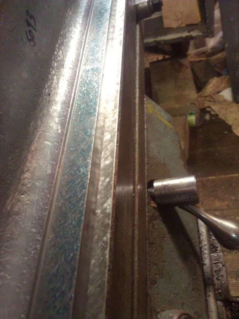

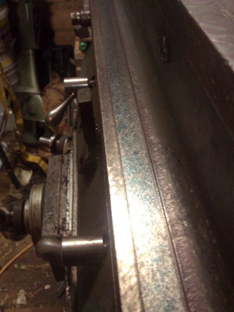

    been working on my old Logan lathe all summer making sure I get it right.
    these are of the Logan lathe bed flipped upside down on my mill. Makes it easier to move it around to where I need it.
