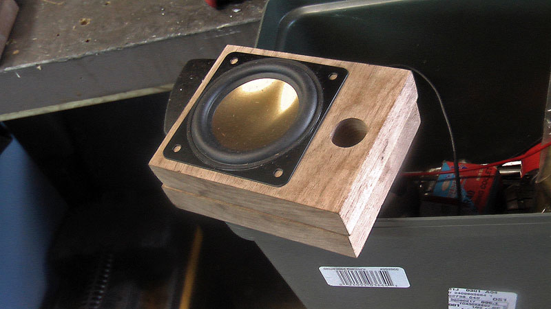

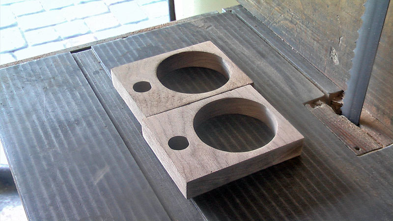

    Update:
    Well, I made my first actual parts: 2 face pieces for a set of speaker cabinets that will form the front of the speakers. I cut out wood because I needed to build some cabinets for some time + I figured I would be less likely to break another carbide bit on wood. Pretty simple but both cad and cnc are new to me and learning to draw in cad/cam, set stock size and machining origin is what these simple parts represent. I will use cnc to cut out the other sides and to round the cabinets + cut wiring terminal holes. The parts came out identical and the software even cut holding tabs for the outside rectangle to hold the part from rotating while being cut out. FYI, everything was done in cambam.
    Video:
    Finished parts:

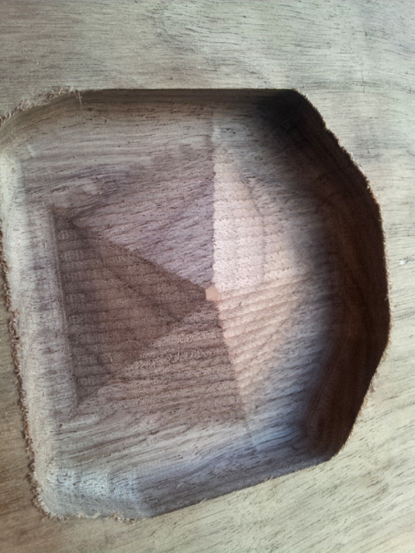

    On that note, I was finally able to make something in 3 dimensions. I drew a 5 sided pyramid in ViaCad Pro and actually got it to come out as a part. Learning this side of things is proving more challenging than converting the mill to cnc as well as finding useable cost effective CAD/CAM solutions.
    I am learning Viacad pro 7 as it is fairly robust 3d for $250 and not $2500 like a solidworks. Definitely demo before spending any money. I currently demoing Mesh Cam and Cam Bam and got both to make useable stuff. Mesh Cam does real 3d and I actually got it to make th part above without reading any manuals etc.
    If it is any help to anyone wanting to understand steps to making a part via cnc, here is my workflow using "cheap" options as a cnc "newbie":
    1. ViaCad Pro 7 for cad design
    2. Export as STL
    3. Open with Meshcam
    4. Setup machining parimeters and generate tool paths
    5. Export gcode
    6. Open gcode in Mach3 and zero
    7. Cycle start

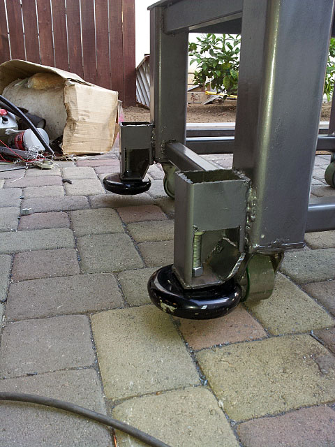

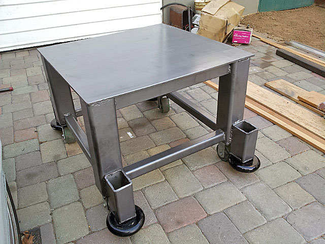

    I ended up making a new stand for the PM45 CNC mill conversion. The other stand was solid but would rock under rapids and was too tall for where I am going to put the mill with the flood enclosure I am making. If you are doing one of these conversions, make sure you build a good stand with leveling feet that can handle the momentum of the table, especially during rapids.
    Here is the old stand:
    The new stand is 4" x 4"x 1/2" thick tubing with 2"x 2x 1/4" thick crossmembers. The top is 3/8" thick 30" x 30" and weighed 96lbs by itself. All in all, I got 422lbs worth of steel from the rems pile at industrial metal supply at 68 cents a lb.
    I added 6" steel casters and it rolls really nice even though it is over 400 lbs. Added Barrymount Leveling Mount LM5-B isolation pads that are 6" diameter and weigh over 5lbs each. they are offset the wheels so you can roll the mill around and then level the table after you get it where you want. I will be mounting the flood enclosure on top of the stand.
    Pics:
    retractable levels:
    It was a pain cutting that much thick steel. Plasma cutter got a workout. Thanks for looking...

    Just out of curiosity, what are the heights of both stands (old and new) from the ground?
  17. #57
    Join Date
    Mar 2010
    Posts
    156
    Quote Originally Posted by skippy View Post
    The original stand is 30" tall that I made and the new one is 23" tall. With a manual machine you are standing and cranking all the time and you don't do that with the cnc. The other thing is lower center of gravity is better.
