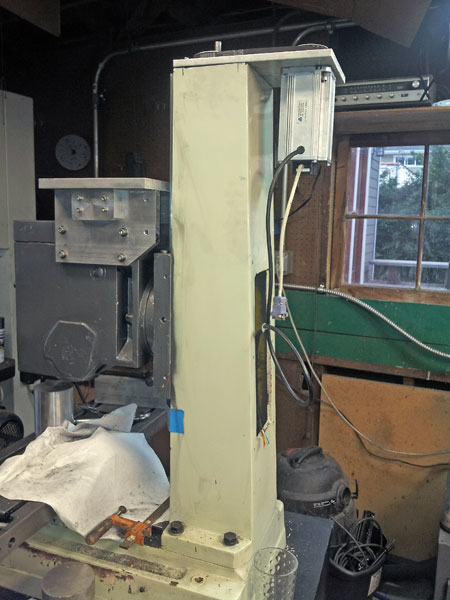

    I made a little more progress on the motor mount. Given the size and extra power, I wanted a really stout mount. The horizontal plate on top will bolt to the motor and pivet to adjust the belt tension. The top plate is bigger because the motor diameter is 2 inches larger than the with of the head. I will make the pulleys now I just got my 8 rib poly v belt from Mcmaster Carr. Here is the basic layout:
    side view:
    Thanks for looking

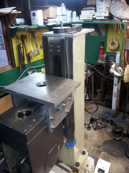

    update:
    I now have all three axis done, motor mount and cerakoted the parts sniper grey to match the hammered grey finish i painted the mill. I am looking forward to assembling it and start things moving finally. This was a bigger project than I thought
    Parts ready to go back on the mill:

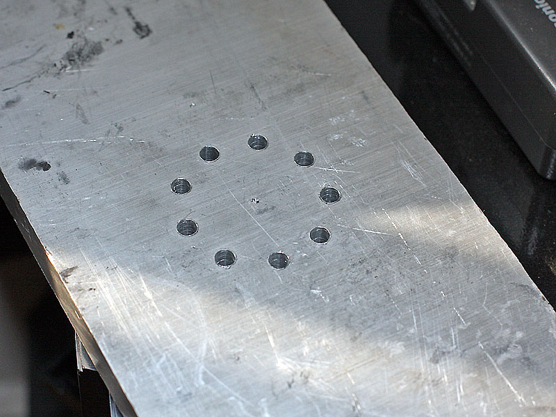

    update: first chips video!
    I finally got all 3 axis working and spindle control. I still need to properly calibrate things but things are finally working.
    Here is a video using the mach3 circular hole wizard to drill 9 holes:
    Finished:

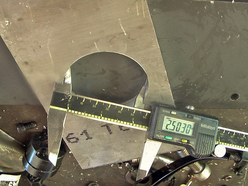

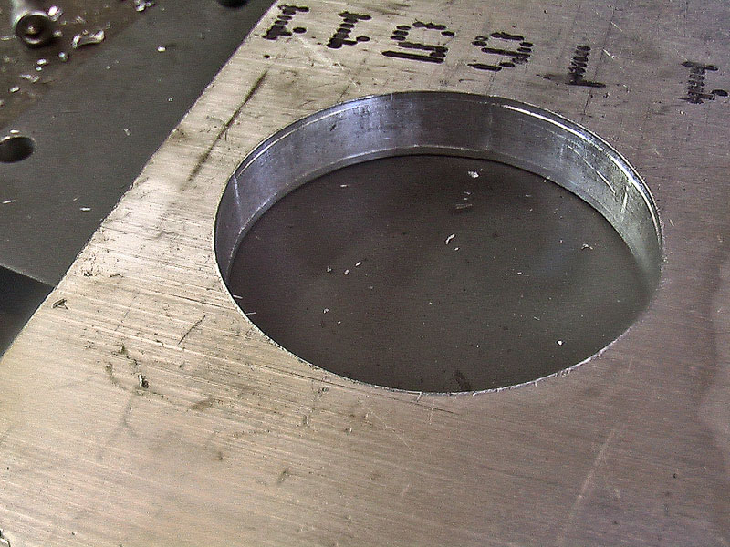

    Update:
    I installed my DRO back on the machine and recalibrated things. MUCH better. I still have to play with backlash compensation but the mill is finally starting to cut half way decent.
    Here is a video cutting a 2.5" circle through 1/2" thick 6061:
    Finished:
    Measured:
    Not perfect but getting there. I measured 2.4845" at smallest and 2.5030" at widest point without use of backlash compensation.
    At least the hole is roughly 2.5" and not a full oval any more. Calibrating the steps over the full length of travel made a huge difference.
    Any suggestions would be appreciated.
    Thanks for looking
