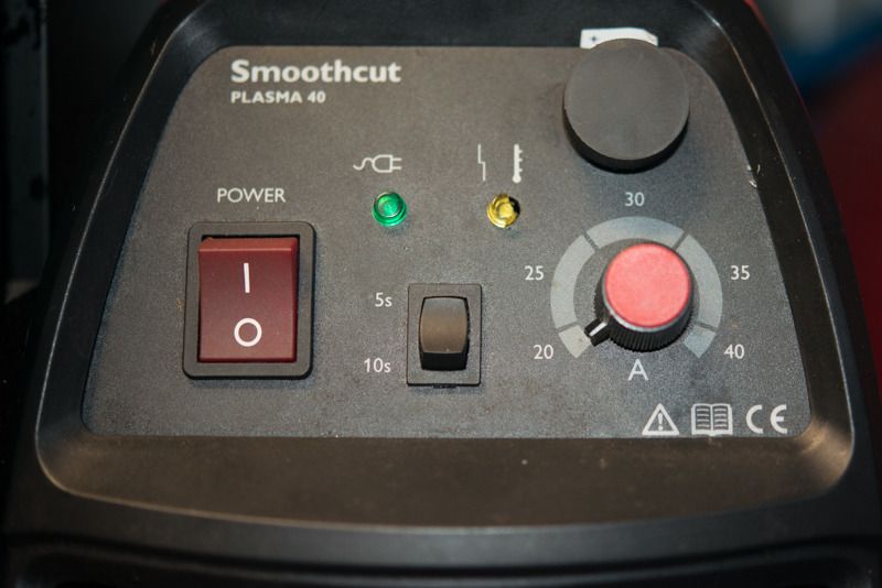

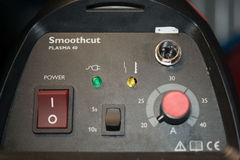

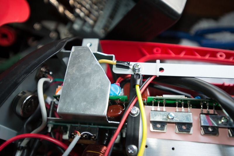

    Mikie, the better plasma cutters have one built in but the cheapies (like mine) don't. The purpose of the voltage divider is to reduce the voltage on the Plasma electrodes to a measurable level. Typically the divider is 20:1 or 50:1. eg. at 50:1, 100 volts on the arc is reduced to 2 volts. Not sure what this card divides by.
    Anyway, I have not got much done. The socket for the voltage sensor on the plasma has turned up, I've also got a replacement power supply on hand. Decided to go with a 24 Volt power supply as the THC controller has a 5 volt output for breakout boards.

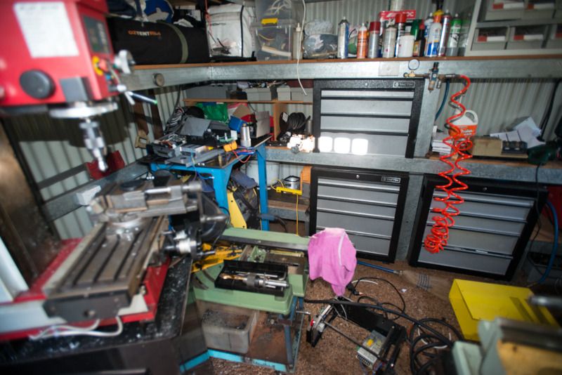

    I can't move in my tiny shed so I have to get the plasma cutter and controller box back together and reclaim some space. Then I'll work on the Z axis which will take a while at the pace I've been making.

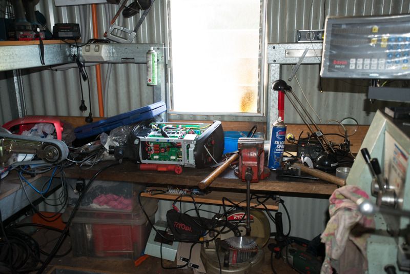

    Anyway, this weekend, started with closing up my plasma cutter. Had to snip off a bit of the brackets that fouled the case
    And then it went together nicely. 2 pins for the voltage divider and a third for the earth shield.
    And following feedback on this thread, I decided to make a cap to keep the contacts clean if in manual mode.
    Only took a few minutes on the lathe and let the thread on the connector to cut a thread in the Acetal (Delrin) cap.

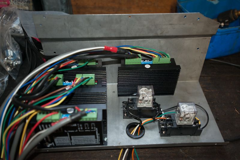

    Then spent the rest of the weekend wiring up the stepper controllers and 24 volt relays for the THC
    For the Aussies, I bought the relays from Jaycar and chose this style because they looked the same as the ones in the THC manual
    The black Relay base is designed to mount to a DIN rail but also bolt on and the relays just clip in.
    I also mounted up a Meanwell 24 volt power supply which is a drop in replacement for the 12v/5v dual rail supply so no modifications to the case was necessary . Happy about that.
    So I think this layer of hardware is complete. The 48V and 24 V power supplies mount above this and the THC and break out board will be on a layer below this one.
    My friend Chris kindly provided me with some high quality shielded 4 core cable. He tells me I owe him a carton off beer now. I'm using 5 pin connectors so that the shield can pass through the case. Still waiting on an order to turn up. the colour coded wires came from a left over length of 7 core trailer wiring cable. Need a bit more for one more axis. I used this becasue it was heavier than the hookup wire I have here.
    The relays are to turn the Plasma torch on and to trigger an ARC-OK signal at the Breakout Board. I am assuming I just need to run 5 volts through the relay for this one.
    I still have to make some mounting plates for all the sockets and decide how it will all go together.

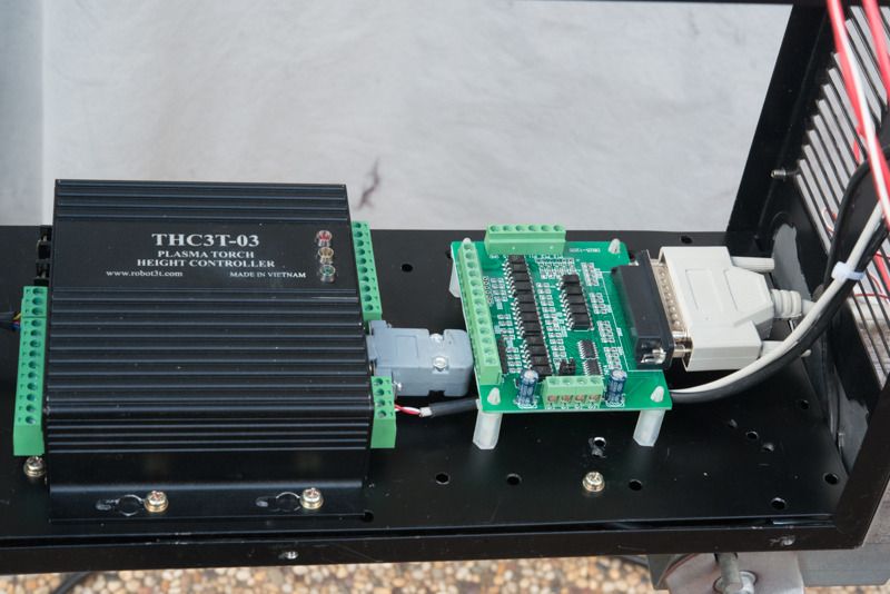

    I figure if I don't do a bit each weekend, I'll never reclaim my shed so I manged to mount up the THC controller box and the Breakout board
    It's not shown, but the DB25 cable passes though a rubber grommet to the outside world though matching slots in the face plate and case.
    I thought about making a start on the wiring but did not have enough time to get it done today so decided to tackle it another day. I did spend a bit of time getting my head around which pin on the BOB does what in Linux CNC though
