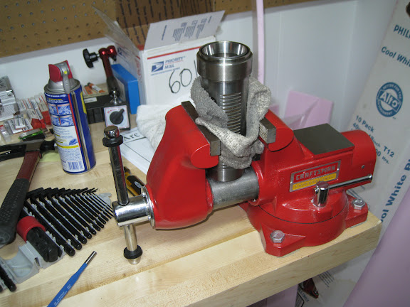

    The bearings came in today so I was excited to get the spindle reconstruction started.
    https://lh4.googleusercontent.com/-w...6/IMG_1345.JPG
    https://lh4.googleusercontent.com/-x...6/IMG_1346.JPG
    https://lh4.googleusercontent.com/-D...6/IMG_1347.JPG
    The 6007 bearing for the spline gear at the top is filled with blue grease. It is super smooth, but takes a lot of force to turn. I don't know if its really a problem or just different then what I'm used to. Thoughts anyone? It looks like it might be packed tight with that grease.
    https://lh4.googleusercontent.com/-c...6/IMG_1348.JPG

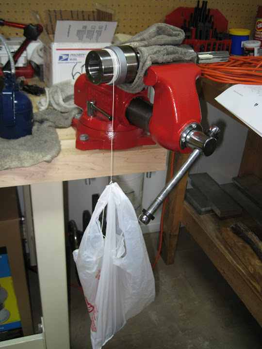

    So it was time to try to get the bearings on. 'Try' is the operative word. The 6007 went on fine after heating the bearing in the oven and putting the shaft in the freezer. Here you can see it on my precision coaster:
    https://lh4.googleusercontent.com/-6...6/IMG_1349.JPG
    The race for the lower taper roller bearing did not go so well. I put the race in the freezer and heated the quill in the oven to 350F. I tried to press the race in with my hands and it went in a little and got stuck there. Exactly what I was afraid of. Very frustrating. I think I can try again though. The race is so far up near the end of the quill that I should be able to use some 3 arm pullers to remove the race and start over. Anybody have ideas on how to do better next time?
    You can see the race here stuck at the end of the quill.
    https://lh4.googleusercontent.com/-Z...6/IMG_1359.JPG
    After that 'issue' I went to put the spline drive shaft and bearing back in the bracket to find that they don't fit easily. I guess I need to try the oven trick again, but I am not very confident since the bracket is not precision machined. It could be narrower by a good margin. I have a small arbor press so I could also try that if I find the right jig to push just on the outside of the bearing.
    https://lh6.googleusercontent.com/-K...6/IMG_1351.JPG
    https://lh5.googleusercontent.com/-C...0/IMG_1352.JPG

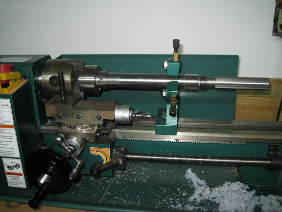

    I figured I could polish the races on the spindle today as well. It just barely fits on the 7x12 lathe, but I got it on there. I spent quite a while with 220 grit emery paper and didn't make much of a dent in the diameter. My calipers say I need to take about 2mils off the diameter, but after 45 minutes of work on one of the races, i might have gotten off 1mil. Hard to tell. It did get nice and shiny though. I think the problem is this paper gets loaded with debris way too quick. I'll try something less fine tomorrow; maybe 100ish. It does not help that when I go to test fit the bearing on, it always gets stuck and I have to fight to get it off each time.
    https://lh4.googleusercontent.com/-j...6/IMG_1353.JPG
    https://lh5.googleusercontent.com/-C...6/IMG_1354.JPG
    https://lh5.googleusercontent.com/-G...6/IMG_1355.JPG
    Here are some pictures of where the machine is now. Basically back in one piece except for the spindle area.
    https://lh3.googleusercontent.com/-4...0/IMG_1356.JPG
    https://lh3.googleusercontent.com/-4...0/IMG_1357.JPG
    https://lh4.googleusercontent.com/-p...6/IMG_1358.JPG

    Ah.. yes bearings can be pretty tricky sometimes.
    Did you check to see if the quill had actually gotten above 200-250?
    A small infrared thermometer comes it quite handy for stuff like this, but you have to be careful as most all cheap ones do not have an adjustable emissivity setting, they dont normally read well on shiny surfaces, so just color a 1 in spot with a sharpie to take readings off of.
    The reason I say this is I know the oven I use for powder coating is quite a few degrees off, had to spend some time calibrating a new temp range for the powder coating.
    Your 6007 bearing, you can remove the seals and flush out the grease and re-pack with your Kluber, but its not really necessary at the speeds these spindles turn.
    If heated properly the races and bearings should just fall into place, but you have to work quickly. Just press the upper in with your arbor press.

    Last night I pulled the stuck lower bearing race out. It went pretty easily. Luckily, it didn't get in very far on the first try so there was a lot of room to get the pullers in.
    https://lh3.googleusercontent.com/-v...6/IMG_1360.JPG
    https://lh3.googleusercontent.com/-l...0/IMG_1361.JPG
    I lightly polished the inside of the quill for the next attempt and stuck it back in the oven.

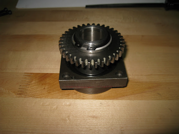

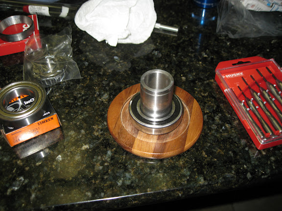

    Meanwhile, I worked on getting the spline gear bearing (6007) back in the bracket. I followed cornbinder's advice and just pressed it in with my arbor press. It went pretty smoothly when I found some suitable standoffs. I think this was about the limit for this press; I doubt a 1/2t press would have worked. Anyway, this section is back together and ready to be put back on the head.
    https://lh3.googleusercontent.com/-z...0/IMG_1362.JPG
    https://lh4.googleusercontent.com/-O...6/IMG_1363.JPG
    https://lh4.googleusercontent.com/-I...6/IMG_1364.JPG
    It was time to try the lower quill bearing race again. This time it worked and I think it's set properly. Finally! The first time I tried using the race only and pushing it which might have led it to get misaligned. This time, I used the inside ring to push down and I think it applied the force more evenly, but it did still take some strong pushing before it popped in place. Make sure to cover the top of the bearing in a thick towel though, that quill is hot.
    https://lh5.googleusercontent.com/-b...6/IMG_1365.JPG

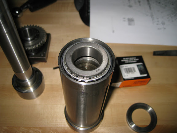

    I was getting ready to put the bearing in the top of the quill when I noticed something. The top of the quill is stepped, and somehow I don't remember it being like that.
    https://lh3.googleusercontent.com/-3...6/IMG_1366.JPG
    The lower step fits the original thrust bearing, then a washer and the upper step is for the deep groove ball bearing. Here's a picture showing the thrust bearing in place.
    https://lh4.googleusercontent.com/-p...6/IMG_1367.JPG
    My plan was to replace the top thrust bearing / deep groove ball bearing combination with a single tapered roller bearing. This is mostly for a future power draw bar because that tapered roller bearing can take some force. Even if you don't do a power draw bar, it seems like a better way to go since you are going to be pre-loading the spindle in the quill and hitting the spindle with a mallet to get the tool out all the time anyway.
    I was expecting the roller bearing to be shorter then the combination of the two original bearings and I would need to put some shims (washers) to get the level up to the threads for the locking nut pair. Luckily I think the plan will still work; it's just that the new tapered roller bearing sits in the top step and is raised above the level I expected. Here is a picture of me placing the old, original tapered roller bearing into that top step to estimate the height. It sits about 2mm above level with the top of the quill. The new bearing won't sit that high because the outer race of this one has welds all over it from the removal process, but its close enough for an estimate.
    https://lh6.googleusercontent.com/-a...6/IMG_1368.JPG
    https://lh3.googleusercontent.com/-n...0/IMG_1369.JPG
    I did a little more measuring and put the quill in the oven. I finished polishing the spindle journals on the lathe. I ended up using mostly 80grit emery cloth; it still took a long time. Be sure to let the journals cool before test fitting.
    https://lh6.googleusercontent.com/-X...0/IMG_1370.JPG
    I got the upper taper roller bearing race in the quill. It took two tries again. This time I know the problem was that it didn't start going in strait. Here it is in the top of the quill. It looks like when the rest of the bearing is together it sits approximately 1mm above the top of the quill. I think it's going to work out nicely.
    https://lh6.googleusercontent.com/-i...6/IMG_1371.JPG
    Here's all the spindle parts waiting to be put together. It's time to grease the roller bearings and final assembly. I need to get this thing spinning again and see if it was worth it.
    https://lh5.googleusercontent.com/-T...6/IMG_1373.JPG

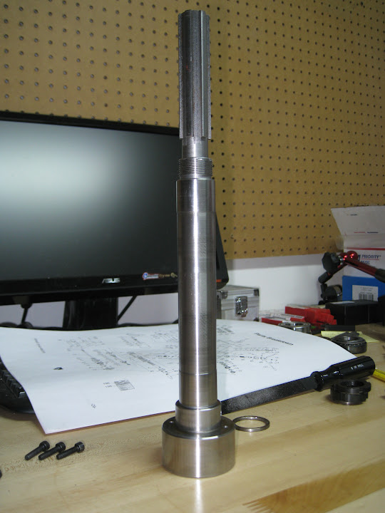

    I reassembled the quill and spindle. It went pretty smoothly. I packed the tapered roller bearings with the Kluber grease trying to fill 50% of the available volume.
    https://lh5.googleusercontent.com/-8...6/IMG_1375.JPG
    https://lh5.googleusercontent.com/-6...6/IMG_1376.JPG
    https://lh4.googleusercontent.com/-b...6/IMG_1377.JPG
    https://lh4.googleusercontent.com/-M...6/IMG_1378.JPG
    https://lh3.googleusercontent.com/-E...6/IMG_1380.JPG
    The new bearing in the top of the spindle sits about 1mm past the top of the quill. I'm using the washer that was just beneath the c-nuts and it seems to fit about perfect.
    https://lh6.googleusercontent.com/-I...0/IMG_1381.JPG

    The only real tough part was getting the spring back on and tensioned correctly. Here's a tip: use a large set of circlip pliers to grip the spring cage by those 2 holes. Then you can wind the spring back to your liking with little issues. First I tried using big pliers like the preparation guide shows, but that wasn't working well.
    https://lh5.googleusercontent.com/-D...6/IMG_1387.JPG
    Something interesting:
    The spindle is much harder to turn by hand now then it was. I may have pre-tensioned it more then the factory did. Also, the grease I'm using is much thicker than what was in there before. It might settle and spread a good bit too. It is nice and smooth though, so I'm going to leave it for now and see how the motor handles it. I can back off the pre-tensioning if I need to. I think I'd rather have the motor work harder and have less vibration in general though.
    When I first turned it on, there was a nasty noise. I'm fairly sure it's in one of the gears. I think its either the spline gear or the 2 metal main drive gears on the top of the head. I'll pull the spindle assembly tonight and just run the gears to see if that's where the sound is coming from. The main drive gear that powers the spline might have taken a bang during disassembly. Hopefully I'll be able to find a little dent and file it out.
    I'll probably post a list of the parts and specialty tools I used to do this bearing change next time. In case anyone else is thinking about it.
    TK

    It's been running since I got it reassembled. I have only cut one piece since then; about a 1.5 hour job. I measured the run-out with a dial indicator and it looks to be about 0.00025". My finest dial indicator is only 0.0005" per tick, and it moves about half a tick. I would need a better indicator to get a better measurement, but I think it's probably an acceptable amount of run-out and I don't think I messed up anything badly with this whole endeavor. I wish I had measured the original run-out though... can anyone out there fill me in?
    The noise and vibration has gone down at higher speeds. I still believe it's the two big toothed gears on the top of the head. I guess whatever little dent I put in one of them has worn down. Either way, I'm not very concerned about it since I am going to be replacing those with a timing belt soon and I don't think the vibration is enough to be affecting my cuts right now.
    An annoying detail has been that I have not gotten the force on the quill spring where I want it again. There is a tab bent into the quill spring where it engages on the quill bar shaft. On mine, it seems to have unbent so it is tough to get it to engage and get the tension correct.
    A more substantial problem is that the head is getting very hot. After about an hour of pretty light cutting, I could hold my palm to the machine head for only about 15 seconds before I had to remove it. My guess is that I have too much pre-load on the spindle. I have noticed that it is quite hard to turn by hand even without the motor engaged, but it's very smooth. One of these nights I will remove the quill and back off the pre-load nuts. At this point, I should be about to do that in about 15 min.
    Other possible causes are that there is a problem with the bearings. I don't think this is likely because the motion is very smooth feeling so they probably are not misaligned, and the run-out isn't bad. I was careful not to get debris in them when installing and packing. I doubt I over packed them with grease; I was careful to pack 30-50% of the volume. The 6007 bearing came packed from the factory and I will assume they put in the appropriate amount. The two tapered roller bearings are open on one side so if I did manage to over-pack them, it should have squished out a bit.
    I did a tear-down and tune up on the machine in general. I am no longer satisfied with my ~3mil of backlash. I should probably spend some time tracking that down. I am using the CNCFusion premium ballscrew kit. My first guess is the helical couplers are the largest contributor. Any recommendations on what variety I should be using?
    In other news, I am making progress in selecting a motor/controller upgrade. Right now, I am trying to figure out how best to get more power into my garage. My garage's normal 120V, 15A breaker is probably going to be stressing when I make this upgrade.
    TK

    I removed the spindle from the machine.
    https://lh4.googleusercontent.com/-D...6/IMG_1411.JPG
    First, I verified that the weird vibration is the two main gears on top of the head. I will be removing them both soon so no big deal. I probably damaged a tooth when I was removing the 6007 bearing from the spline drive gear. I looked for any obvious damage, but don't see any. I can't really feel the vibration but I can definitely hear it.
    Next, I did a test to find out approximately how tight my spindle is in the quill. I don't have anything resembling proper equipment for this sort of test... I took a piece of 30 gauge wire and wrapped it around the spindle and tied the other end to a plastic bag. I added coins to the bag until the spindle unwound. Then I used a kitchen scale to weigh the bag.
    https://lh6.googleusercontent.com/-U...0/IMG_1412.JPG
    The first test bag measured 2lbs and 14oz. The spindle is 58mm in diameter so that should be about 40oz-in. Did I mention it was tight? It's actually easy to move by hand at that level, but is noticeably tight. I readjusted the pre-load nuts and that bag weighed 6oz or about 5oz-in. Both of these measurements are just the spindle/quill assembly and dont include the spline drive bearing or gears or motor. It's a real pain in the ass adjusting these c-nuts by the way.

    If you are going to do work on your bearings, can you do a similar test so we can see how much torque it takes to move the spindle with a factory pre-load?

    my hat is off to you for thinking of the bag trick to measure the tension! very smart idea.
