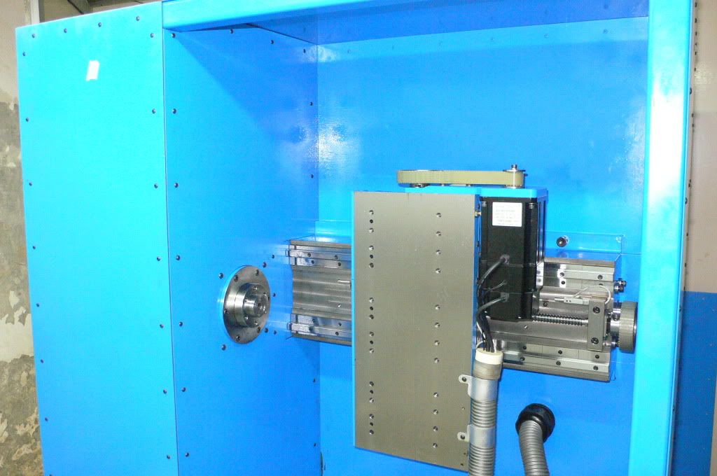

    Here is my lathe, but no slide cover yet.

    very lovely color monkey king,
    Are you plannning to cover the balscrew and lm guides also?
    Will you be using a turret on it?
    and is this your first cnc project or any other prior achivements?
    btw good job, keep it up.

    Jasminder,
    Yes, slide will have cover.
    No turret on this lathe, since I design it as vertical gang lathe.
    Also I know nothing about turret, how to control it.
    This is my first cnc machine project.

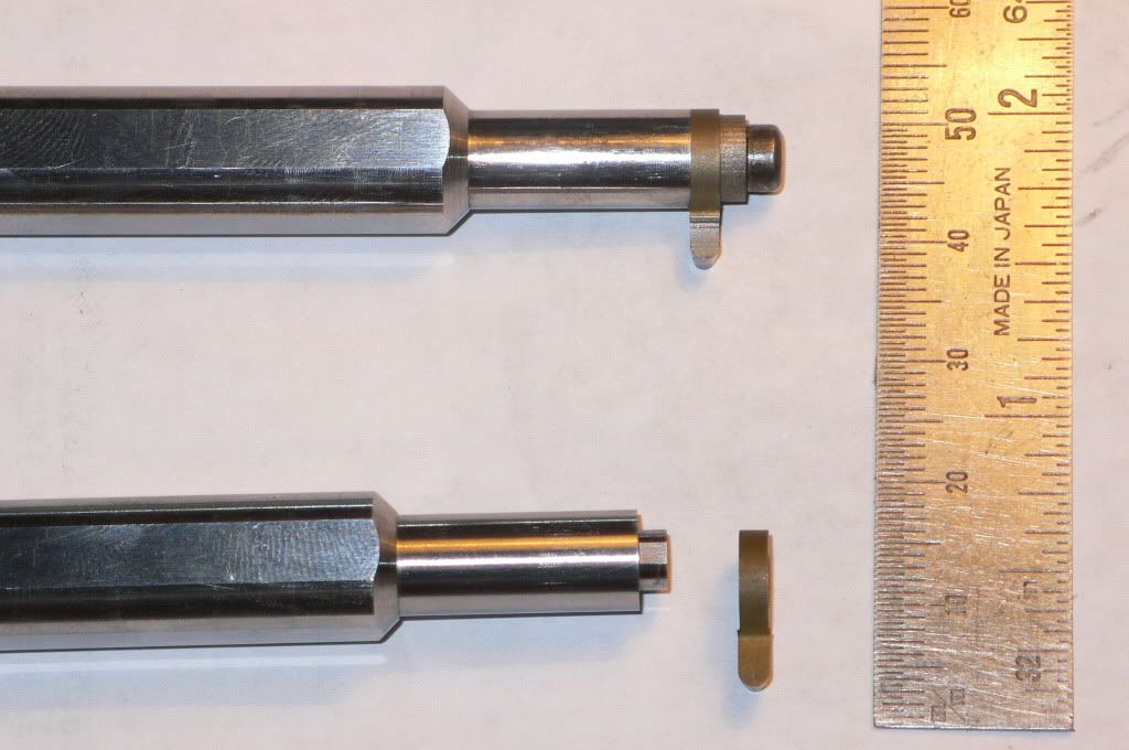

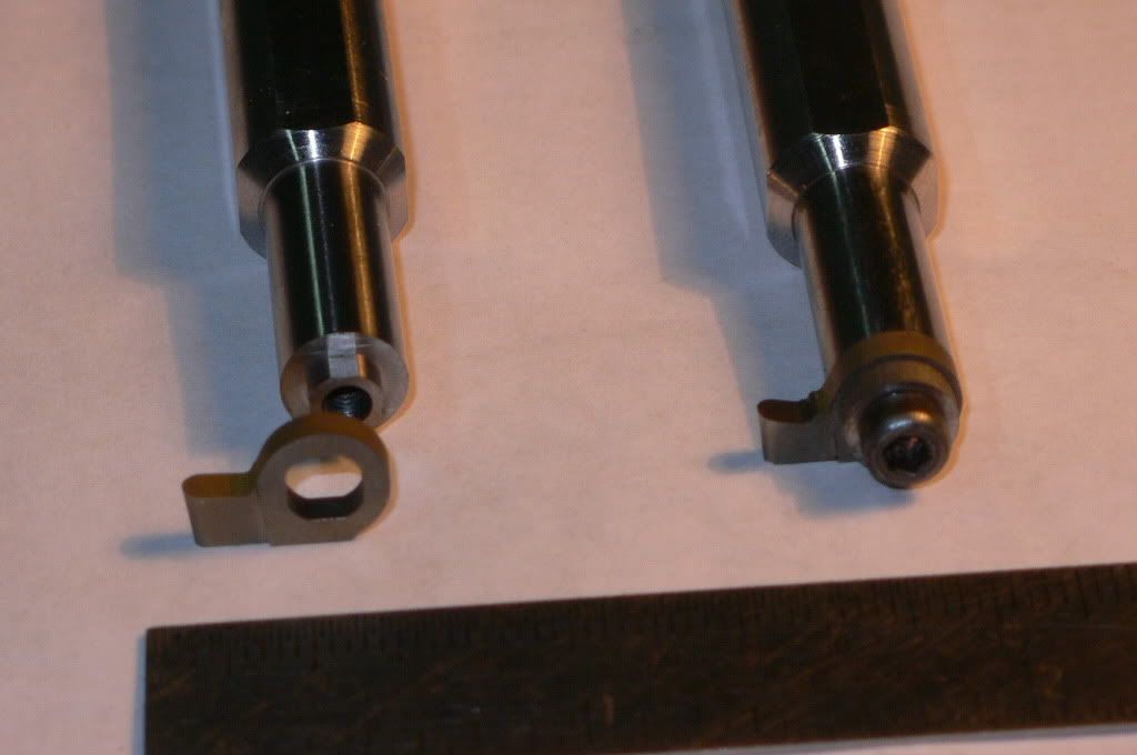

    Update on my lathe project.
    I already made tool holder for internal turning. Min diameter is 14mm.
    The reason I made it, because tool in the market not suitable for me.

    wow, home made tools?
    how did you make those tool bits with square holes? forging or milling?
    and what kind of steel you used? hss?
    btw i am building a turret. will post some pics soon.
    i guess you are from japan isn't it?

    Jasminder,
    Tool bits made from tungsten carbide. First make hole by superdrill and cut the square by wirecut machine.
    For the holder I use hardened steel and finish by grinding.
