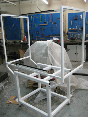

    Its not that i havent been busy in the workshop, my girlfriend just went away to Italy for 3 weeks with my camera. So not so many wip pictures. I almost finished the frame structure for the enclosure.

    Now in stylish white
    From KX3
    And with door sliders installed
    From KX3
    Closed
    From KX3
    And tadaaaa open

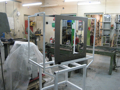

    Got most of sides welded on
    From KX3
    From KX3
    From KX3
    From KX3

    Finally finished the welding. First layer of paint applied
    From KX3

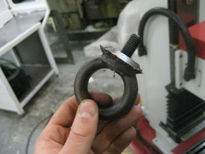

    Today i made the "big lift". It was kind a nerve wrecking since i just used a bolt i found in the sealing :-) First i made eye bolt out of some scrap to fit the KX3
    From KX3
    Wrench attach and ready to go

    The drawbar is almost so simple that its not worth mentioning:-) Its a pneumatic cylinder acting via an arm on the drawbar pushing down the bellevil washers. Just like the most of the other designs around. The total force to release the tool is around 5000N
