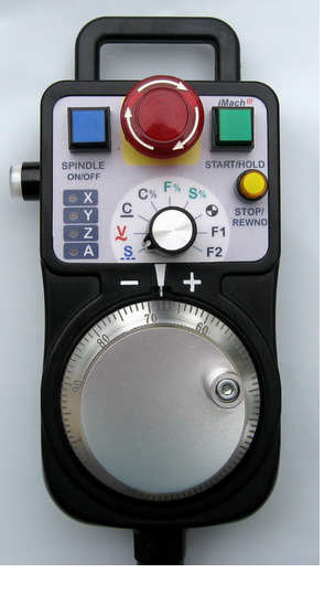

    I have a iMachIII P3 CNC Control Pendant from Vistacnc. After the first couple of months I grew to like it very much. You have three jog rates at the flip of a switch.
    The three selectable rates of movement are:
    1 - equivalent to G00 when you turn the dial above a certain speed
    2 - proportional to the rate you turn the dial
    3 - an individual step when you turn the dial a certain number of degrees
    This makes manual moving from one end of the table to an exact point on a part very easy. There are also a whole array of programmable features via the user software.
    If I were to buy now I would look for one that had a digital display, at least capable of showing the current DRO reading for the selected axis. Any readout feature on the pendant that eliminates a need to look at the screen is very useful, What read-out features a person would find most useful would depend on how they intend to use it.
    The thing I disliked very much with the Jog-shuttle was that it is all to easy to press one of the axis select buttons by accident and then you jog the wrong axis, sometimes with disastorous results.
    Phil

    Here is a view of the front panel of the pendant.
    Phil
