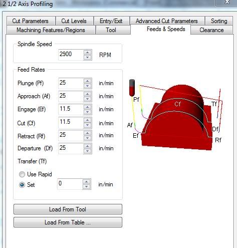

    I am experiencing something weird in RC that I've never encountered before. The code that is being produced always has an F1.0 placed at the beginning and the end of a MOP no matter what my programmed speeds are. This is quite frustrating having to go through and find them and delete or change them. I can't find anywhere where it would be commanded to put this in there. Has anyone seen this before?
    Here is an example of the code:

    Here is an image of the Speeds and Feeds tab:

    Nevermind I figured it out. Somehow the Tf was changed to set and I guess the default speed when no speed is specified is F1.0. I changed it back to rapid and all is good.

    Im new to RC myself. But here is my thought anyway, isnt because you have set the Trasfer (Tf) to 0 ? have you tried "use rapid" option?
