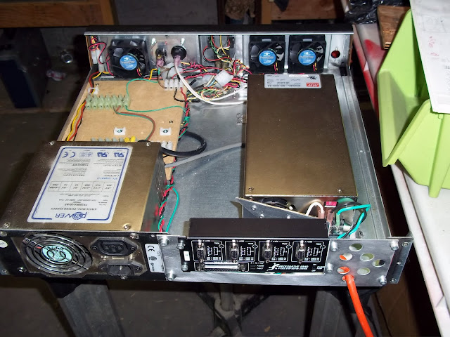

    - Old 2U rack mount server case gutted and converted to hold 48v PSU, G540 and other bits. Existing 12v server PSU kept to power case fans. Old 60mm case fans were on last legs and replaced with (3) new temp sensing fans. Hacked together some sheet aluminum to hold switches and G540.
    I'm quite happy everything fit so well in the server case. I have had this server collecting dust for over 5 years. Yay for being a pack-rat!! =)

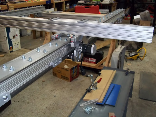

    Gantry mock up
    Gantry setup is going pretty well. Considering I'm doing most of the design in my head I've impressed myself thus far. But still I'm just waiting to find a major flaw. =)
    Looks like I'm going to need to place another order for 8 hole gussets and t-slot bolts. Oh well I might as over do the bracing if I can. Looks like it will take 16 gussets to attach the gantry + uprights + bearing block "chunks". Just a few short of gussets but even more short of bolts. Since I've used the 8020 bolt kits on all the gussets thus far, I will continue to use them vs some 5/16" bolts from Home Depot. So much for glamor.
    I'm starting to wonder if my gantry is a bit tall. Also the bearing support blocks are pushed in quite a bit, eliminating some clearance on the outside edge near the rails. But considering I only plan to use the full 4' width for plywood / foam sheets that are less than 2" thick, I think I will be fine with this configuration for now.
    Suggestions and experiences welcomed.

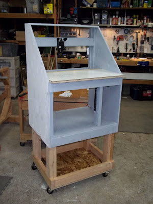

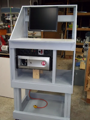

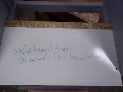

    Robot console update
    Here's another Easter weekend project I've been working on: Command and Control console for the 'bot.
    Since I went the route of packaging the bulk of my electronics in old rack mount server chassis I needed a place to mount them. Since I needed to build a rack for the cases I combined the need for a workstation all into one. Yes I know it's not pretty but most of my projects seem to have that problem =)
    Below are some pics of the assembly. It looks pretty short right now but the next step is to build a base with some casters I found in my parts bin. I figure I need to raise it up 8-12". Maybe I'll work in a storage drawer into the base as well. Who doesn't love more storage?!
    Either way, it's a work in progress. I tried to plan for future upgrades.
    Stay tuned for more!! :cheers:
    Attached Thumbnails Attached Thumbnails 100_0062.JPG   100_0080.JPG   100_0084.JPG   100_0087.JPG

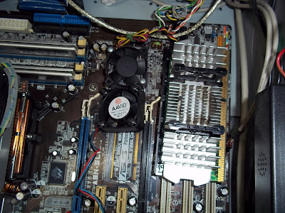

    Console: It's nothing fancy and built with what was cheap (found) and plentiful. It's almost done. Last bit will be a cable carrier between the 'bot and console and a power strip or 2 mounted on the back.
    Chipset fan replacement. Yet another freebie. Found a better one on the old P3 chip (on right)
    And my old workstation guts successfully transplanted. Had to get out the welder to hack the case to hold 3 hard drives as I didn't want to loose or transfer 500+GB of files. It worked out great after much deliberation on the best place to stick the drives, in a serviceable spot that didn't restrict cooling.
    Console assembly.
    Looking good I would say. Just need to slap a bit more Gripper Grey paint on.

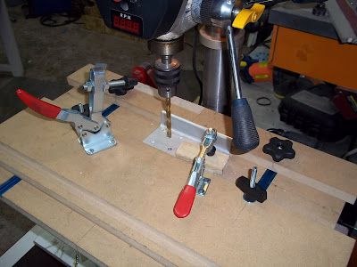

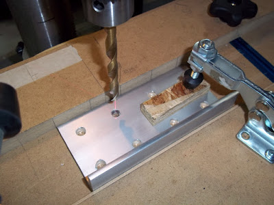

    DIY 8020 brackets
    So I decided to try being a frugal DIY'er and roll my own 8020 brackets. To secure some 1515 stock to the bottom of the X axis (3030), I needed some 3030 to 1515 90deg brackets. Purchasing pre-drilled brackets was going to add up fast. So I figured I would see if my drill press was worth it's space and ordered 48" of some 3"x1.5"x.25" 'Angle' stock P/N 8231. For less than $20 I could drill out a number of sturdy brackets.
    Well at this point I'm glad I went DIY and glad I took the time to build a modular / t-slot base for my drill press.
    I just formed a slot for the angle stock, chopped off 6" worth and used a pre-rolled bracket to make measure marks. After running one piece through [12x 21/64" holes] I checked it against a piece of 3030 and was happy to see it mated up perfectly.
    Pictures tell it best:
    Taking the time to set up a jig with cam-clamps really made this such an easy job. Hopefully they will bolt on as planned. Eye-ball estimates indicate the jig and holes are spot on.
    Average time to process one 6" chunk: ~10min This includes fussing around with the shop vac and cleaning out the work space.
