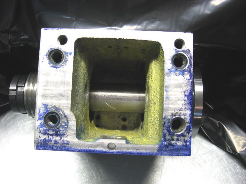

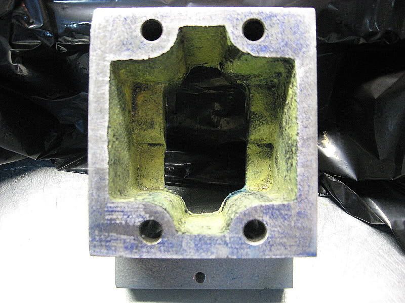

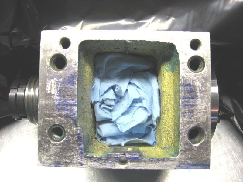

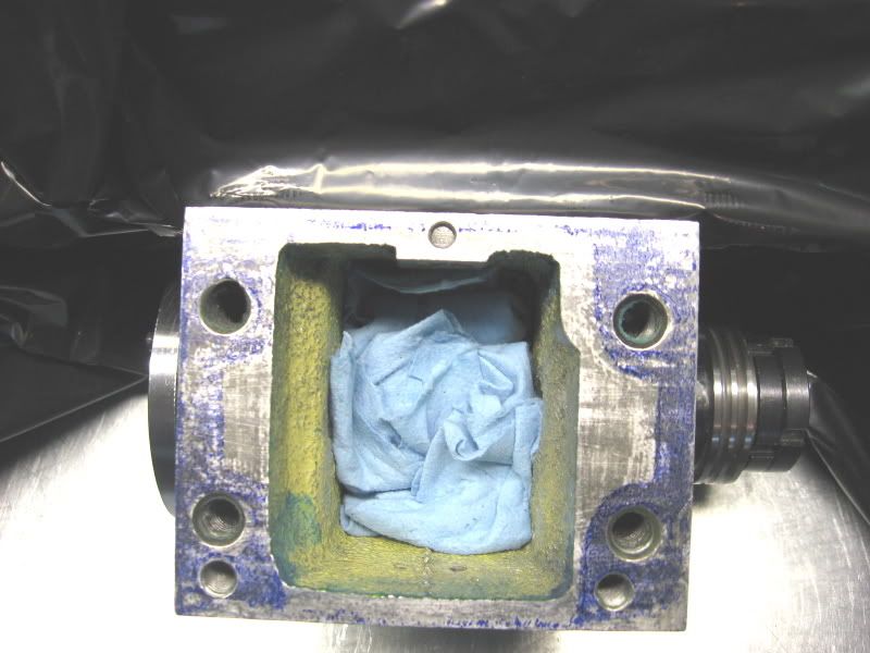

  15. #35
    Join Date
    Mar 2006
    Posts
    357
    Well John, I tried your method today. Works excellent.
    Very very fast once you get the hang of it. Very light touch as you say. There is no muscle work whatsoever using a grinder.
    I held the dremel with a very very light feel. I pretty much just held at it's center point in my hand so it would remain level. Then just lightly touched down to the hi spots with no hand pressure at all once the parts were getting close.
    It is quite different than hand scraping that is for sure and I can see where somebody with a shaky hand could get into trouble fast. But I found it very easy after an hour or so of practicing.
    These are not bearing surfaces so they just needed to be nice and flat.
    I'll post 4 pics and explain them.
    Pic1 is the top of the headstock riser block that the head stock mates to, which I had made flat to the surface plate.
    Pic2 is a before shot of the headstock that sits atop the headstock riser- So the head stock would be made flat using the head stock riser block top surface as the reference.
    Pic 3 is the head stock surface after using the dremel for about an hour referencing it to the headstock riser surface.
    Pic4 was a final test and it is very interesting to note. This is the surface of the head stock AFTER being made flat to it's reference surface the head stock riser. I placed the head stock on the surface plate this time and note the pattern is now reversed. The high spots are exactly where the areas were never touched with the dremel.
    Very very effective method using a dremel IMHO if you can handle the very light touch that is needed to make it work.
    Steve

    John, I used those tiny little abrasive bands on the rubber bobbin. I also removed the small outboard steel washer on the rubber bobbin and this gives a little smoother action.120 grit works pretty good for fast removal.
    I did my rail risers today on the lathe bed. All I can say is this method will very quickly get you a nice flat surface. One thing though, sure is messy!

  19. #39
    Join Date
    Mar 2006
    Posts
    357
    Ian,
    You probably can't control the rotary tool with as much precision as a skilled hand scraper and it is certainly limited in use for surface type( dovetails would be very difficult to use it on) but for a hobby level work you can still beat the heck out of the machined finish done with one of our hobby mills. I'll estimate flatness to well under .0003" no problem and done very quickly. You can dust off a very small amount of material with the right touch.
    In my case I am only flattening clamping surfaces not a bearing surface.
    The surface is very good now.
    I'll have to get a .0001 indicator and test out just how much control I can get in material removal with the rotary tool.
    In my pics I deliberately used a heavy coat of hi spot blue just for the pics. In reality my flats show only small speckles that are very difficult to see.
    Steve
