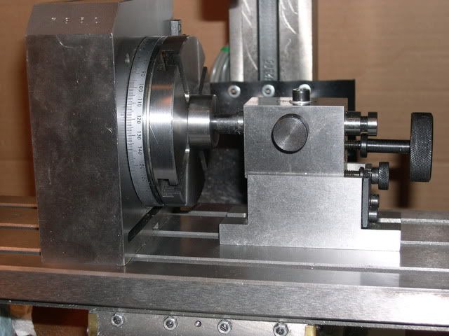

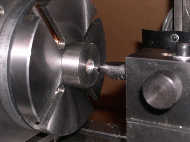

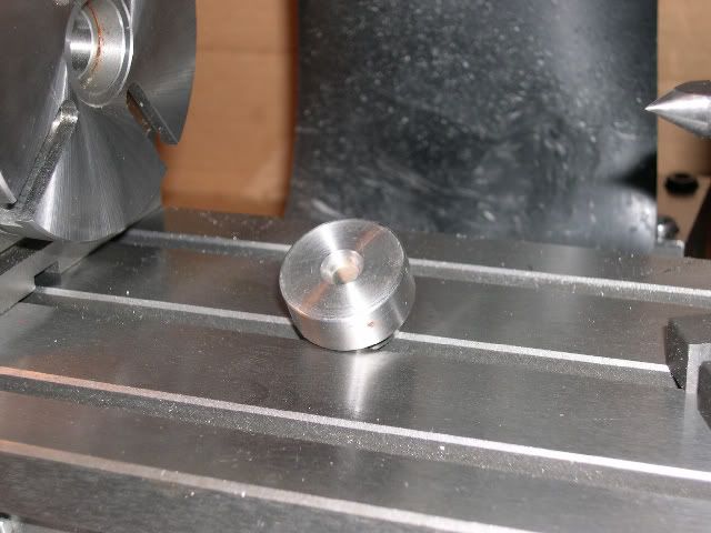

    Here's what I did. I turned a plug, 60 degree center drilled in the face to fit the table. The tailstock should have a 60 degree point.
    Adjust the height of the tailstock to fir the rotary table plug.
    This works for me, hope it helps. Tex

    Yes, I was referring to how to ensure alignment of the tailstock no matter what location/distance it is from the face of the rotary table. Using the cleat on the front should "relatively" alleviate the issue as Pete says.
    @ Tex,
    I like the idea of making the plug for a quick setup near the face. That should be easy enough to do. I really don't want to take it to the RDM state of aligning the stock, but I'd like it as close to correct as is reasonable for this machine. Since it looks like you're using the mill bed to rest the tailstock directly on, when you move it away from the face, how do you make sure it's still aligned to the X-axis? Do you have a square bar that sits down in the ways that keeps it in alignment? I would think that a round bar might be better or maybe not. I hate to trouble you but could you post a pic of the bottom of the toolpost if that's what you're doing?
    Thanks for all the pictures and explanations.
    You guys are great!
    Vogavt

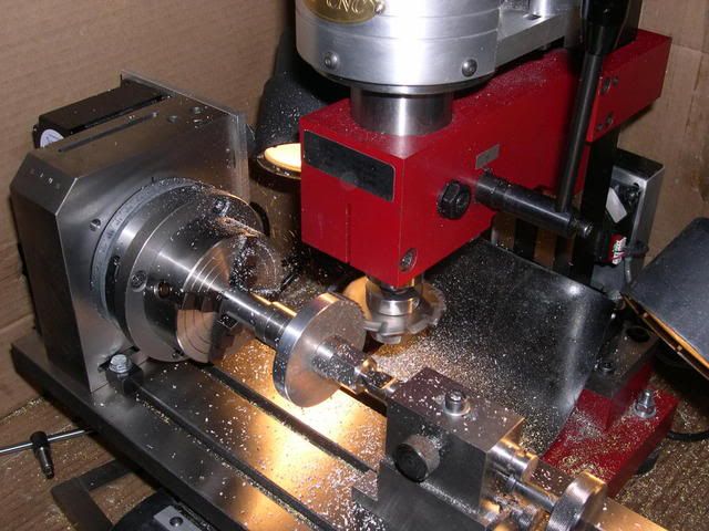

    Hey Vogavt, The Rotary Table and Tailstock are from The LIttle Machine Shop and I was told they were made by Sieg. They both came with aligning pins or in this case squares but they were made for the X-2 (10 mm table slots?) and the X-1 has 8 mm table slots so I removed them. I found that on the Rotary Table a machinist square worked well for mounting it on the table and I just slid the tailstock up to the mandrel and mounted it.
    Here's photos of the X-1 cutting the teeth on a 42 tooth gear for a South Bend 9" Lathe:
    I had planed to install some aligning pins but all seems to be working well so I haven't gotten around to it. Tex
