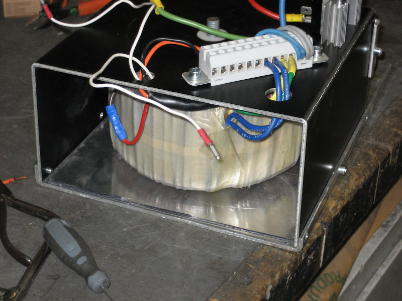

    I need a little help here. Im confused. Today i fired up the transformer and did some mesuring. This is what i got when i mesured the AC between earthing here in the workshop and the PSU. When i turn of the power i get a reading of 3-4V~.
    From CNC
    I actually added a insulating piece of acrylic between the transformer and the alu plate
    From CNC
    I mesured and there is absolutly no contact between either the primary or the secondary circuit and the alu plate. I dont understand how the transformer can generate this amount of voltage without contact? Also the reading is suspicious close to the reading of the two secondary circuit?

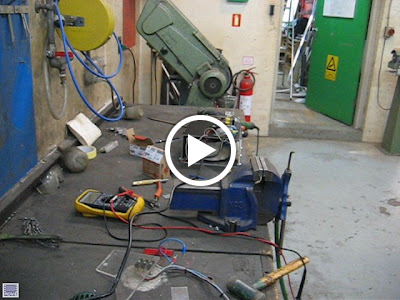

    Hmm, problem identified. After moving the center bolt the voltage dropped to 9V~. Apperently a circuit wasnt necessary to create a whole lot of voltage, glad i tested it :-s I hate! messing with high current.
    I still get a increase in the voltage in 5-6V~. Is this acceptable? I plan to earth the whole machine with 6mm2 wire from each vital part

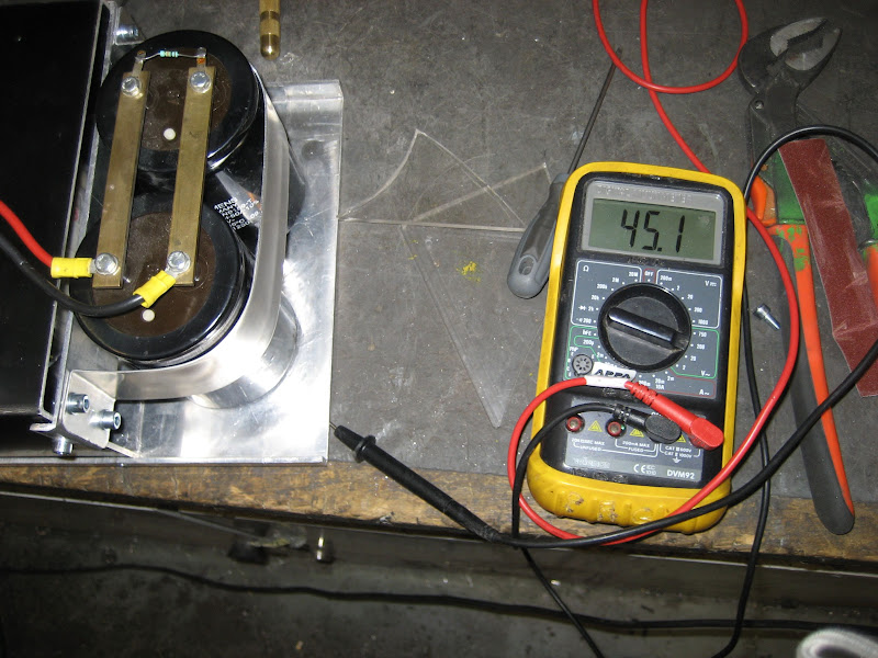

    Damn, problem still not solved. Dont know why, but it now shows a 110V~ difference between earth and the alu plate. I can earth the problem away, but im not quite satisfied with it. Is this normal when working with large transformers?

    It is quite normal to find any piece of unearthed chassis floating up to apparently high voltages (that's why they should be earthed); the result of capacitance coupling, leakage etc. Check with the AC current range on the multimeter, there should be only uA (micro-amps) of current flowing back to a proper earth.

    Using a digital volt meter near the transformer will give you all sorts of weird readings!!!!
    The reason typical 10Mohm input 'digital' meters apparently 'pick-up' odd readings is because they are better voltage meters than a typical 1kohm or 20k ohm/volt 'analogue' meter.
    i.e. there really are odd 'voltages' floating around transformers (actually there is a conciderable magnetic field that will induce currents, hence 'voltages' in any conductor near the transformer)
    In fact, both type of meter are actually measuring the current flowing through a known resistance i.e. they both require a small flow of current to 'see' anything. They both require a tiny amount of power from the source in order to report the voltage. A true 'voltmeter' would not require any current (hence power) at all.
    [even though the 'digital' meter has a battery to run its electronics, it still requires a tiny amount of power from the source]
    If you are not aware of this then 'digital' meters can cause confusion (BTDT ) so, I agree with John sometimes an insensitve 'analogue' meter can be better
    BTW if you probe and orange with a 'digital' meter you will get a reasonably accurate reading of the voltage generated by the chemical reactions between the acid in the orange and the metal of the probe. Do the same with with an insensitive 'analogue' meter and the reading will be less. Why? because althought the 'orange' does generate a small voltage the Power available is too small to drive the insensitive meter properly.

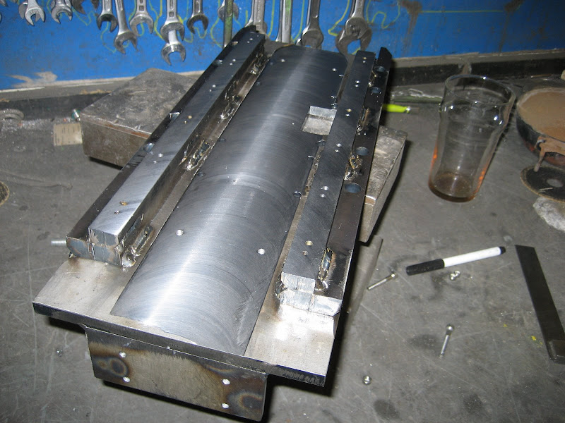

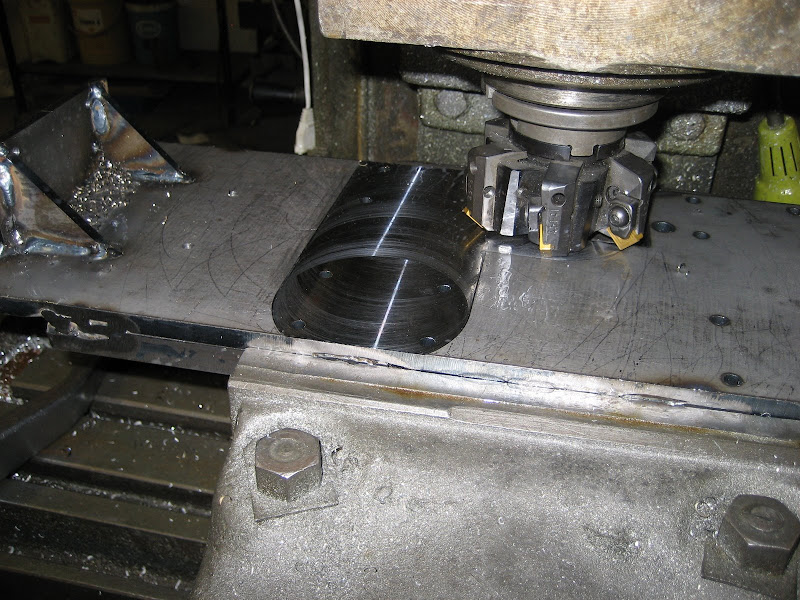

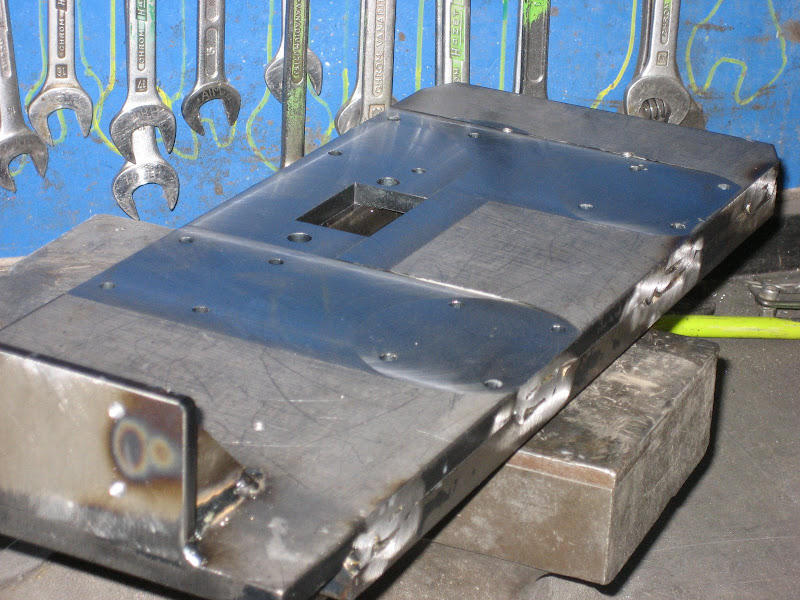

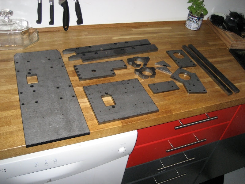

    Finally some real progress. Its good to get to work with some metal after all that wiring.
    The parts for the carriage as they arrived from the laserman as he named himself
    From CNC
    Now off to the workshop...
    Parts prepared and tacked together
    From CNC

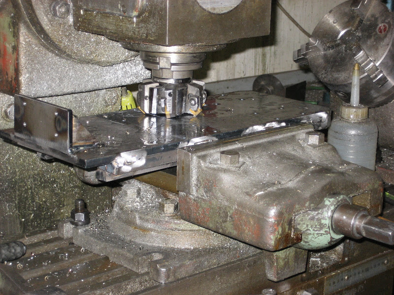

    I pulled out the big vise and milled it flat on both sides. Here are some in progress picture
    From CNC
    From CNC
    And the final result
    From CNC
    From CNC

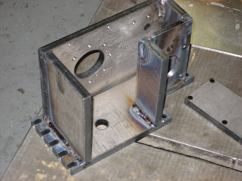

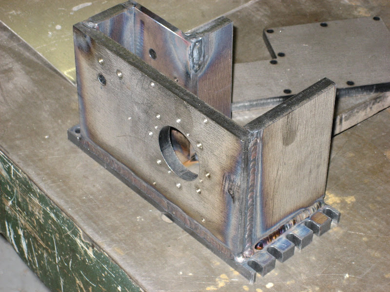

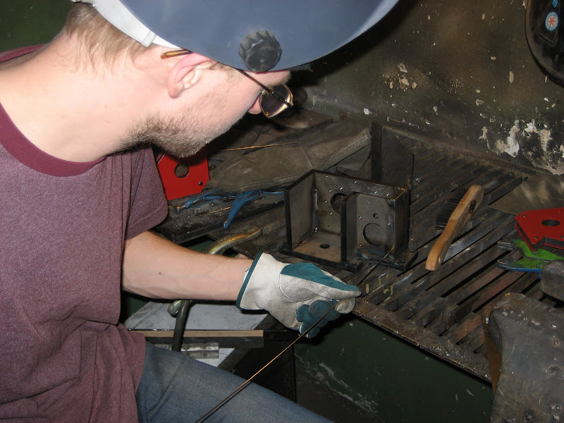

    With the parts came also the bottom for the turret, so a friend of mine TIG'ed together for me, look at those beautiful welds, sure looks better than MIG/MAG welding
    From CNC
    From CNC
    From CNC

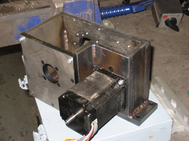

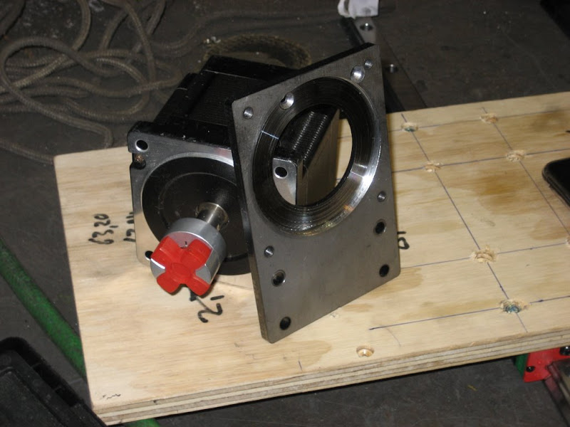

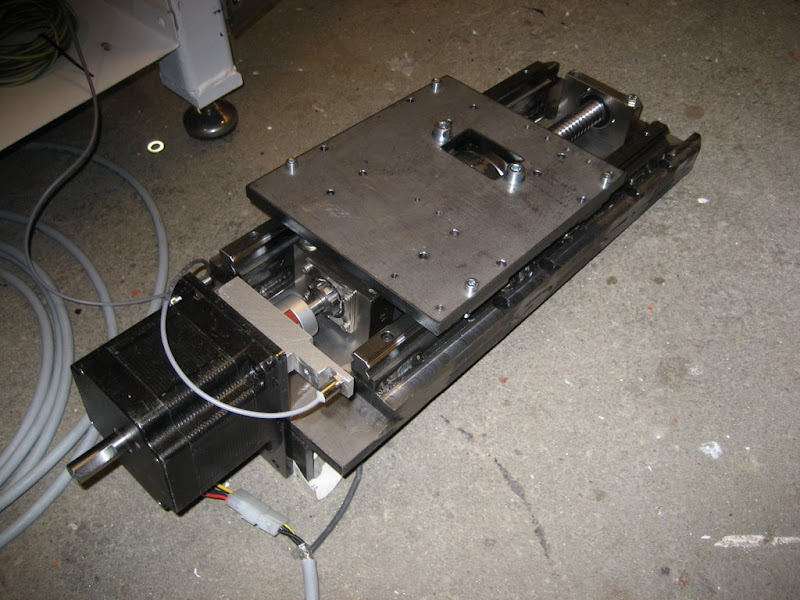

    Spend the last two days in the workshop, made quite a progress despite some hangovers:-)

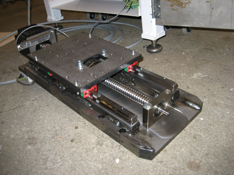

    Turned the bracket for the x axis motor
    From CNC

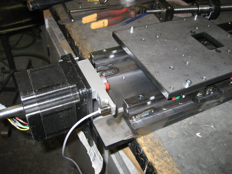

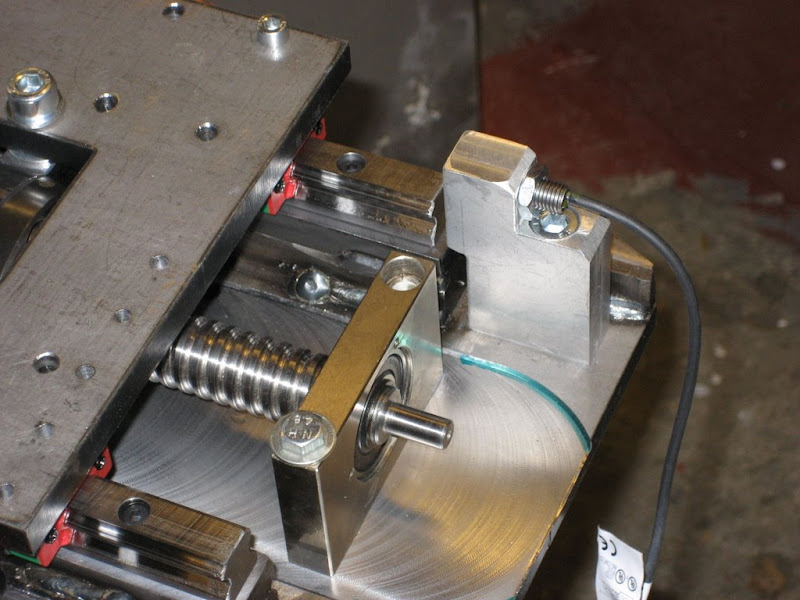

    Mounted the motor and rails. Also made a bracket for the limit and homing switches. Limits are proximity switches and homing is a precision switch with 0.01mm repeatability accuracy. The bracket also work as a hard stop to prevent the carriages from being damaged
    From CNC
    Ballscrew mounted and aligned
    From CNC
    From CNC
    Not that exciting, but here is a video of the axis running back and forth at 5 m/min
    Lastly I also milled the edges of the turret and drilled and taped the holes for the back plate
    From CNC

    Both limits are now installed. I adjusted the speed to 2500mm/m which means that even at full speed the slider stops before it hits the dead stop when tripping the limits.
    I have a question though, how do you connect proximity switches in series, so i dont have to use a pin per switch. Do i simply connect signal of one of them to ground on the other?
    From CNC

    What sort of proximity switch? (i.e. part number etc.) I'll look it up for you.
    Bill
  16. #216
    Join Date
    Apr 2005
    Posts
    1778
    Quote Originally Posted by Guldberg View Post
    I have been mulling over a similar question for sometime. I was thinking about using a quad 2 input AND gate. Feed the outputs of the switches to a pair of gate inputs. As long as both inputs were high, the output would be high but if either switch output (gate input) went low, the gate output would go low. Wire the gate output to your parallel port input pin. (This of course assumes that your switches trigger low). If they are normally low and trigger high then you could do the same but with an OR gate.
    Alan
  17. #217
    Join Date
    Aug 2006
    Posts
    1602
    Wow, this really is a fantastic build!
    I would have thought that you would need some kind of logic in there to combine the signals - the proximitiy sensors that I've seen need power & ground to run their own internal logic, and provide a logic-level ouput to show whether they're triggered or not.
    You can build simple gates with a couple of discrete components (diodes, resistors and transistors) if you don't have any suitable low-voltage supplies to run an IC.
    One thing that does worry me though - you seem to have a delicate proximity sensor in harms way if the carriage overshoots. Can't you sense the edge of the table sideways, so that it'll just glide past the sensor if it overruns?

    As for the proximity sensor. No worry, its sitting out of harms way, just behind the dead stop

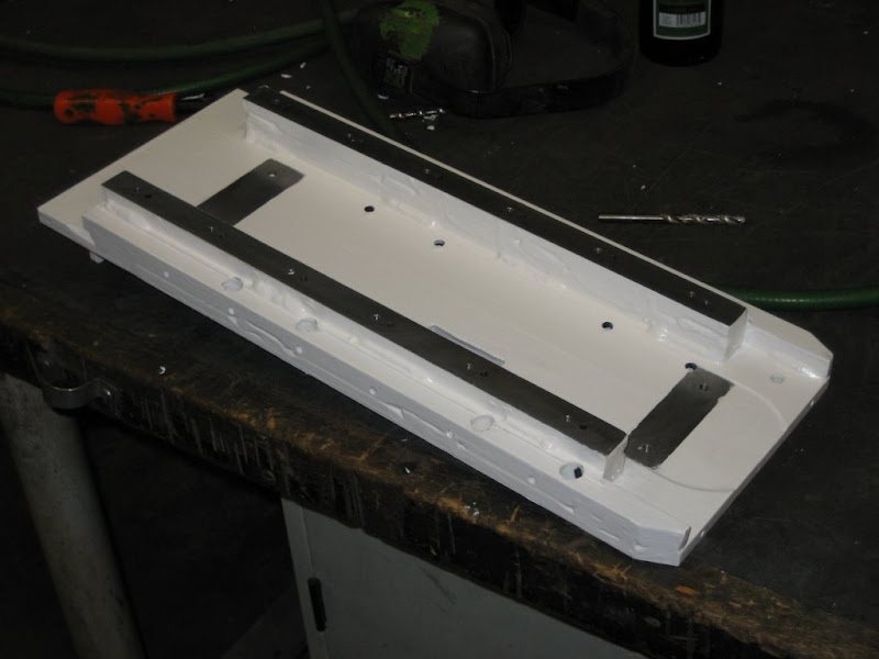

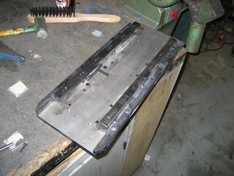

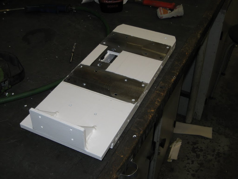

    Disassembled the carriage and painted it white. Came out just fine. It merely for protection, none of this is going to be visible when its finished.
    From CNC
    From CNC
    I remounted the rails and aligned them. It was a lot easier than i excepted, got it down to a variation of +- 0.01mm along the length of the rail.
